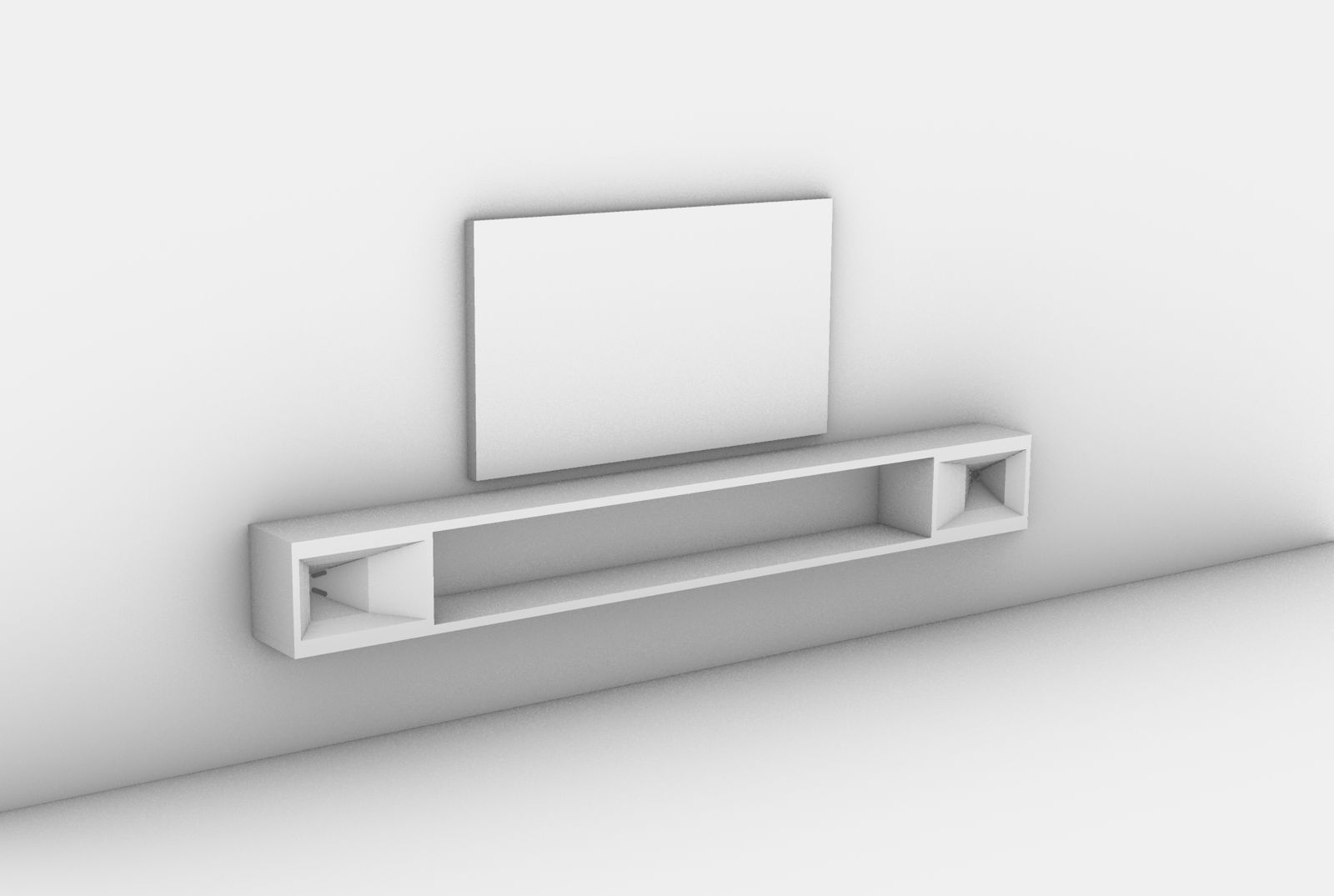

This morning I got an idea on how to smuggle a MEH based stereo system into my living room - build them into a console style cabinet to serve as a TV stand. The picture is a random one from internet - it would have to be a bit more modern looking, but I hope you get the idea.
2 x Fane Sovereign 8-225 + 1" driver in my SPL Runt clones should work well in this.
The placement would not be ideal, but ot should work. I need to try this arrangement with the separate boxes one day to find out if it is worth the effort🙂

Yes! I was also thinking to have something more modern, but the examples are not really numerous.
Do I see correctly there are asymetric horns? That is also something I considered - but in vertical direction since I thought about floor placement.

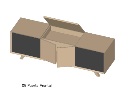

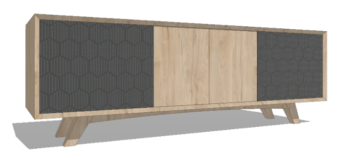

I know the thread has been stale for a few months. But want to chime in. I've designed a console specifically for audio. I'm sharing a render below and will actual photos in the coming days. The speakers are custom design: a 10" 2-way aperiodic (think Dynaco A25 but much more volume) using Seas drivers course. The a25 derivatives may get bi-amped with Hypex Ncore. The piece will contain a streamer / DAC / Fifo / battery PSU from Ian Canada as the primary source. The top compartment will hold a turntable. But that is not yet planned for this project. The aesthetic of this piece is mid-century modern. Some have commented the design has a nordic vibe. In this round, the exterior sections are solid Parota. The interior sections are MDF with Parota veneer. All electronics are hidden from view in an enclosed section of the cabinet. Wifi, bluetooth, ethernet, Roon end point, Airplay2, UPnP. And room for vinyl storage below. The piece is about 6' long. I have other versions planned - smaller size (6' is big), some with DSP, some full analog. What do you think?
