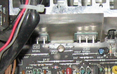

An example is the Technics SU-9600/SE-9600 pre/power from 1974. The power amp sounded very grainy to the point of being annoying. The bias checked OK. It was so bad I used it for DJ work and it got stolen because it had the look and the name. The preamp needed a noisy transistor replacing. The build quality is exemplary. During the repair I discovered it was very microphonic. This was traced to a pot in a bias circuit carrying a few microamps. Not enough wetting current for the wiper. The fix was easy and now sounds great, but how did these top of line models actually make it to production?
It is best not to trust any piece of gear unless you have the engineering provenance i.e. the schematic.
