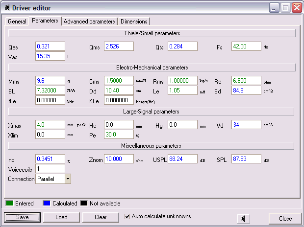

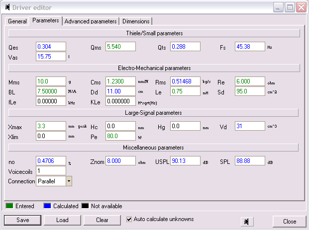

See the attached T/S specs calculated from the electro, mechanical ones for Monacor, Audax:

So the litres, xmax, qts and fs are close. Do you agree it's a good match for the Audax?

That driver looks good, although expensive. Do you not think this speaker has closer thiele parameters however? SPH-135KEP

Very helpful thanks. what is your opinion on the match for the mid-bass arrangement?

This driver you mention (as a mid driver) needs something close to, in this case as a reference or starting point, in a vented enclosure for SPH-135KEP
VB = 6.2 L, FB = 47 Hz
F-3 dB 71 Hz
F-6 dB 54 Hz
2 Ports
int. diam. 3.4 cm (S: 18.16 cm2)
length 35.74 cm
(impedance peak at ~90Hz)
Sealed MONACOR SPH-135KEP, VB = 7.0 L
F-3 dB 120 Hz
F-6 dB ~90 Hz
(impedance peak at ~80Hz)
Check if original was aperiodic or not.
The frequencies will relate to woofer crossover frequencies.
If you are looking at similar woofers (or others?) check the MONACOR SPH-135TC or MONACOR SPH-135/AD for better LF extension (F10=25/30Hz) and 15-20 L br enclosure. The bandpass will give you the best matching with the mids as the originals, I'm guessing here (insert future simulation and woofer driver models/brand for a more accurate project/prototype that can match with what you have).
