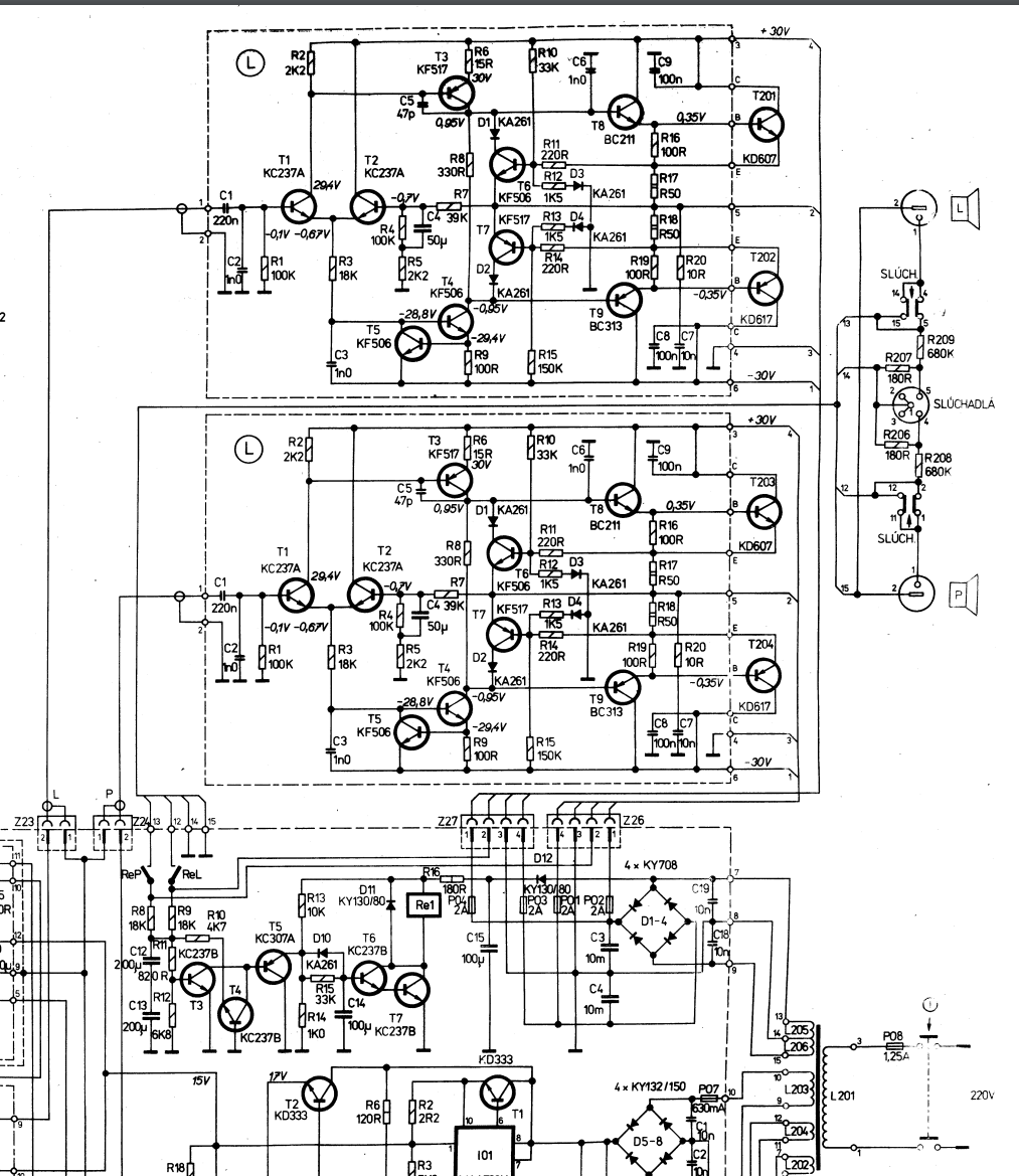

Sorry, it goes to the headphone switch but no zobel network.
The Zobels are R7-C20.
Anyway, I'm scratching my head about those voltages at the power devices' bases, which calculate to just 3.5 mA current through the drivers. The power devices themselves are zero biased, conduction begins at a bit more than 4.3 mA driver current. I also guess a faulty power transistor.

Do both channels behave identically? Some distortion is inevitable with no bias established at T101,T102. There is some class A bias delivered via R16 and R19, but it’s miniscule. Perhaps that’s why signal appears clean on scope until relay closes.
Those two transistors don’t begin to conduct until output current delivered to load rises above about 6mA. As an experiment, you could connect a load from the output to one of the 30V rails to force larger class A bias. If you observe an improvement in crossover distortion, that would buttress the suspicion that inadequate output bias is the culprit. (For example, 1.5k between output and 30V would provide about 20mA class A bias at crossover. Resistor dissipation would be about 0.6W. Make resistor value lower for a more emphathic test.) If confirmed as cause, what to do as remedy would be next challenge.
Other notion is to consider relay distortion; install short across relay contacts as experiment. Use resistor load or sacrificial speaker. I doubt the fix will be that simple.
Anyway, I'd replace both R8's by Vbe multipliers with their transistors thermally connected to the power device heatsink(s) and adjust an idle current of about 20 mA (= 10 mV across either R17 or R18 or 20 mV across both) through the power transistors. I don't see any reason for having omitted them.

That would be as expected with the outputs not properly biased. With the amp not delivering any current, you are actually seeing the output of the drivers, which are biased on. Go ahead and add a 82 ohm resistor in series with R8, making the total resistance 412 ohms. .. or add a forward biased diode (1N4148) in series with R8. Should make a significant improvement. Assuming it helps, we'll work at improving that bias network.
Reactions: minek123
If you want to have any chance at a stable class A bias region, you can't do much worse than the present configuration. A Vbe multiplier is clearly indicated. If you are worried about thermal tracking, set the bias to just barely enter class A. I personally would not just add a diode to the present biasing scheme except possibly to do an experiment.
Well, Mooly, not unexpectedly your sim tells us that the amp should work as is :up:, despite all our objections. Anyway, we're trying to locate the issue's origin, hence have to look in possible design flaws whose results may lead to the symptoms given in the OP if any of the components fail.

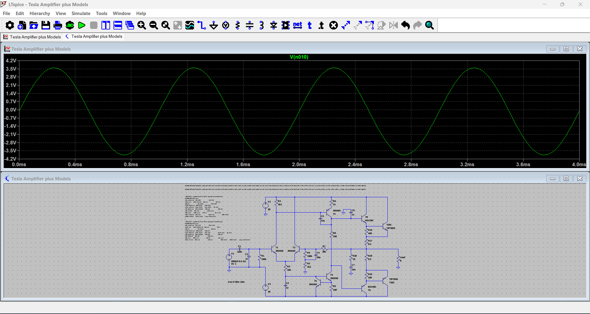

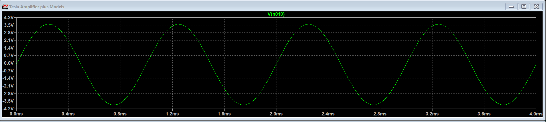

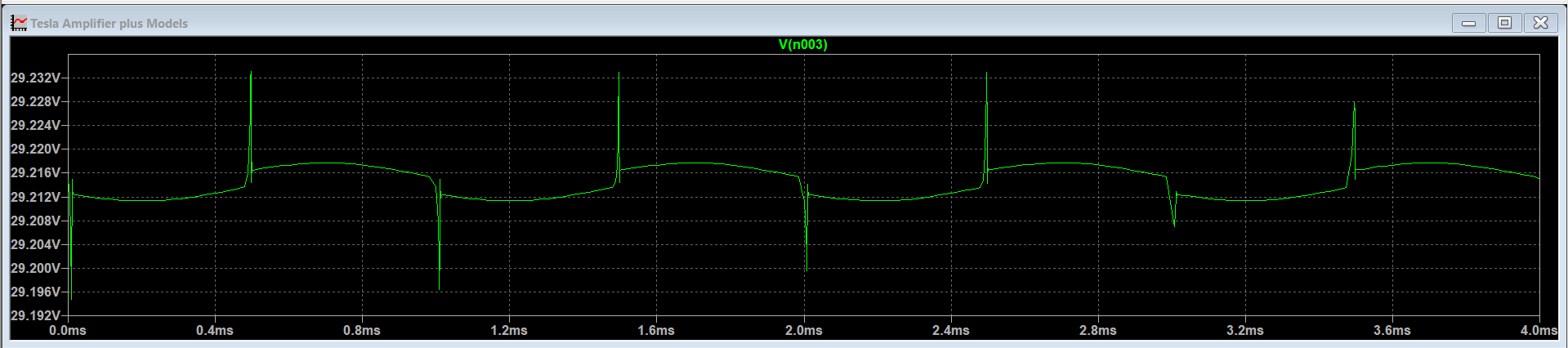

It is worth @Tom Vyborny just looking at the simulation and what we see on the base of T3.
This shows the signal at this point is distorted because of the lack of output stage bias current. The output is still good though:
And the output into 8 ohm.
Now lets link the 330 ohm out and force zero bias.
T3 base:
And the output:
There is the smallest hint of visible crossover distortion now but the amp would still sound 'reasonable'.

Schematic indicates -0.7V on base of of T2, but I am very skeptical that’s correct—- I think it should be near 0V. Would you check? What is DC output voltage before relay?
AC gain should be about 18.7 V/V, output/input. What do you observe? With 1V pp as you mentioned in OP, should be about 18.7V pp at output. Consistent with observation?

Isn't your 1st graph some faint hint (besides the glitches) to what the scope showed us in #1?
Yes, and that is why I posted it. It shows the signal on the base of that stage is not a sine. Also, just as the op says, if you remove the load it becomes a sine... well it does.
