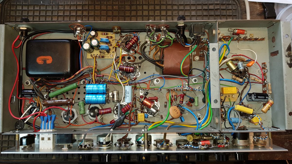

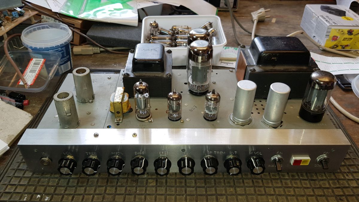

Btw, I'm quite impressed by that wiring accurateness. Mine resembles the pic in #10 rather than Bouyer's, see, for instance, the guitar amp that I built using the chassis and the iron of a Hammond AO-68 from a scrapped cheesy K-100 organ.

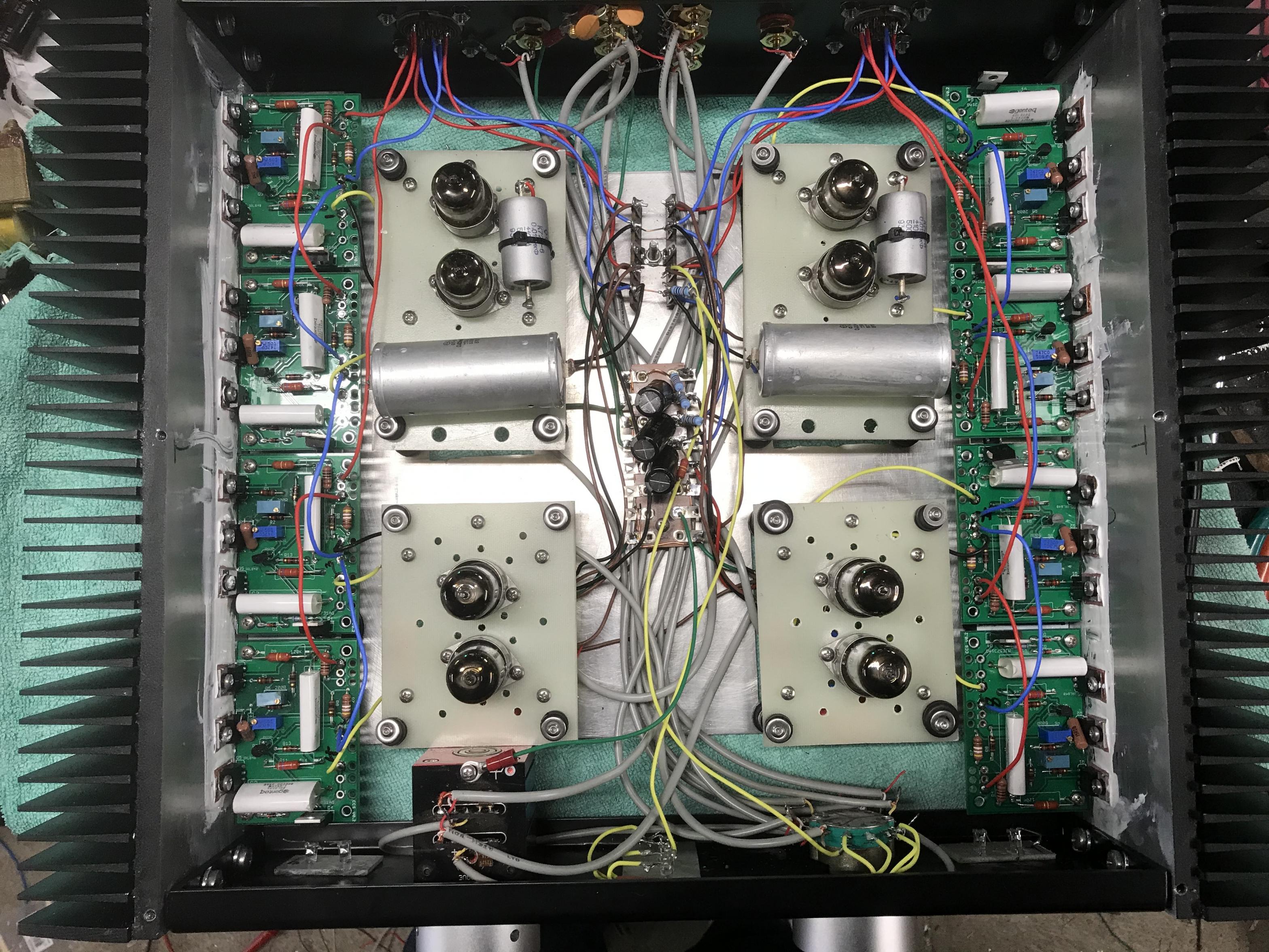

It is especially daft considering the most worthwhile parts are those amazing transformers. I have a couple which were saved from a scrapped chassis which are being built into amplifiers now 🙂

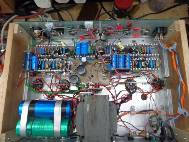

That's looking good handwound, could I suggest you have a go at some traditional lacing, it really tidies up the wiring, looks good and was used on the Tek 500 scopes in question. See - Lace Cord to bundle Wire Harnesses - YouTube & https://mathscinotes.com/wp-content/uploads/2014/01/021c99s2c08.pdfI try with my wiring, this is a pre almost complete.

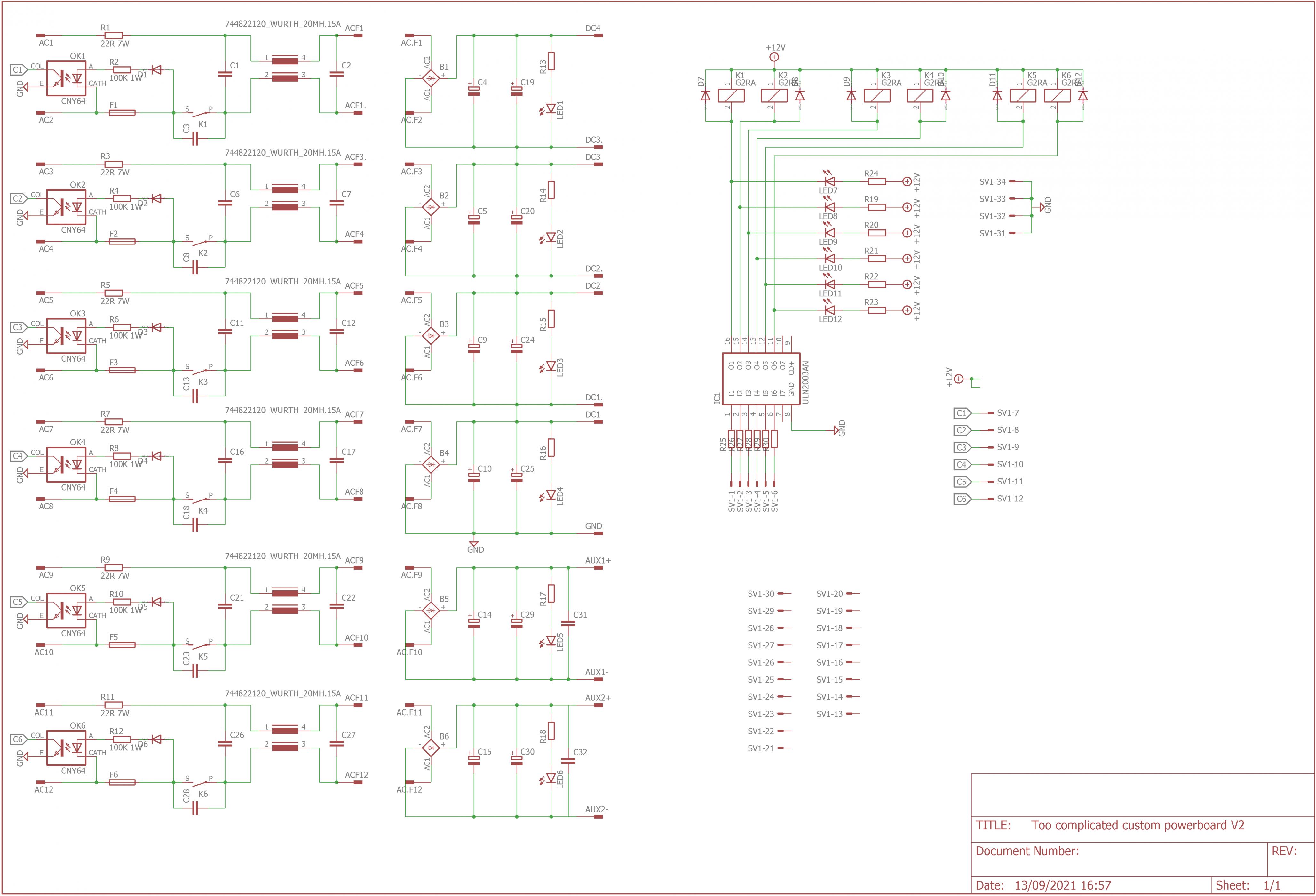

Yes I have a couple of 120-0140-00, I believe they are from the 545? Soon they will power a GM70 amplifier 😀
Yep,the 545A & B I think. One thing occurred to me though,if you connect some of the HV windings in series to get high HT/B+, I think there's a possibility of burning out the windings. AFAIK series connection of windings of different current rating can result in shorted windings, as the wndg with the least I rating bears the brunt. That said the wndgs on theses 120 tfmr's are pretty generous current rating wise,so maybe no worries. I've done it but not with any heavy loadsYes I have a couple of 120-0140-00, I believe they are from the 545?
Thanks for the concern but no worries that has been taken into account!
- The windings I'm going to use to get the high voltage can easily carry that much current
- Every winding is going to receive it's own fuse as an extra precaution
- The windings will be sequentially switched into the powersupply by relays
- Individual rectifiers and cap banks before they get stacked
So also upon being switched on there won't be some insane inrush current due to an empty capacitor bank

With shunted out dropping resistors? Stacking the various power supply's is the way to go rather than series connecting the windings as you say, it's what Tek did after all.The windings will be sequentially switched into the powersupply by relays

No don't worry I mean stacking the supplies like TEK did 😀 and yes there will be a resistor on each winding to limit surges too! I almost forgot about that but it is on the pcb that''s on order
I'd not use dropping resistors, but, depending on the desired output voltage, I'd let the circuitry automatically select the tap of a series connected secondary in order to minimize power loss and heat at the series device.

Not sure if we're talking about the same thing, the dropping resistor I was on about is just after the HT secondary winding, prior to a fuse and bridge rectifier to delay HT/B+ and limit current surge into the reservoir caps. It's switched/shunted out by a time delayed relay, aloows the heaters to warm up a bit too before full HT/B+ is applied to anodes etc.I'd not use dropping resistors

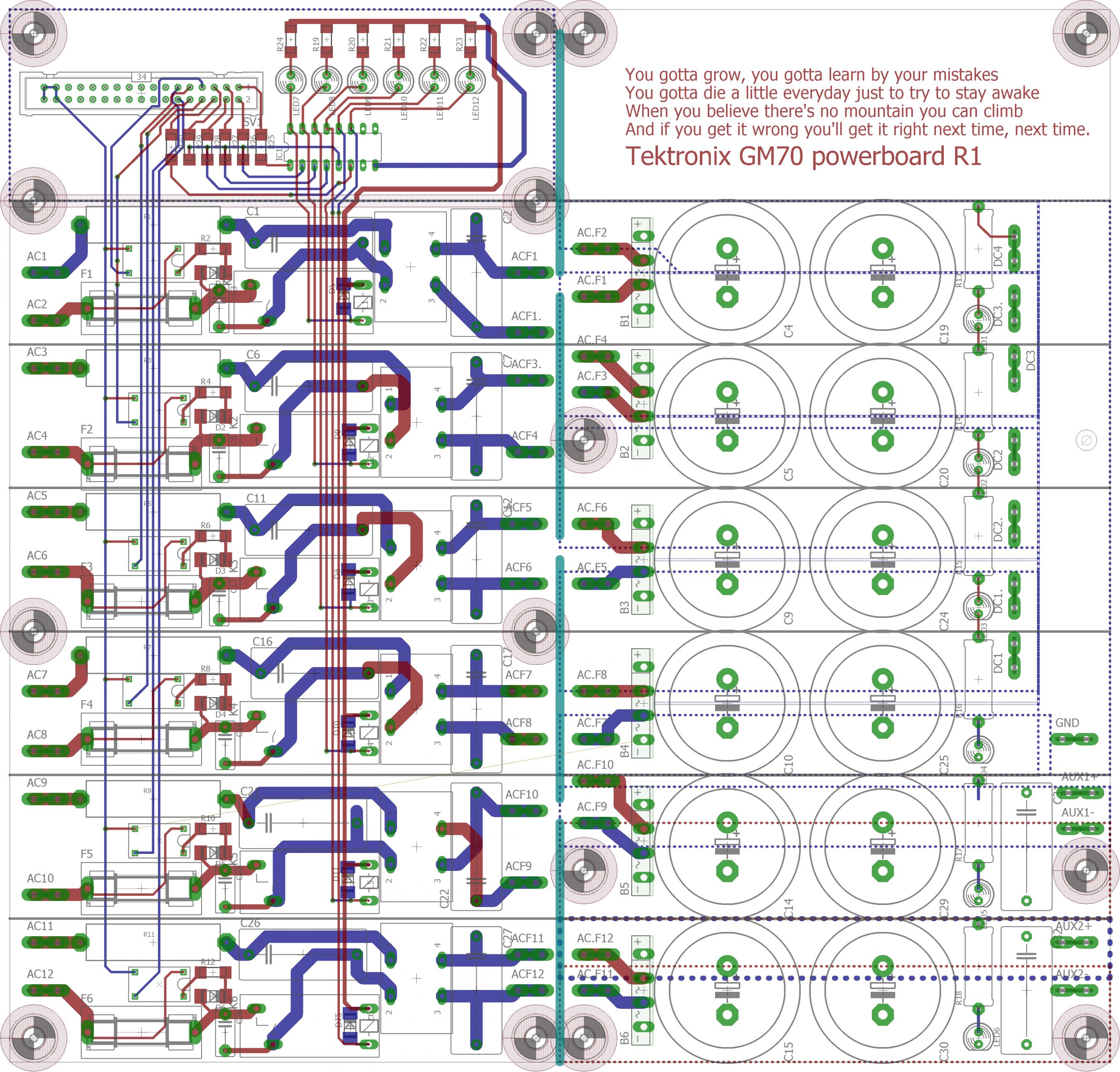

Diabolical Artificer, you can contact V4lve lover (the one from the free gerber thread) since he drew it for me.
FR4 slinger calling in.
Heres the Board i drew for Gideon, still thinking out a power sequencer, i cant be asked to get the arduino out, so HEF4xxx it is.
Ive put some CNY64 over the fuses, so you have the option of detecting blown fuses .
