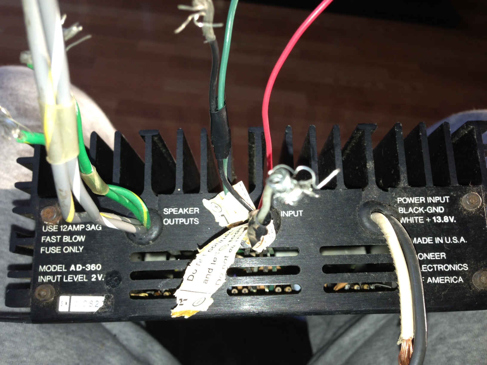

hi,
i have one of these vintage amps and i am not sure of how to wire it correctly,
it has the speaker outputs which is straight forward, power inputs which is also straight forward but with the input cables for the speakers there is also a skinny red wire which i dont know where it is supposed to connect to?
can you help me on this please ?
your help would be most appreciated.
pics of amp wiring
hi all,
thanks for the replys, just dug the amp out again and have attached a photo of the wiring.
this must be a very rare vintage amp as i cant find out any info about it online.
it was made in usa not japan like newer pioneer car audio.
any help as to where the skinny red wire coming out of the input side goes would be great.
thanks.

Red wire should be a turn on wire. Get a 1K resistor, and connect it with the red wire and other side to 12v, and amp should turn on. (going from old memory - it may need to be grounded, which is why recommend using a resistor for testing. - unit was designed to be turned on by head unit)
