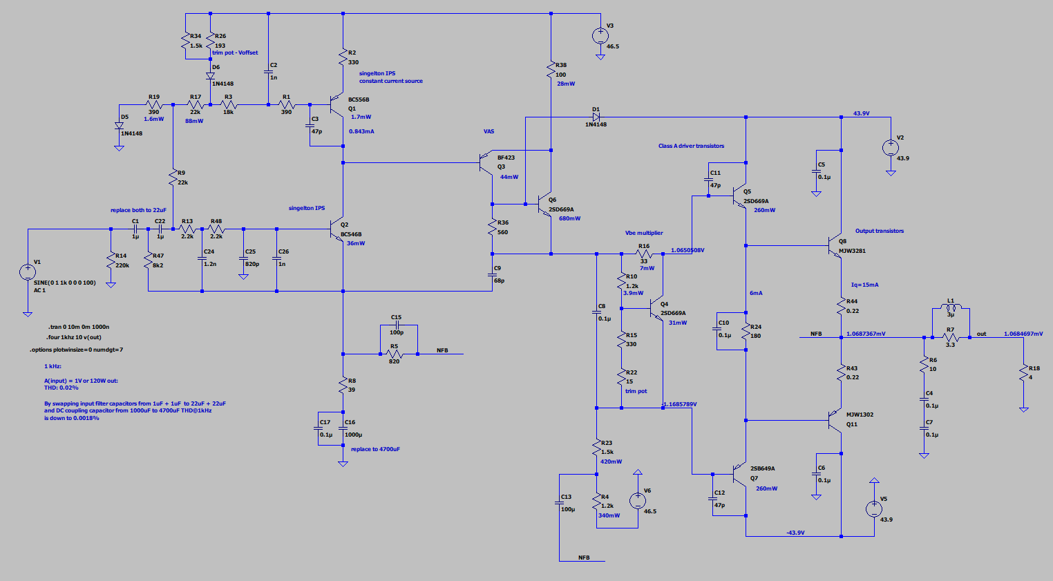

Driven by curiosity and a passion for electronics, I took my exploration a step further by simulating the NAD 2150's circuit layout using LTSpice, a circuit simulation software. This exercise not only deepened my understanding of amplifier design but also allowed me to visualize how different components contribute to its overall performance. Sketching the circuit in LTSpice was both educational and enjoyable, providing insights into the amplifier's behavior under various conditions.
For those brave enough to open the amp and solder a few capacitors a significant improvement can be made by swapping input filter capacitors to 22uF + 22uF and DC coupling capacitor to 4700uF resulting in 0.002% THD@1kHz.

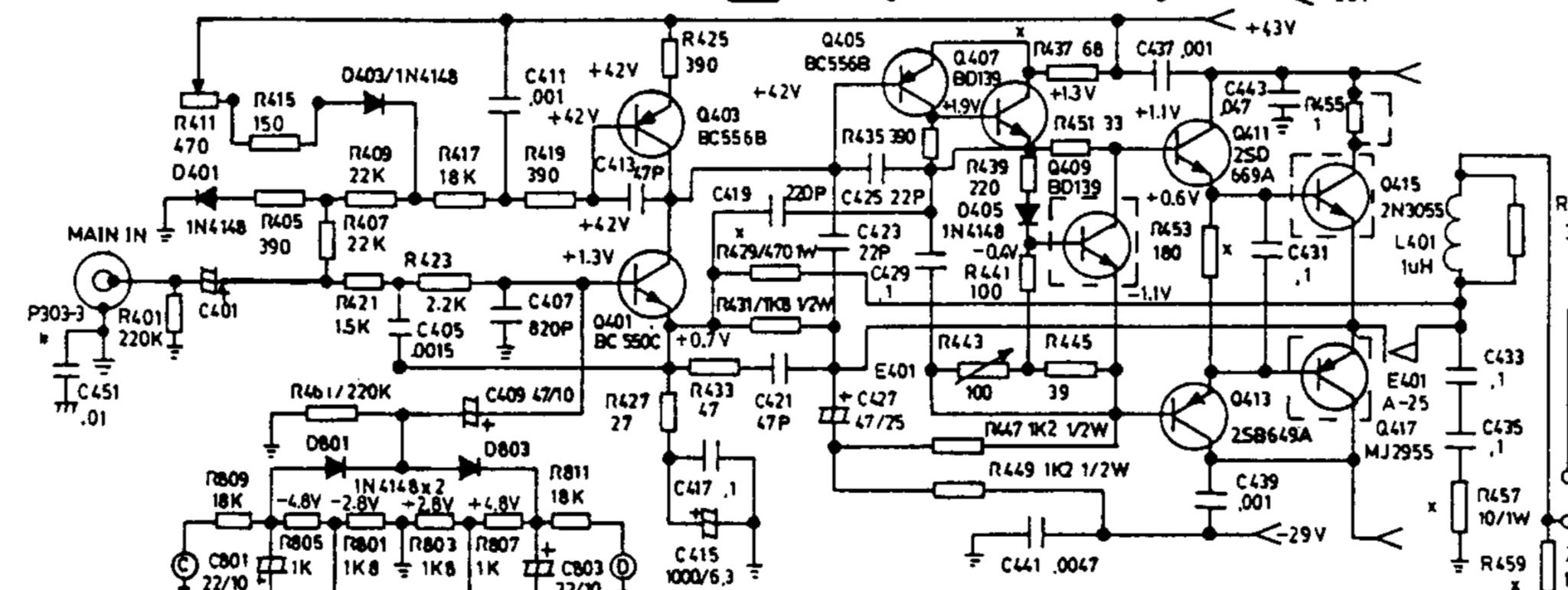

These circuits imply real sound degraders and preventers! I have just now carried out a quick practical test: I removed these and listened. But more on that later. My conclusion: These circuits and devices were not designed and built by developers with audio experience!
Are you talking about removing preamp section from the signal path?
Those schematics are classic three stages topologies simplified as much as it can be to remove unnecessary active devices from the signal path.
There is a theory out there that best sounding amplifier is the one with Open Loop Gain higher than 60dB at 20kHz. Meaning all frequencies below will have 60+ OLG. I tend to believe it since high OLG means good linearity region for given transistors. First watt as it is called sometimes. Except the difference is in one case negative feedback applied and in another it is not.
I am referring to the power amp. This also has a completely sufficient voltage amplification, "preamp"-) But this power amplifier has some shortcomings in terms of sound and audio. But more on that later. And probably in more detail in the neighboring thread:

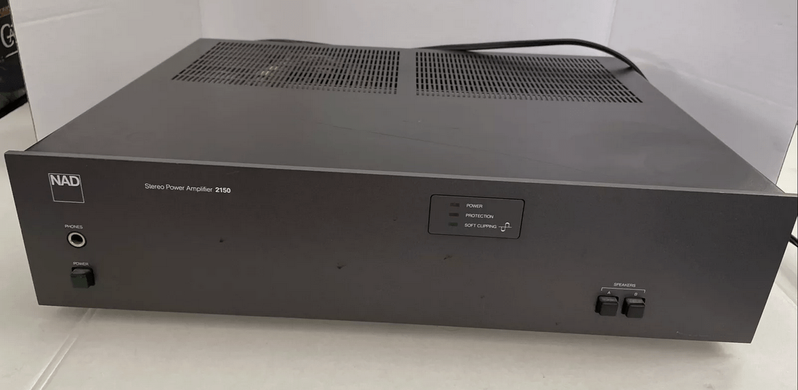

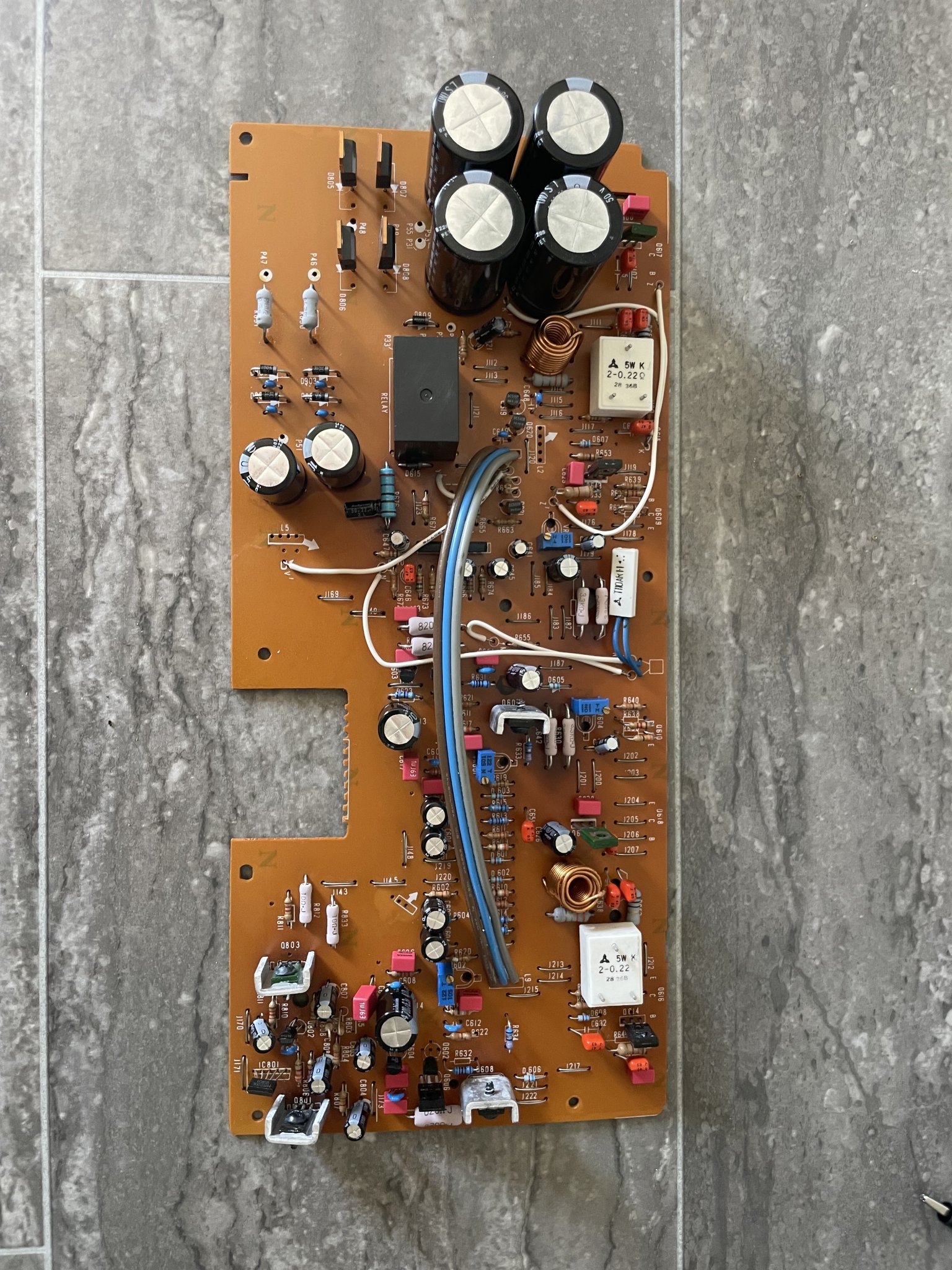

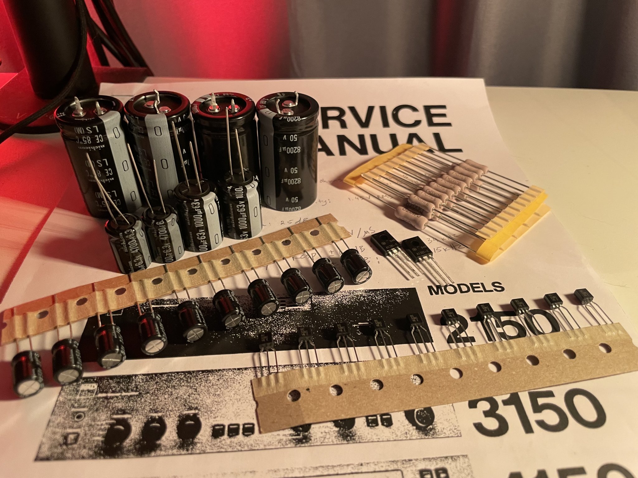

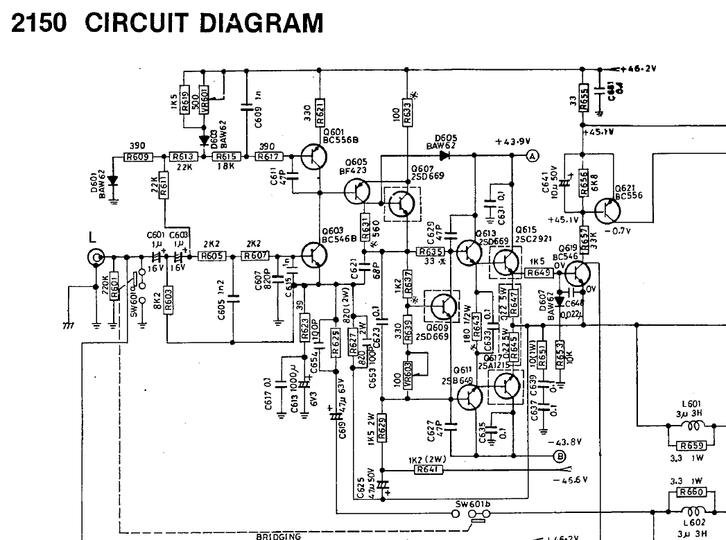

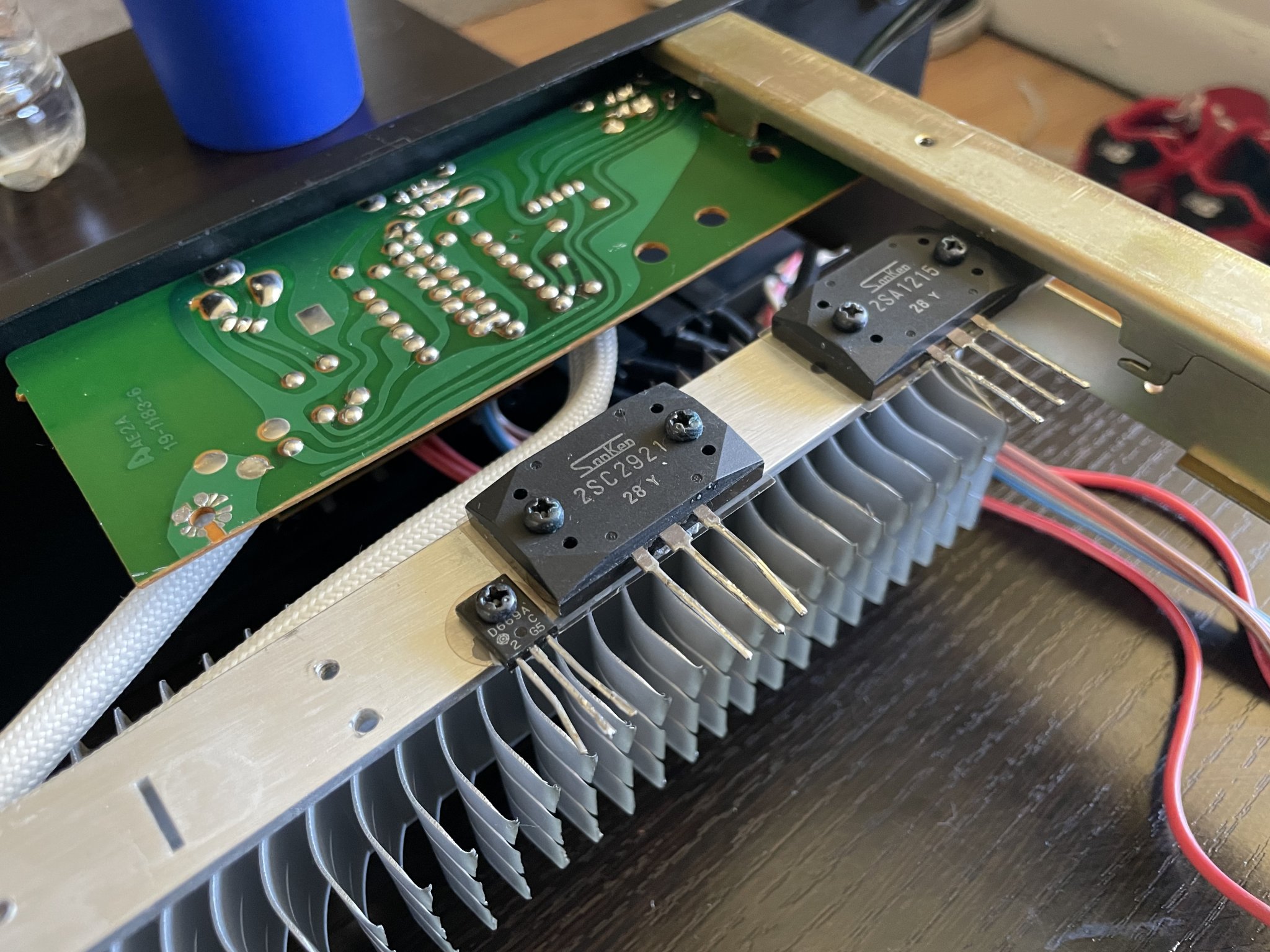

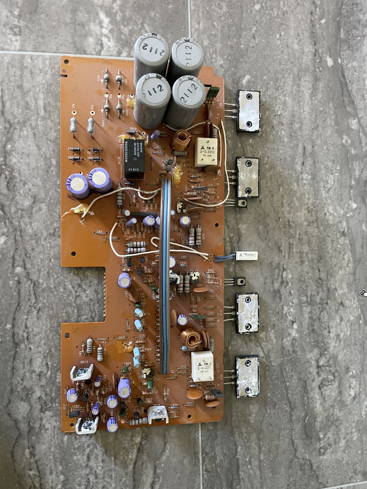

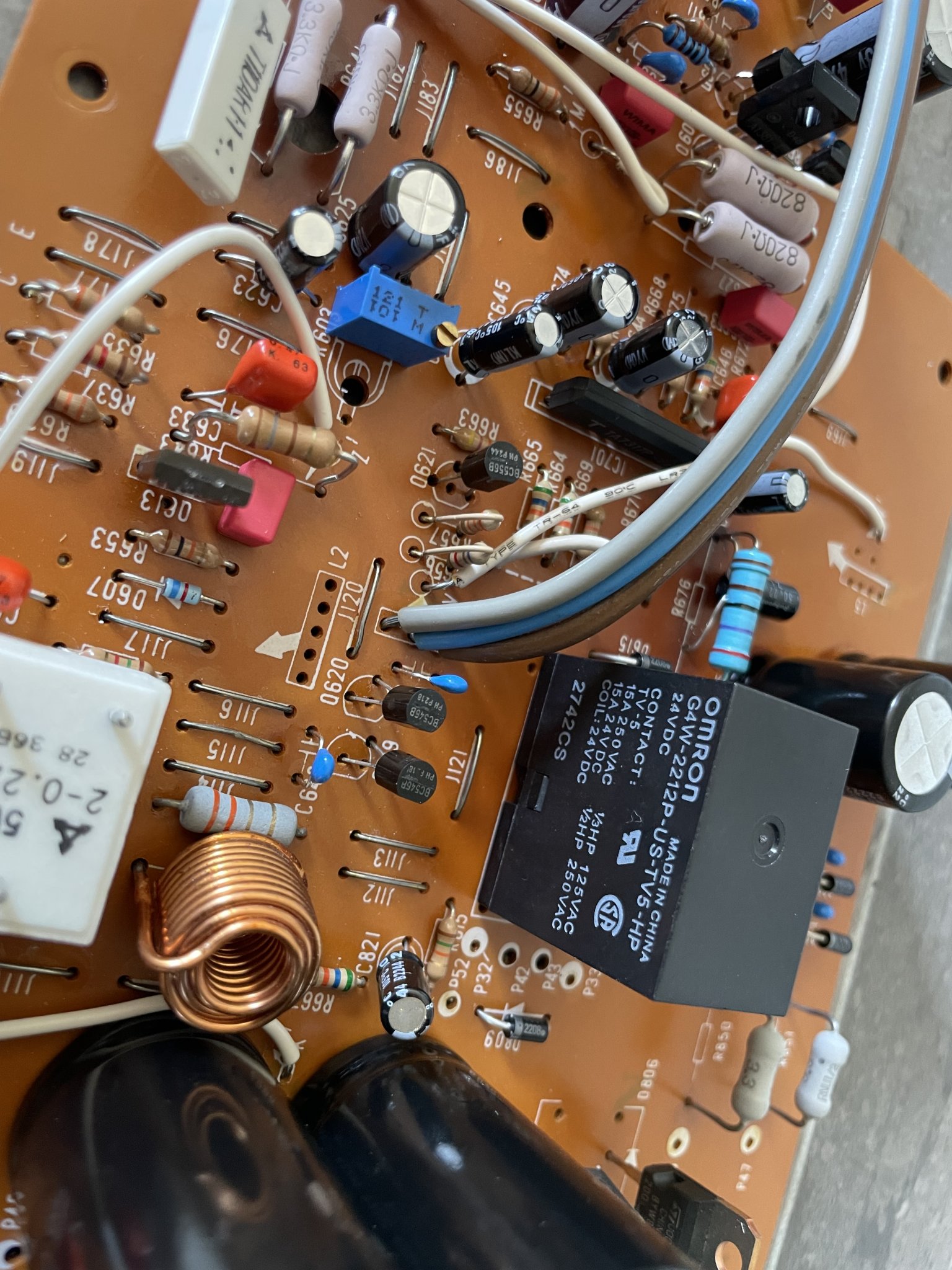

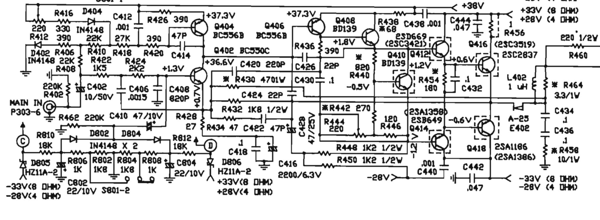

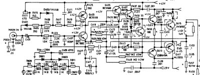

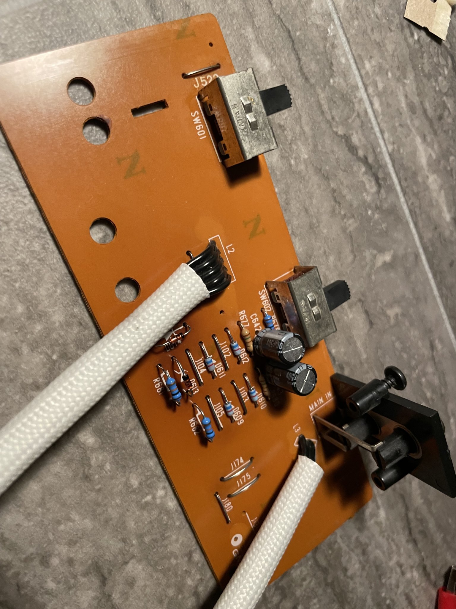

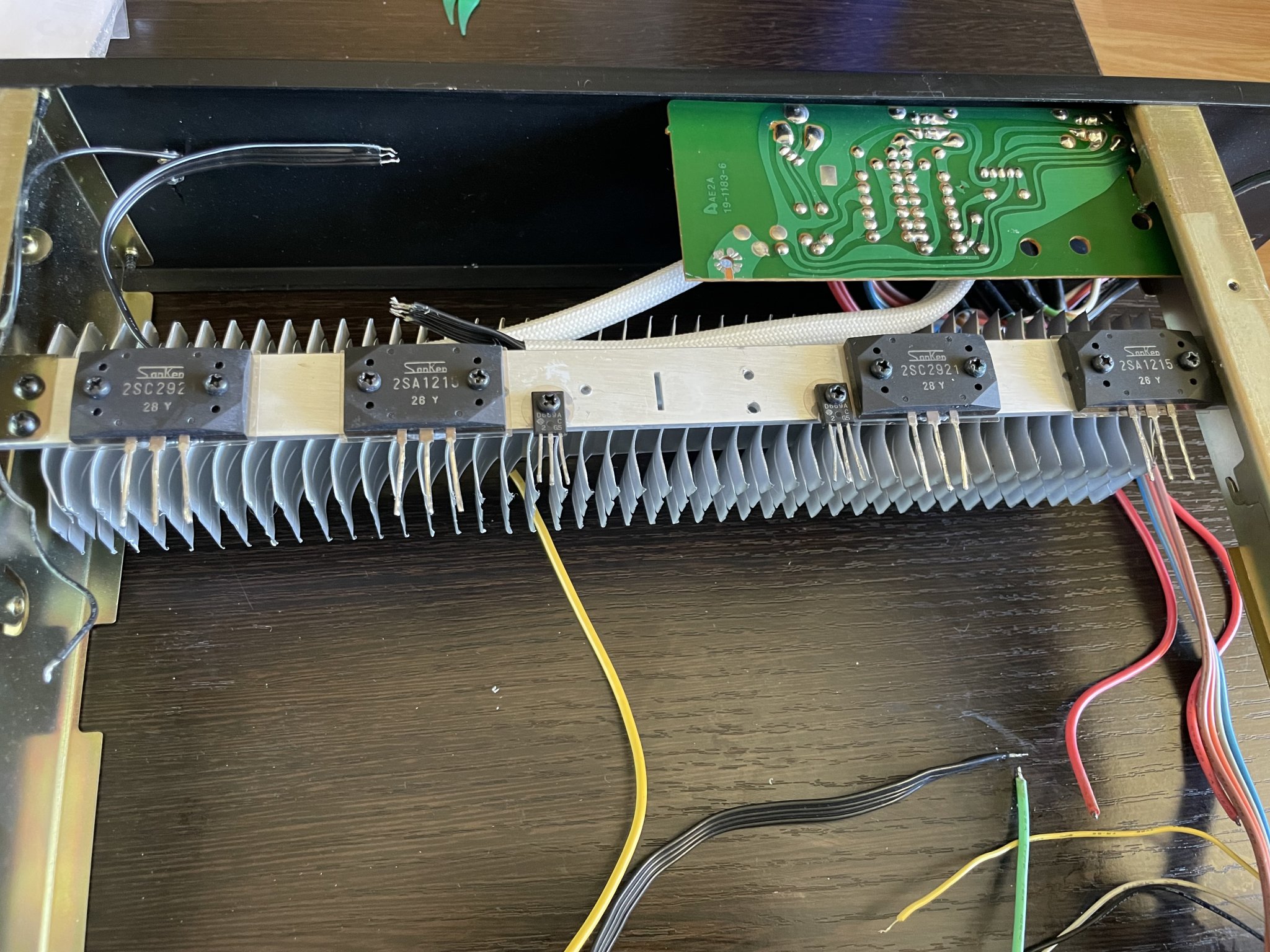

From the LTSpice simulation posted earlier, the NAD 2150 amplifier can be improved in several stages depending on how involved one is willing to be. The first and most straightforward upgrade would be to enhance the input filter and feedback capacitors. This can be accomplished by replacing the two 1µF capacitors C601, C603 (C602, C604) with two 22µF electrolytic capacitors, preferably of the non-polar type, and replacing the 1000µF capacitor C613/C614 with a 4700µF one. These changes will extend the low-frequency bandwidth down to 4Hz at -0.1dB and reduce Total Harmonic Distortion (THD) to 0.002% at 1kHz.

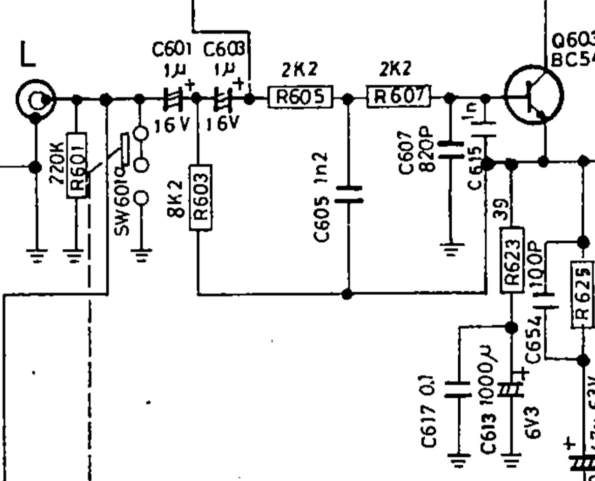

Noise performance can also be significantly improved. The input filter contains two 2.2kΩ resistors R605, R607 (R606, R608), which are the main contributors to noise. Reducing these resistors to 1kΩ improves the noise performance from 18 to 11 nV/√Hz. However, if these resistors are replaced, the filter capacitors must also be changed to avoid a high-frequency spike. All three capacitors C605, C607, and C615 should be 470pF to ensure a smooth high-frequency roll-off.

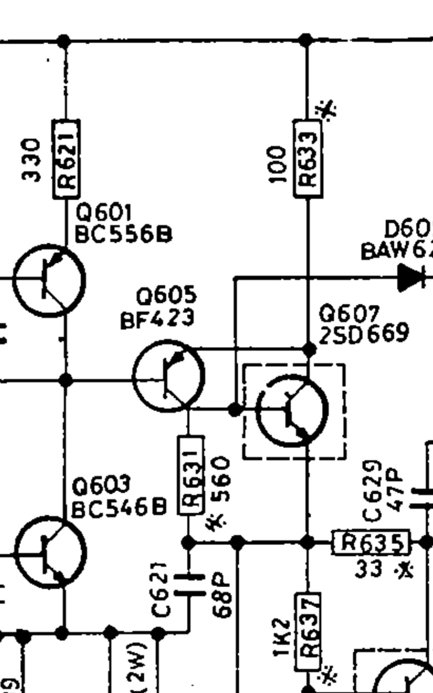

The Voltage Amplification Stage (VAS) offers several areas for enhancement. First, the Miller compensation capacitor can be reduced from 68pF to 10pF. It’s noteworthy that this capacitor was increased to 68pF in the 2150 model but was 22pF in the earlier release of the 3020 model. This adjustment improves the mid-frequency response. Additionally, the degeneration resistor can be decreased from 100Ω to 33Ω, and the 560Ω resistor can be increased to 1kΩ.
High open-loop gain in an amplifier is crucial for achieving better sound quality, characterized by a more palpable and musical wide soundstage. This is because a high open-loop gain significantly reduces distortion and enhances the linearity of the amplifier's response. When the open-loop gain is high, the feedback mechanism can effectively correct any deviations from the input signal, ensuring that the output signal closely matches the original. This results in clearer, more accurate reproduction of the audio signal, which translates to better separation and detail in the soundstage. As a result, instruments and vocals are more distinctly positioned and lifelike, contributing to a more immersive and enjoyable listening experience. All of the above changes contribute to an open-loop gain of 56dB at 20kHz and up to 90dB at 100Hz, further enhancing the amplifier's ability to deliver superior sound quality.
In the original schematic, the VAS current is set quite high at 16mA, resulting in 700mW of heat dissipation in the VAS transistor and 400mW per each bootstrap resistor. This current is set by a bootstrap network consisting of 1.2kΩ and 1.5kΩ resistors and a 47µF capacitor. Reducing the VAS current to 7mA can be safely achieved by changing both resistors to 3.3kΩ. Replacing the capacitor with a 100µF one will open up the low-frequency response down to around 4Hz.

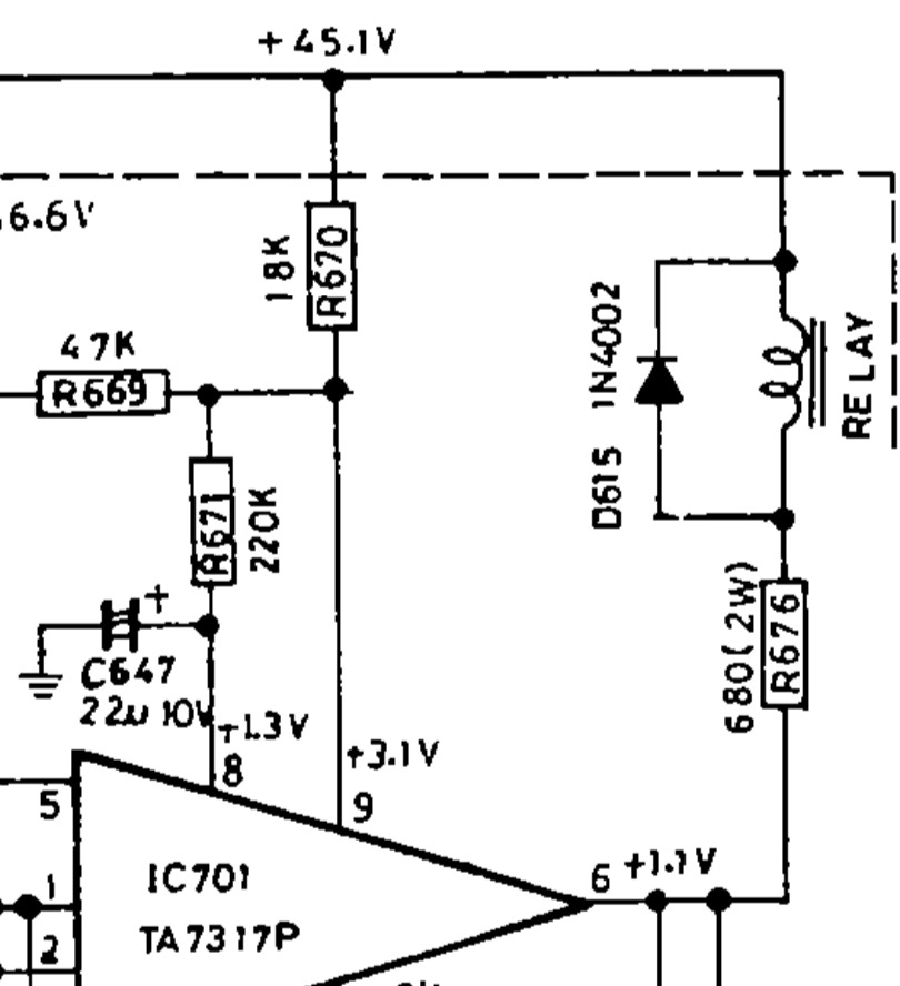

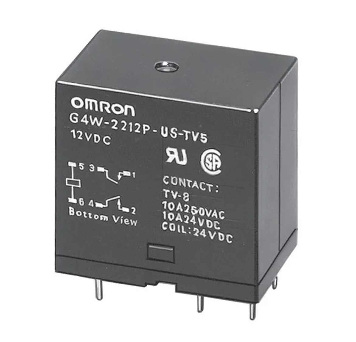

The speaker protection relay can be upgraded to an Omron G4W-2212P-US-TV5-HP-DC24, which is rated at 24V or 33mA and has a coil resistance of 720Ω. The schematic reveals that the relay is powered by 45V DC, necessitating an additional current-limiting resistor set to 680Ω. Calculations show that this combination results in 32mA current through the relay and resistor. Since the relay is normally open, it needs to be energized at all times to connect the speakers to the amplifier, causing significant heat dissipation. This issue can be mitigated by replacing the current-limiting resistor with a 4.7kΩ 2W type and connecting a 470µF capacitor in parallel with it. The capacitor provides the necessary current spike to close the relay contacts, then remains discharged, allowing only about 10mA of current through the 4.7kΩ resistor. This reduction in current not only saves energy but also reduces heat.
Reducing the current in both the VAS and the relay eases the load on the voltage regulator transistors, resulting in less heat generation.

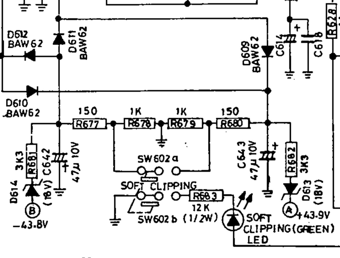

Soft clipping circuit can also be improved.
According to the schematics it has two Zener diode voltage regulators producing 18V. The original 3.3kΩ resistor value caused overheating; replacing this resistor with a 10kΩ one reduces heat and ensures more robust operation.

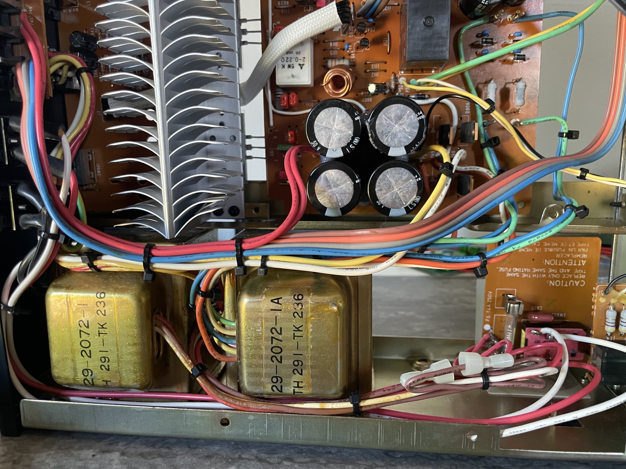

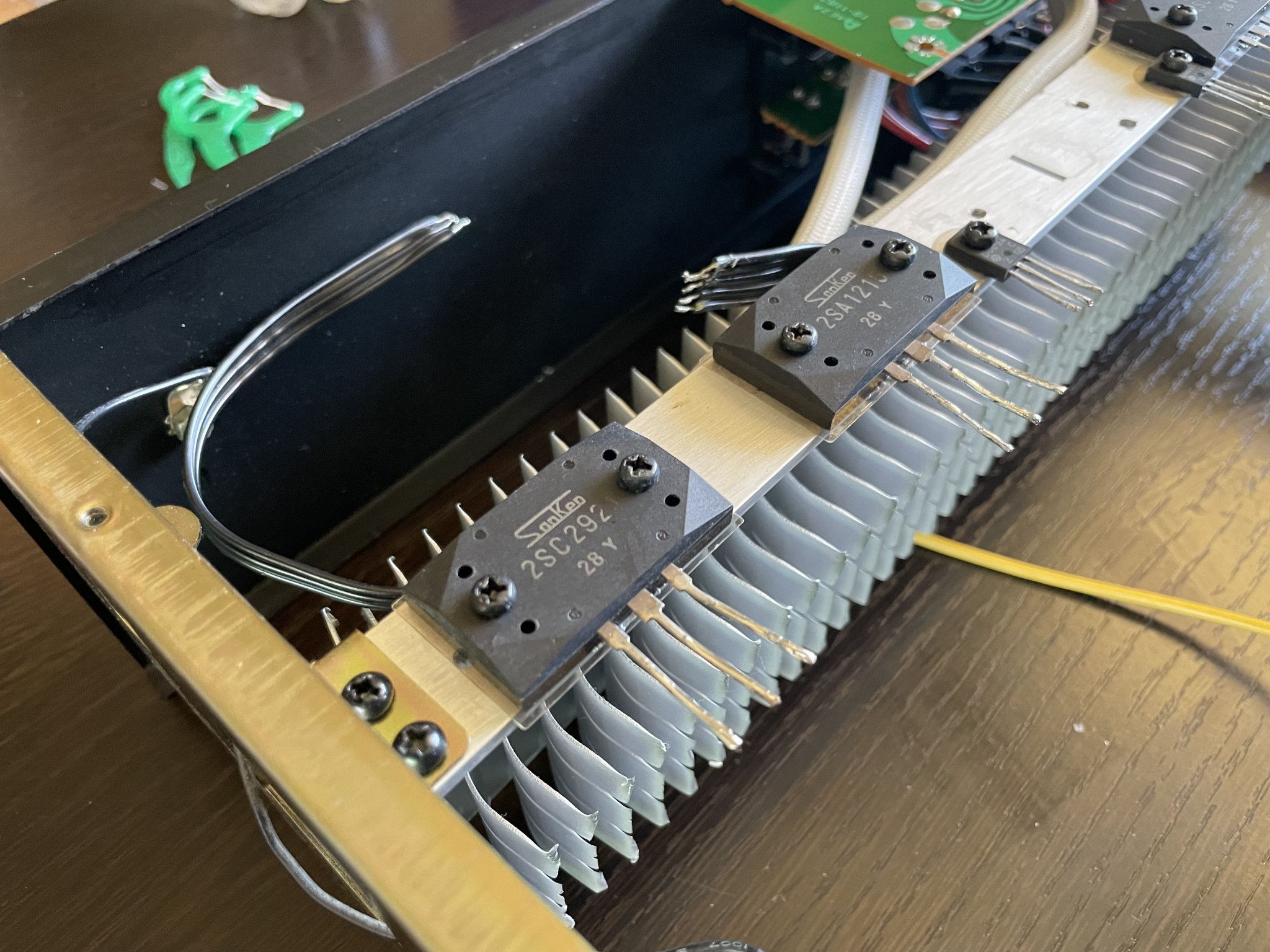

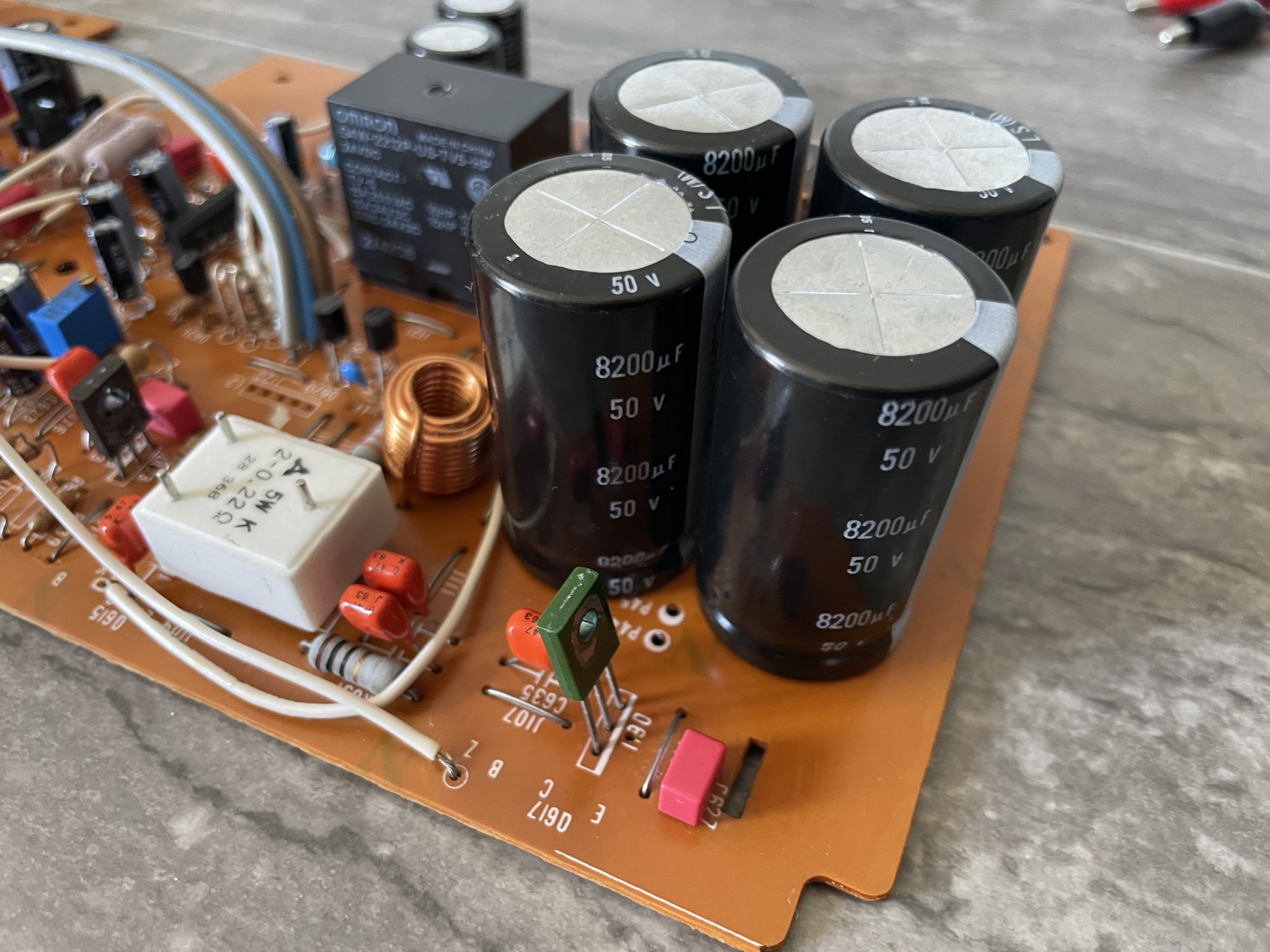

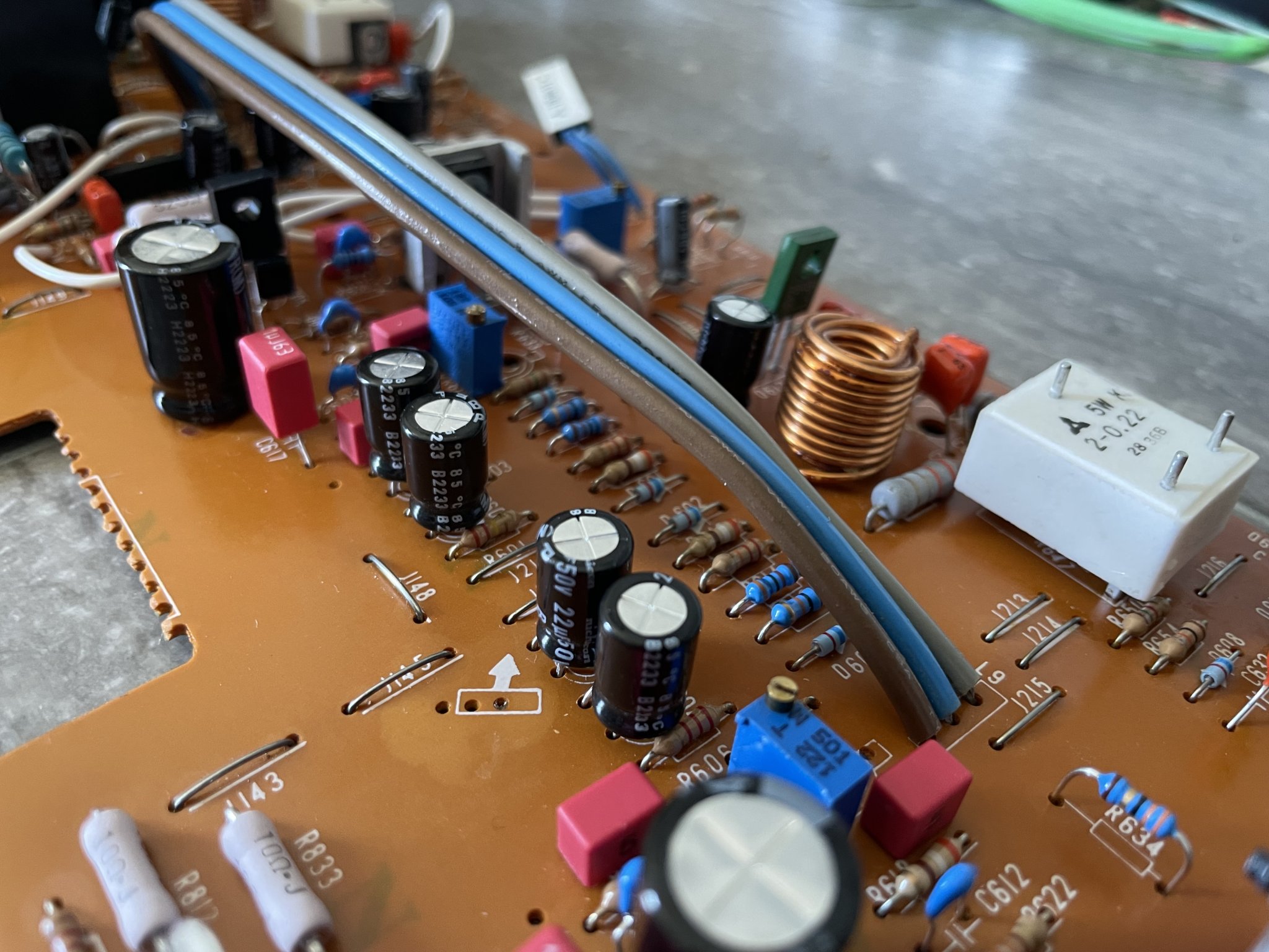

All these updates were implemented on my particular unit, along with replacing all electrolytic, ceramic, and mylar capacitors.
Before and after images are attached.
After reassembling the amplifier and connecting it to my Elac Debut Reference speakers, I immediately understood why the NAD 3020 series is so beloved. The amplifier delivers ample bass, vibrant and "musical" mids, and an amazing soundstage, allowing for hours of fatigue-free listening.
