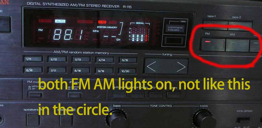

Have a Luxman r115 for 2 years, the tuner doesn't work since I got it.
CD and other sources work great. Tuner has issues, when I push in either FM or AM button, both red indicators light up simultaneously and both indicators stay on ( should be only one indicator light on accordingly , see pic. ), but no sound at all from FM or AM, some static noise when voluming up in high level.
Can tune(scan) automatically but no station/signal found, also can pick up a station manually but silent.
In a word, no sound from FM/AM, both indicators (FM and AM) are on when selecting either FM or AM.
Inspected and cleaned buttons and pots inside and outside, no improvement.
Seek some advices here, possible reasons.
Thank you very much.

option 1
Once the machine was sprayed with the wrong contact spray which most of it is still inside the switch work that out
Option 2
The switch is busted resulting wrong voltage ( s) fed to the tuner boards you need to work out exactly how the switches are working ( may as well hardwire any of them to FM only )
Obviously this is where my mind goes it could be a million other things still this generation of Luxman often has plenty of problems with these micro switches

Thanks. I checked again, almost damaged the other parts, that is what I can do.
It's hard to figure out like you said. Will leave it for, CD and others inputs are good, and sounding is good. Maybe someday I will buy another one once I have a chance.

The service manual is available at hifiengine.com: Luxman R-115 Manual - Digital Synthesized AM/FM Stereo Receiver - HiFi Engine
The datasheet on the PLL chip (LM7000), the core of the receiver is also available: LM7000 datasheet pdf datenblatt - Sanyo Semicon Device - Direct PLL Frequency Synthesizer for Electronic Tuning ::: ALLDATASHEET :::
With the help of these you can start checking out things in the AM/FM section.
You would need at least a scope for that though.
Good luck, Peter
