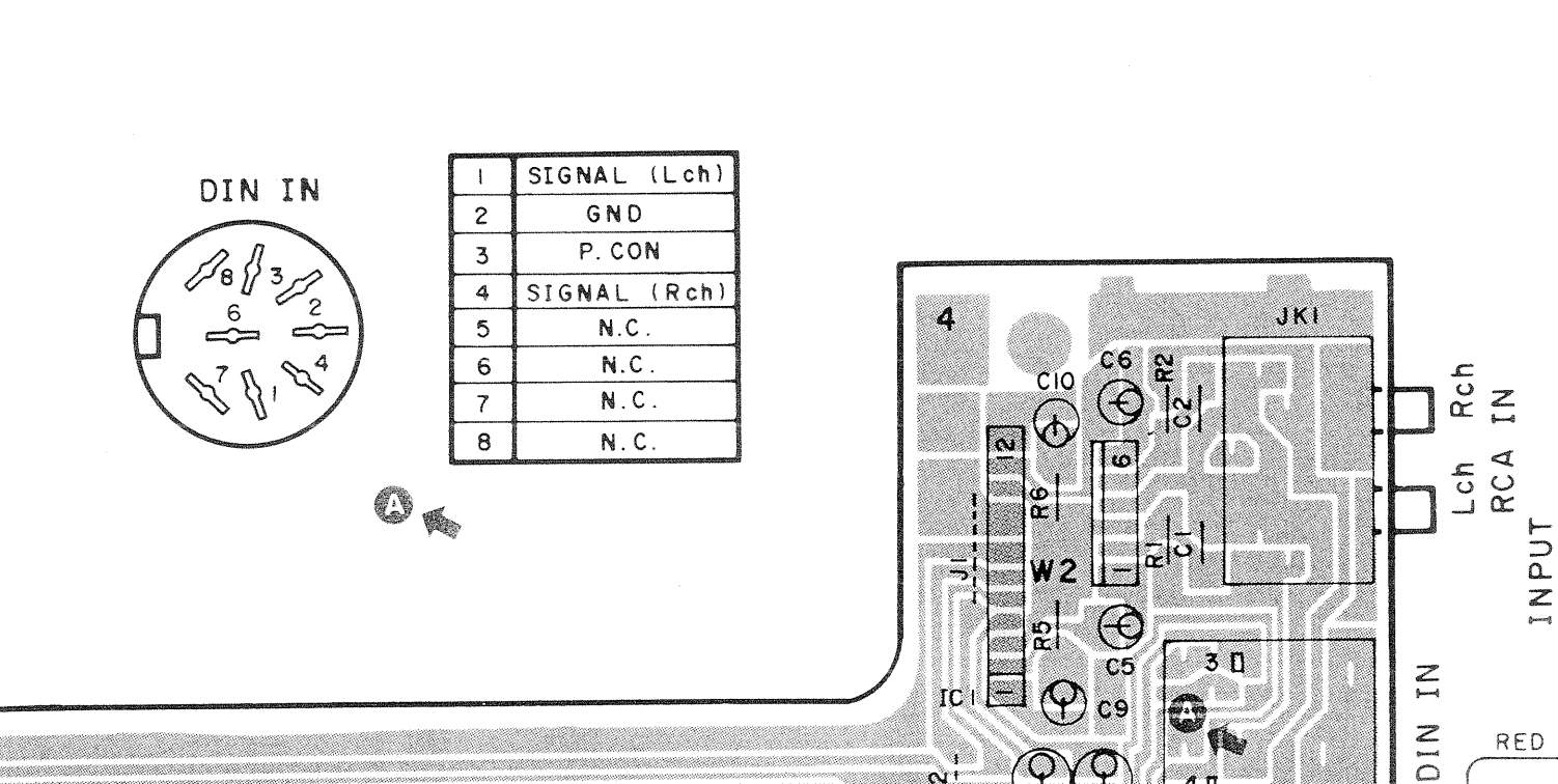

I have a vintage Kenwood KRC-747 fully working but without its connector.
Someone can help me with a copy of user manual pin connections?
I would like to understand which pin or what is the connection regarding cables.

Did it have a din connector like this?

Hi, thanks for suggestion. My unit is without the connector and so I rebulding the cable following service manual.... but I did'nt understand some connection.
Attach Service manual.
My question is:
- page 17: what means CD EJECT (pin 4)
- page 17: Pin 5 - IGN
- page 17: Pin 12 - Backup
- page 17: Pin 14 - Power Cont.
- page 17: where is remote?

Are you removing the connector on the back of the radio because you don't have the wiring harness? If so, have you tried locating one?
Ign = +12V switched
Backup = +12V battery (unswitched for memory)
Power cont = remote
CD eject would be used when connecting a slave CD player
