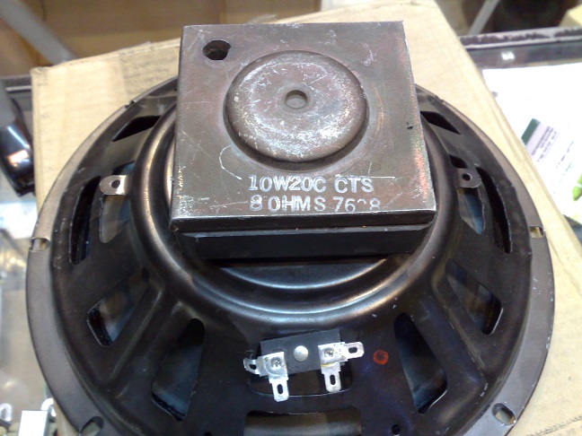

FWIW I use vented pole pieces in my own speakers, but would never ever create any kind of iron chips anywhere near a voice coil gap, already have enough trouble with unexpected unseen ones.
I ask my lathe operator to drill polepieces while turning them; no big deal because he uses a multi tool lathe, it´s just an extra operation.
Besides cleaning with compressed air, IF any tiny chip remained, it would disappear during the plating operation which includes various boiling water stages, degreasing, pickling in acid, etc.
But on an already magnetized and assembled speaker ... forget it.

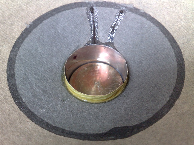

What about making holes in the cone somewhere under the dust cap? I've seen it in several woofers.

Doesn't resonances in the sealed space under the dust cap bother you? I find that much more annoying. It causes ringings in the mids. I treated the problem in several woofers by making holes in the cone under the dust cap. the results were pretty acceptable- and there were no pole piece "tube" resonances. The only problem this strategy will face is cone weakness towards mid-basses if digging too many holes.The cavity resonance in the hole causes colouration i do not like.
They can. Being a smaller space they will be higher in frequency.
We deal with it either by taking the dustcap off and installing phase plugs or by making the dustcap more opaque to stuff behind the dust cap. At least some of the drivers we use also have vented voice coils.

Thank you all for replies. Now I know which way to go with my new pair of vintage woofers. There's only one question not answered, and that's whether making holes in cone or spider any advantageous. I guess no one has much experience with this kind of thing. Any ideas on it is appreciated, because I use this technique a lot.
Could you please be more specific?I vote no
The side effects are dust and small iron particles get into the gap. and the cone and spider weakness.
On the other hand, you get extra ventilation, lower Fs, extra efficiency and more low freq linearity especially in bigger boxes like car trunk (where I use this technique to push stock car speakers to their limits).
I have seen pictures of an example of someone successfully drilling a hole thru the pole piece (BOFU), but the purpose was to allow mounting of a coax tweeter, not to ventilate the driver (althou taking the dustcap off did that).
