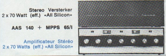

The only brochure I have seen of an AAS140 shows a small photograph where you see even less than on these photos. The characteristics state 2 x 70W RMS into 8 ohms, but I'll have to look up my scans in order to show this and to tell more...
BRs,
Jacques
[...] The only brochure I have seen of an AAS140 shows a small photograph where you see even less than on these photos. The characteristics state 2 x 70W RMS into 8 ohms [...]
Here is the page and the (small) description at the bottom right.
