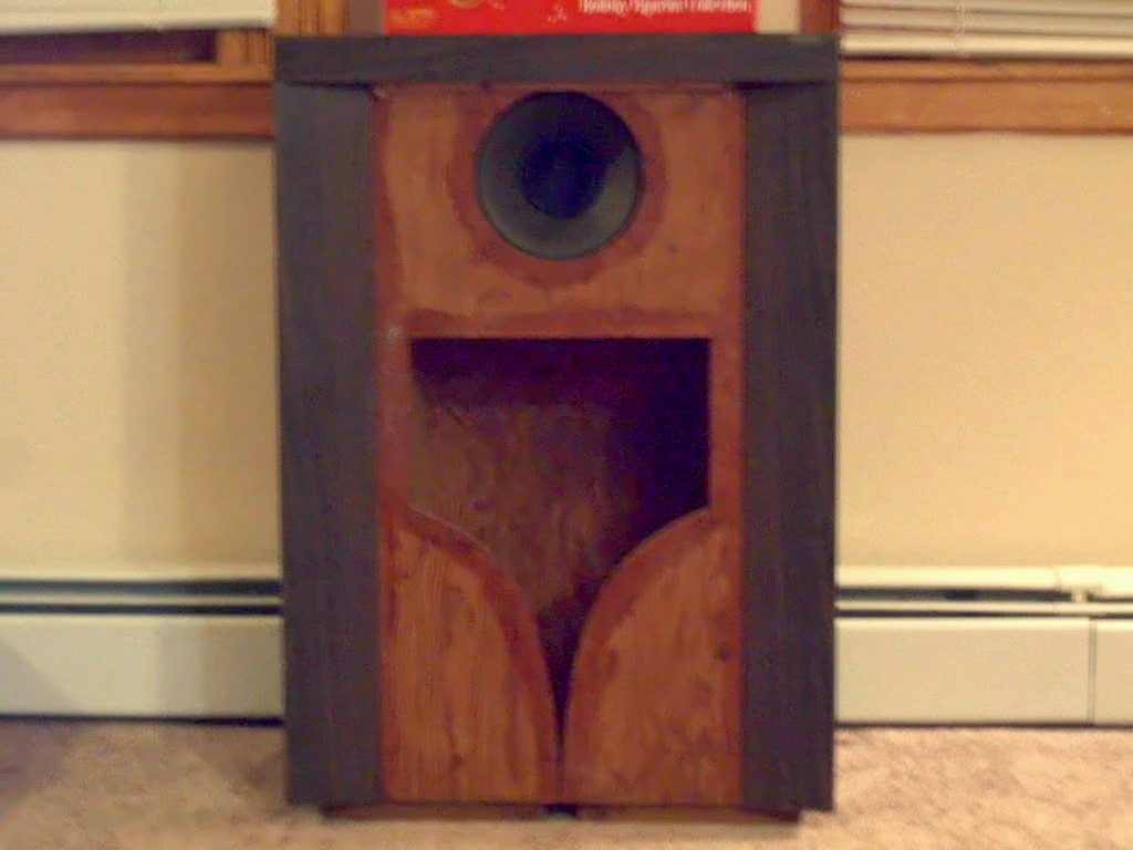

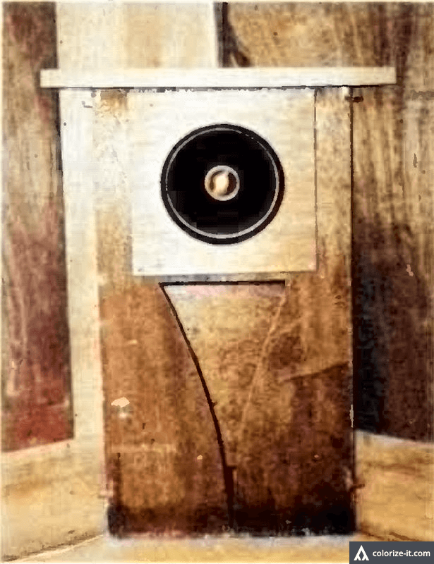

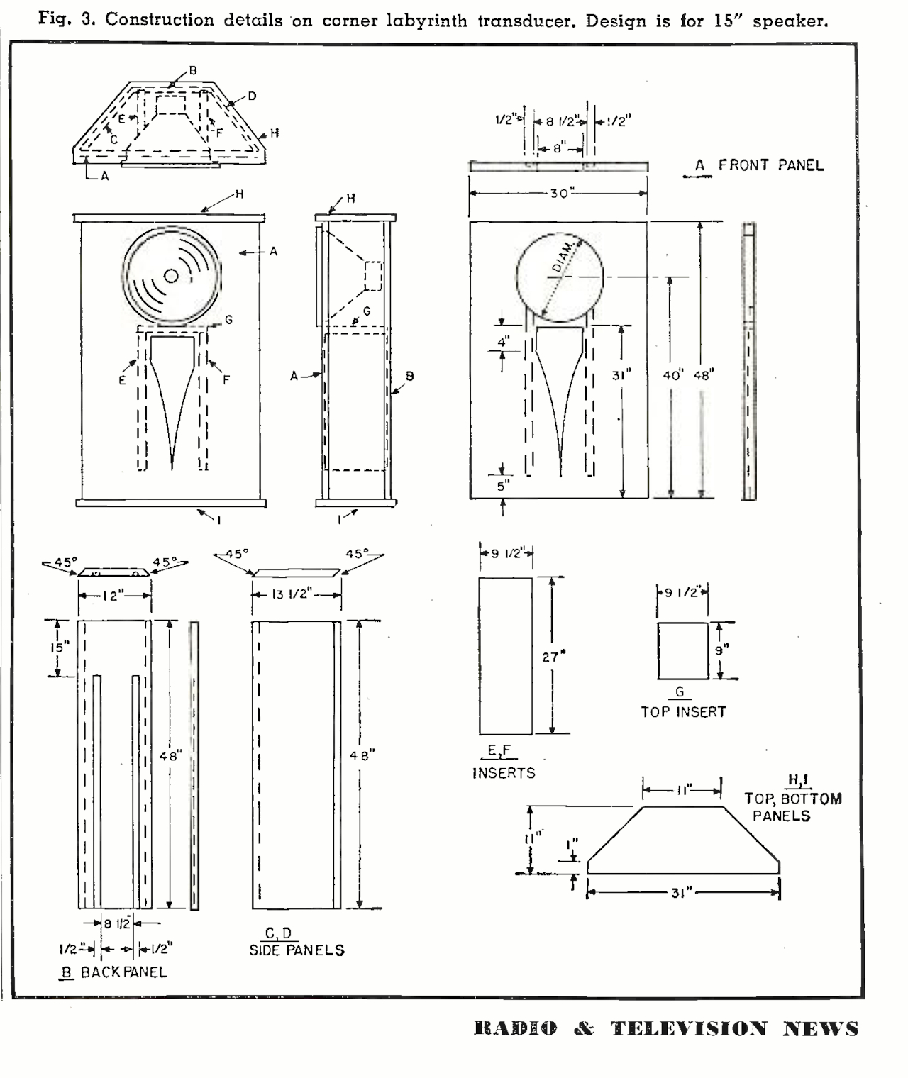

Vintage article "A Tuned Pipe for Bass Enhancement" by Raymond Bates
from the 1955 Audio Anthology reprint of the original article. (and a very clean looking issue)
Norman C. Fulmer had already published an article (and patent) for an enclosure with tapered terminus.
This article borrows part of Karlson's 15 aperture for the tapered slot exit.
Subjectively the builder seemed pleased :D
It appears to be tuned about center of the EV SP12B speaker's resonance.
I wonder how its response would really look.

since its rear load and direct radiator, there would be no more effect upon the highs than a reflex box. I don't have access to hornresp - maybe GM oe aomw other handy soul would do a sim with a couple of the following
Fane12-250TC, Eminence 12LTA, Celestion K12H-100TC, Celestion K12H-200TC Eminence Beta 12CX, Eminence B102, Nirvana 10 inch, etc.
There's less than 2 cubic foot airspace - a Karlson K12 has about 1.3 cubic foot rear chamber - both appear to be tuned in the low 60's.
Snugged into a corner, the Bates pipe would take up very little space - and might even work well.
(my Karlson K12, depending upon driver, can do some things better than my Klipschorn !- do not be afraid of Karlson or Karlsonator when loaded with appropriate drivers - - run for the hills if a K12 is loaded with a GRS BOFU knockoff. :))
