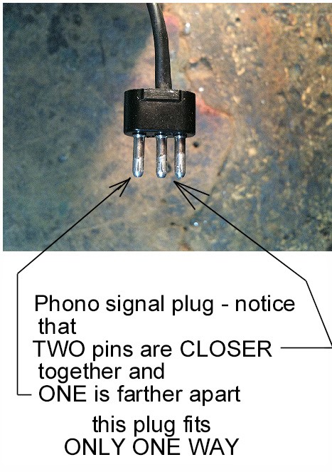

Does anyone know what this chassis plug is? It's mid 60s vintage and is the tape input on an RCA console stereo. Left/right with ground in the center. It's maybe 25-30mm wide.
I vaguely remember these connectors, but haven't seen one in agesand sure don't know what it's called.
Of course the irony is that this RCA console has no RCA connectors. 😛

Since I'm an expert on RCA Victor products, I'll say..
That is the old style (prepriatory) connecter they used for their stuff.
Center pin is common ground.
The pin farthest from it (top pin) is right channel...... the remaining pin is left channel.
Look closely, you'll notice that right side pin being farther.
In those consoles, it's used as BOTH an input or output depending on the preamp selector position.
In other words, on "tape" setting, it's a line input.
On phono, am/fm, it's a line output.
They can be removed and replaced with a suitable set of standard RCA jacks.

Thanks! Good to know that's is a "real" RCA connector. 🙂 The layout is as you say, with right at the top, the common, in the center, left on the bottom. Interesting that it is both an input and output. This is on a big Finlandia console from from the mid '60s that needs a lot of TLC.

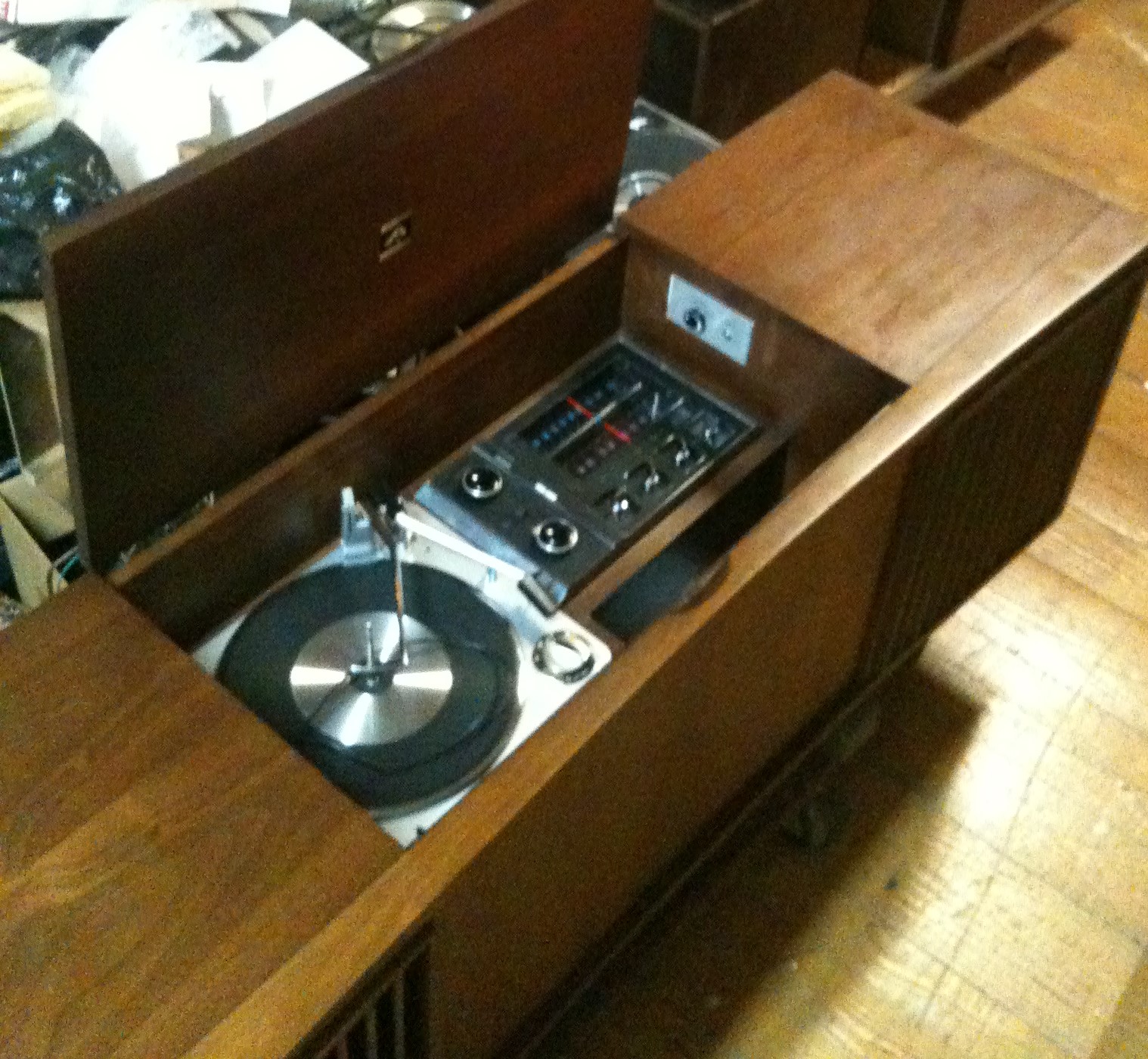

Here's a similar TOTL console at my shop 6 years ago that I restored for a customer..
A real monster. - Original MSRP in 1965 = $550
My restoration fee back then = $495

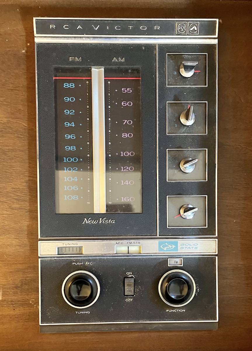

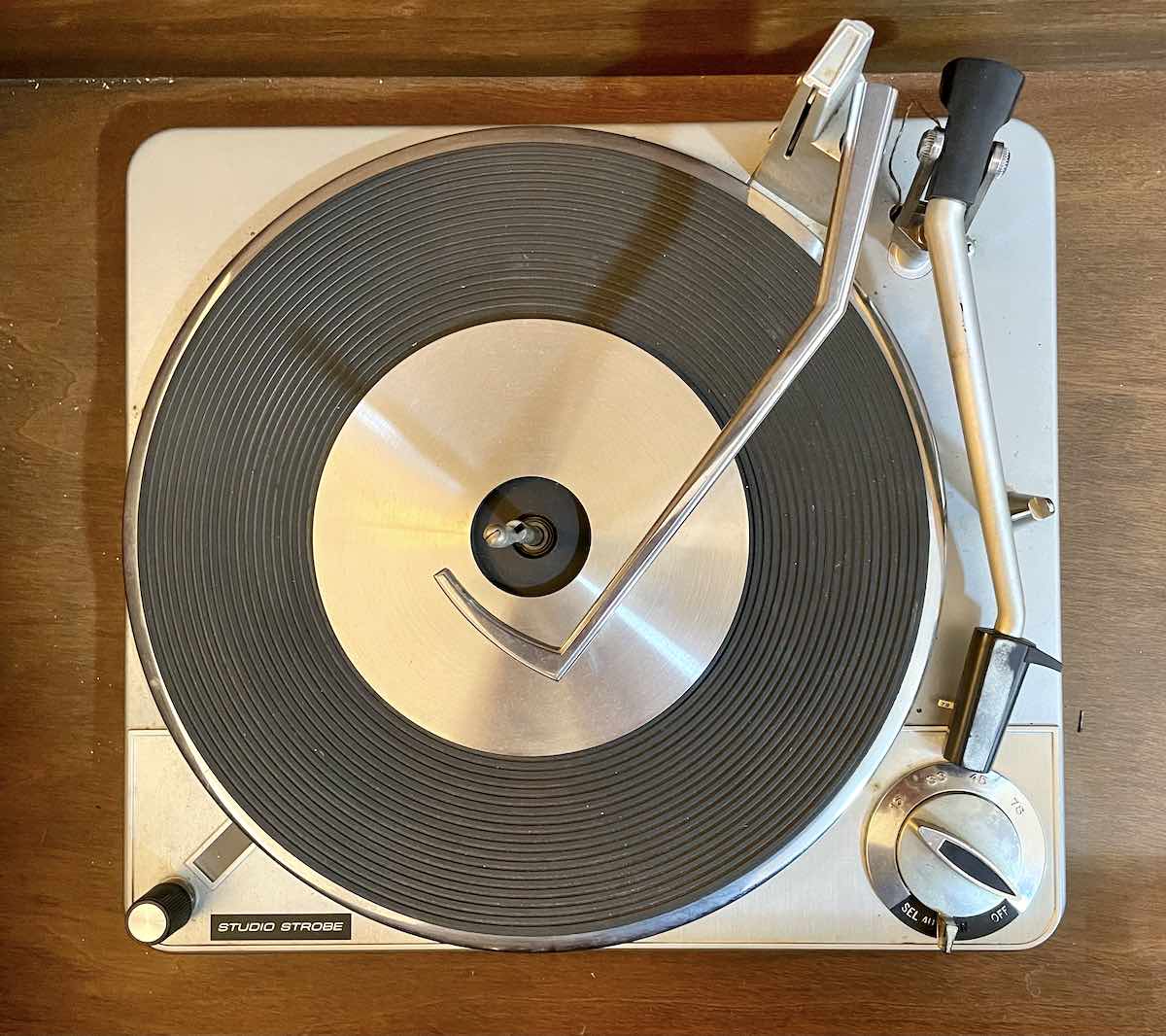

Yes it has the TT strobe. Never saw that before in a console. Looks like the same tuner as you posted, bu turned 90 degrees. They certainly didn't skimp on the speakers. 🙂

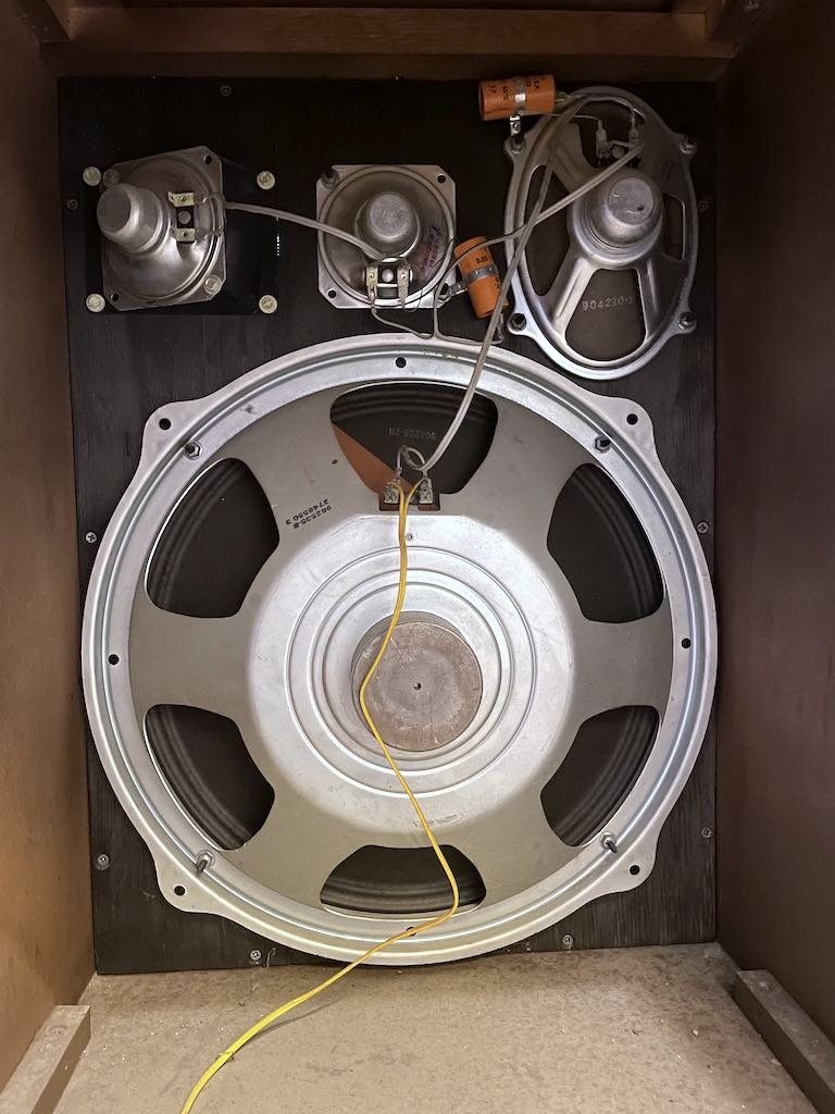

Pano, those tuners and amps all require (need I say it) recapping the 'lytics, the changer needs a teardown and flush/re-lube, etc...probably rotten rubber grommets too.
Speakers were matched to the sonics of the system and cabinet, and should remain.

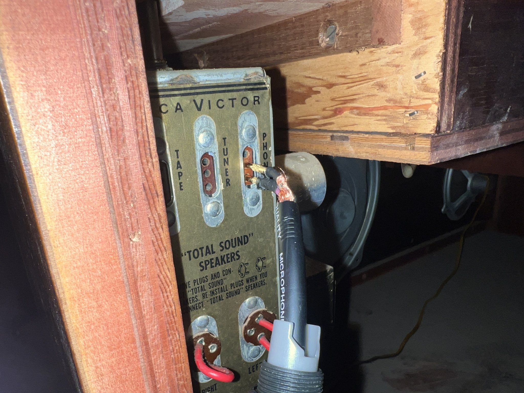

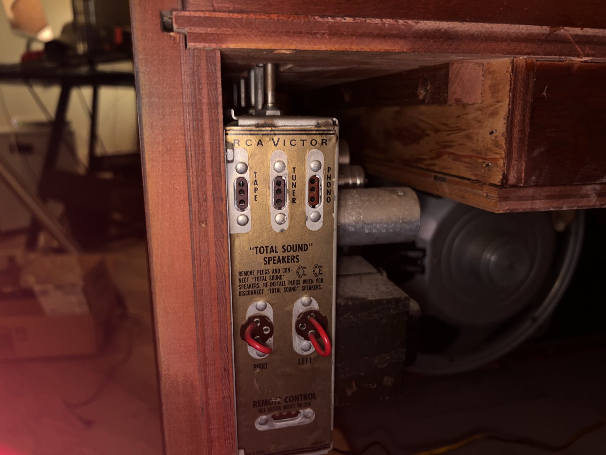

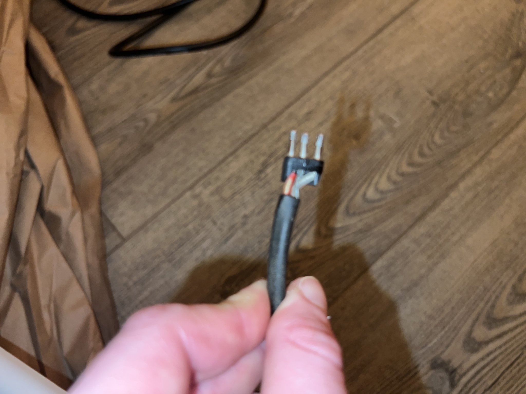

For what it's worth, if anyone is looking for a quick POC on how to make a new connector, I found that XLR connector pins fit just nicely. I repurposed a mic cable I had laying around, but will do the same with a deconstructed single XLR to stereo RCA adapter.
I'm working on modernizing this console to connect to my media server with a phonograph feed in so I can ultimately use it as an Airplay "speaker" and play the TT to my other Airplay speakers. So this is step one as a POC.
