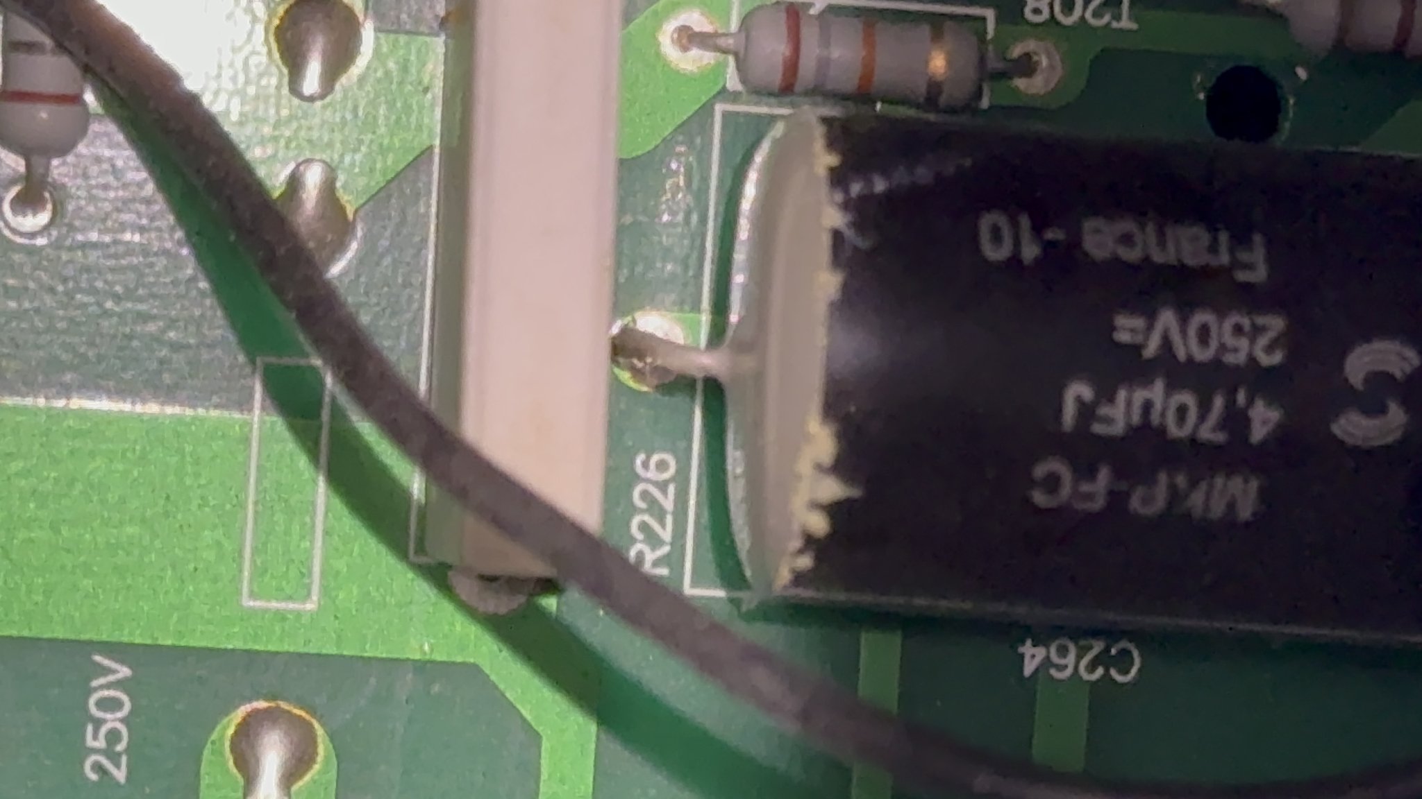

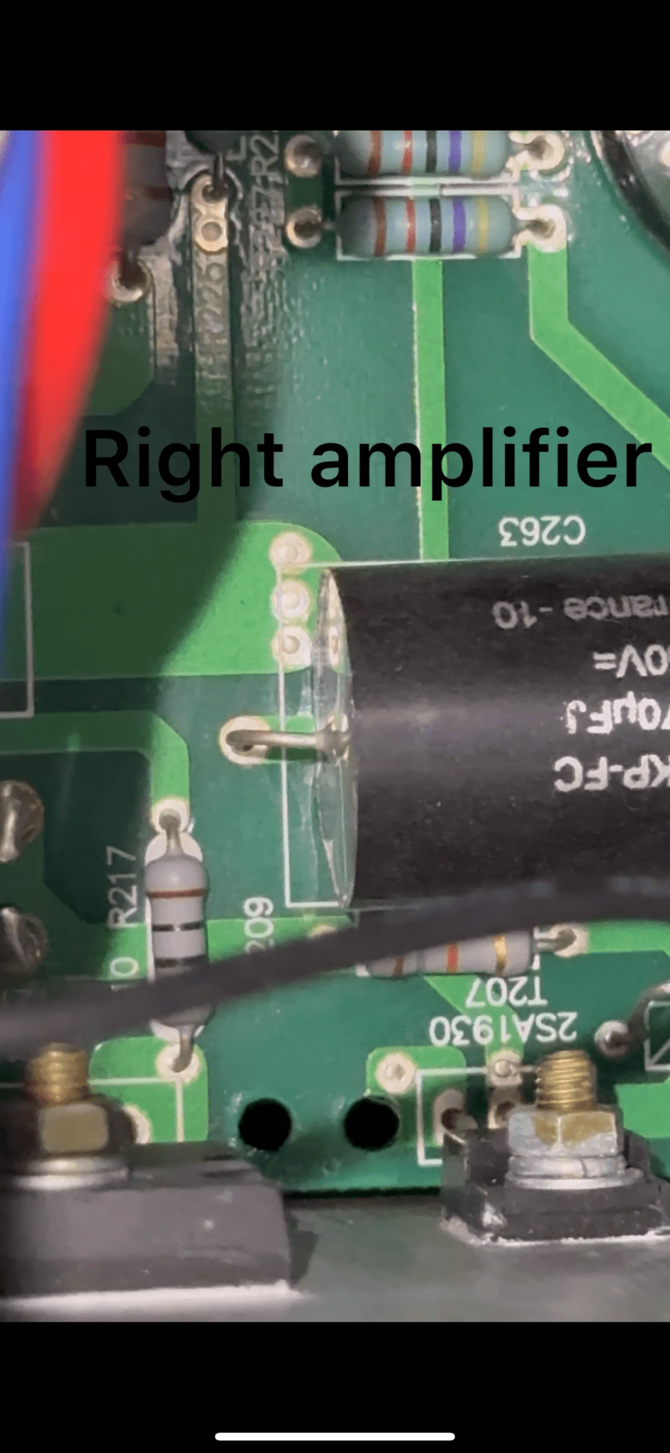

Attaching 2 images
The capacitor bulging in a suspected amplifier.
The other picture is from the other amplifier which has decent looking capacitors
These are Four Solen Capacitors 4.7uf
Two on each side of the main board

Check these with an ESR meter and lift one terminal from the PCB and measure capacitance. These could be defective or not!
These are not electrolitic capacitors!

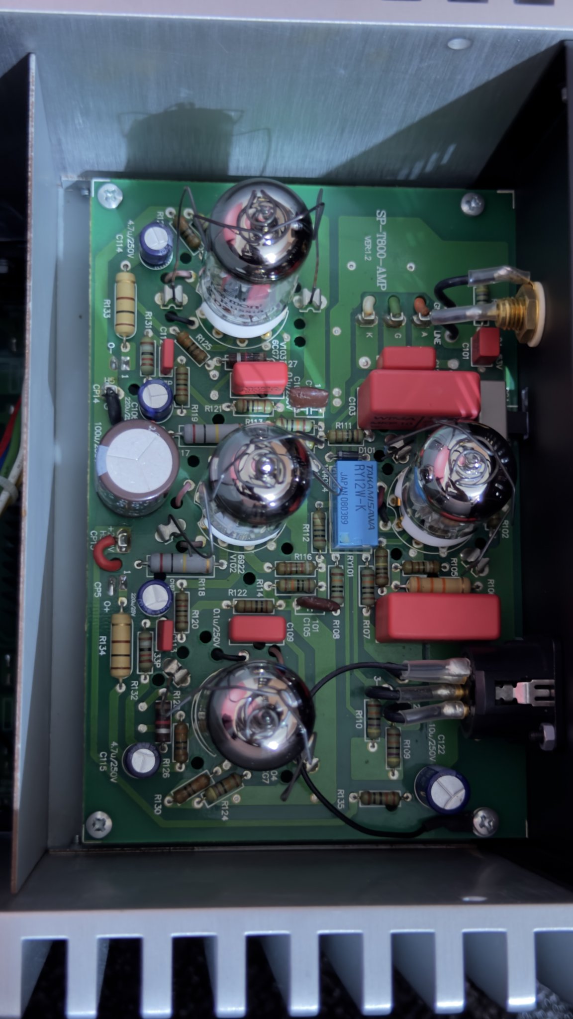

Just tried something while troubleshooting the Amplifier...
There is a selection switch behind input section to select between RCA or XLR
When i move the switch to XLR, behavior normalized
Looks like something not working right in RCA input circuit.

Looks like you´ve located the culprit then.
Make sure, it´s not a bad connection in the SE/BAL-switch itself.
Now would be the time to get a schematic.
The company to ask is "Sintron Distribution GmbH".
Contact info in bottom of LINK

@968driver
Amplifier is packed like a tank,looks like it is impossible to access under the input tube section for measurements unless getting the whole thing apart.
Very frustrating!
I will try swapping the tubes from my second identical amplifier and see if it solves the issue.
