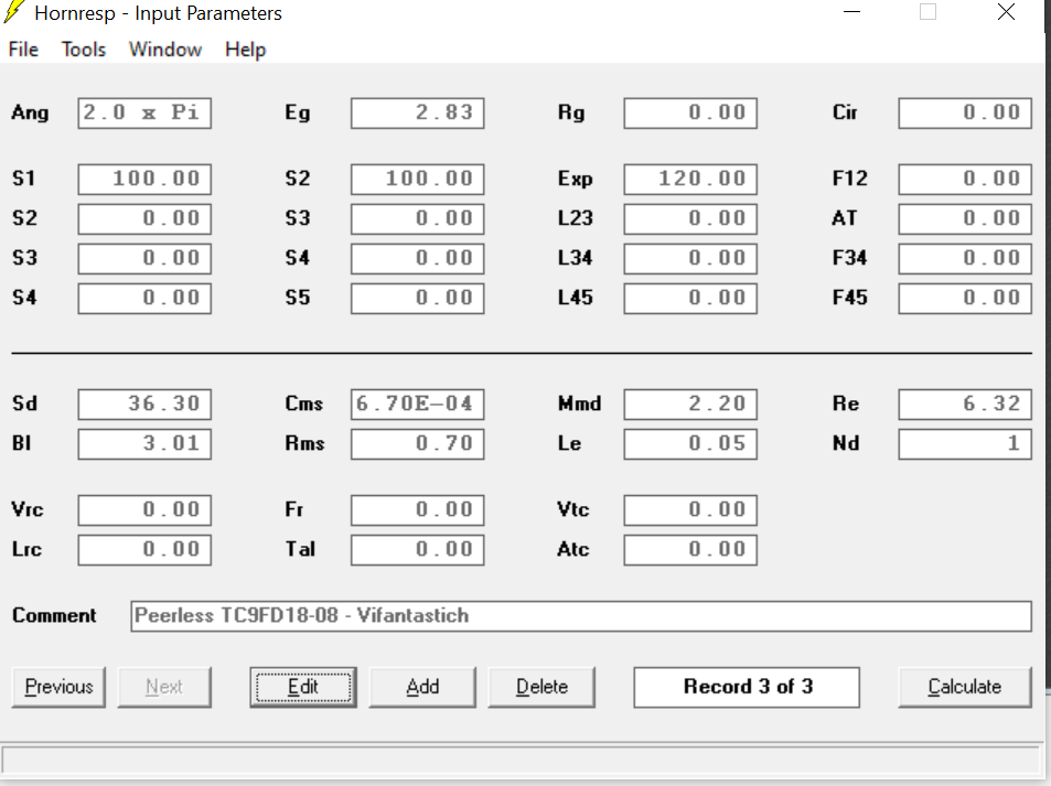

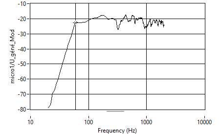

So I managed to grab a pair of Vifa TC9FD18 and I had a go at the Vifantastich design (1.2m constant section TL), and I measured the response 1m away in-axis (below) (resting on the floor of a semi-anechoic chamber).

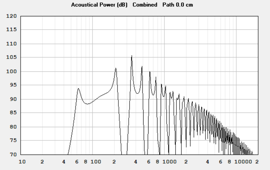

I also attempted to model it in Hornresp. I got very different results from the reference hornresp sim (on the German site linked above), which I suppose comes from different T/S parameters, which puzzles me a bit (I got mine from loudspeakerdatabase). Which are good ? Did anyone else try to model it ?
About the sound, they lack bass. Could that be because of excess stuffing (I filled the part between the driver and closed end with PE fibers) ?
Also, is the 5dB loss from 160Hz to 60Hz normal ?

WIth the Q of the TC9 is not well suited to any box except a big sealed box or something that approaches that. I would not worry about the sim, i would just build a simplier box (about 5 litres sealed does OK.
I know the TC8 get slots of use because it is cheap. But it is a cheap driver (i had to really work to give my 4 away).

I had to add a constricted vent to turn it into a MLTL. The bass was much improved. Use only light stuffing from closed end to 180 deg turn. It’s a wall mount so should not need baffle step compensation.

Yep, with its high Qts, the TC9 is not the best candidate for a TL.
Even though I knew it, i did try it, just to confirm. 🙂
The TC9 will be much better with a woofer helper taking care of the bottom end.
If you want to stay in TL territory, look for drivers with a Qts around 0.5. They usually work better.

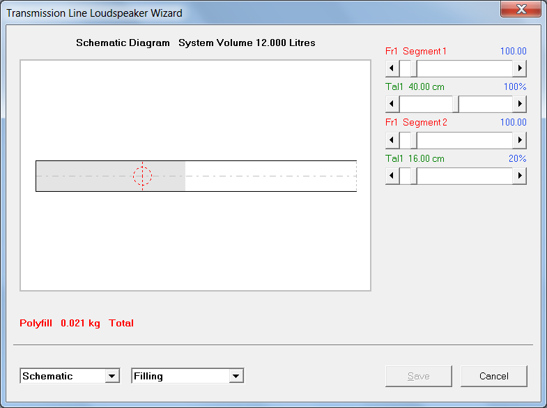

The design needs to be modelled as an offset driver system (OD not Nd). Add absorbent filling material using the Loudspeaker Wizard.
