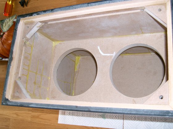

Zaph,
Unable to reach you through email so I thought I would post a question here about your Vifa/Seas MTM.
I really like both of these drivers and thought I would build your design. Do you use any bracing inside the cabinets? Also, do you use any inside cabinet wall treatment? I've had a couple of suggestions - one was latex tile cement on the inside walls to deaden the cabinet - the other was Whispermat or simular material (along with the Acoustuff).
John

Re: Zaph's Vifa/Seas MTM
Hello,
Yes, the insides are heavily braced. These are the pre-fabricated enclosures available at Parts Express. I used only acoustistuff because this box is relatively stiff, but you could certainly use whispermat or something that has a mass loaded barrier.
Here's the bracing inside:

Hello,
If you're building your own boxes, you could probably get away with a simpler form of brace, such as the single board in this box I built below. You'd be surprised how much stiffness a single board can add when it is placed from side to side as shown.
