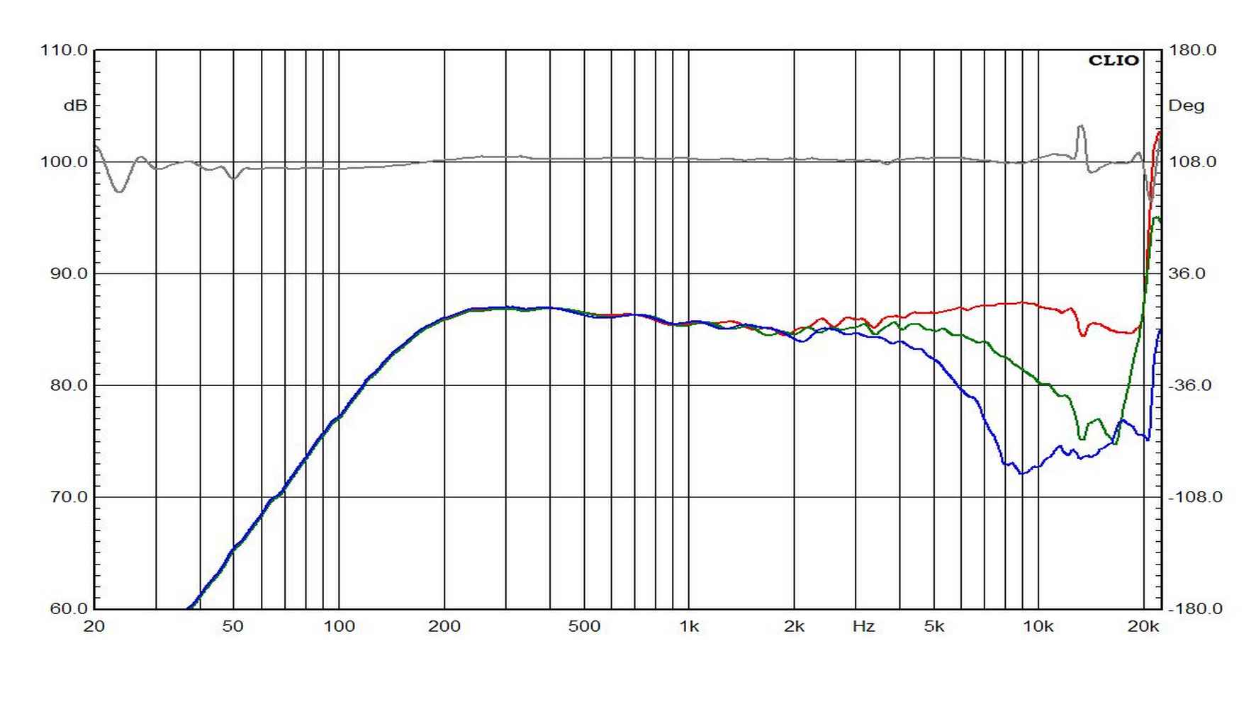

To me the plot legend indicates your labeled dipole peak is 60 degrees off axis; and on axis looks to be 6-7dB lower?
Barley, that's correct. Which is part of why the dipole peak is audible and objectionable. If you eq the on axis response flat, the off axis response develops a 'peak' right in the heart of the most important frequency range.
Something I just noticed is I feel like there should be more low frequency losses while moving off axis. I only show about 1db per 30° but should probably be more. It was quick and dirty, so don't take it as gospel. I may have slowly moved the microphone in. I didn't use a jig.

This is from Linkwitz's Models for a dipole loudspeaker design:
Baffle diffraction effects are what gives your driver an extended plateau; and effectively makes the frontal polar pattern much the same as if a chamber enclosed the back of the driver as mounted in your pictures. Side lobes in above picture of circular baffle would be smoothed out and shifted with rectangular baffle.
There seems to be some serious issues with HD and peaks/dips and breakup with this driver. Why would you want to use it over a TC9FD or TG9FD? I see no compelling advantage other than it has a pretty alloy frame and deep hung Nd motor which means your cabinet has to be deeper.
Ya, I think my mic may have been a bit to close for the 60° measurement. But, could also be the insulation soaked up some. Maybe I screwed around with the gain by accident. Who knows, I'm not gonna redo the test. But I think the 60° curve should be down a couple db.
I don't think this driver is that big of a train wreck. Most FR drivers get gnarly above 8khz, even if their frequency response is slightly smoother. This actually isn't that bad. The HD in TMM's measurements isn't that bad either. Most of it will be in the stop band for a 400hz XO, so that seems reasonable. But I'd certainly agree there's nothing here that say "wow, this thing blows away the competition, everyone order a pair right now".
