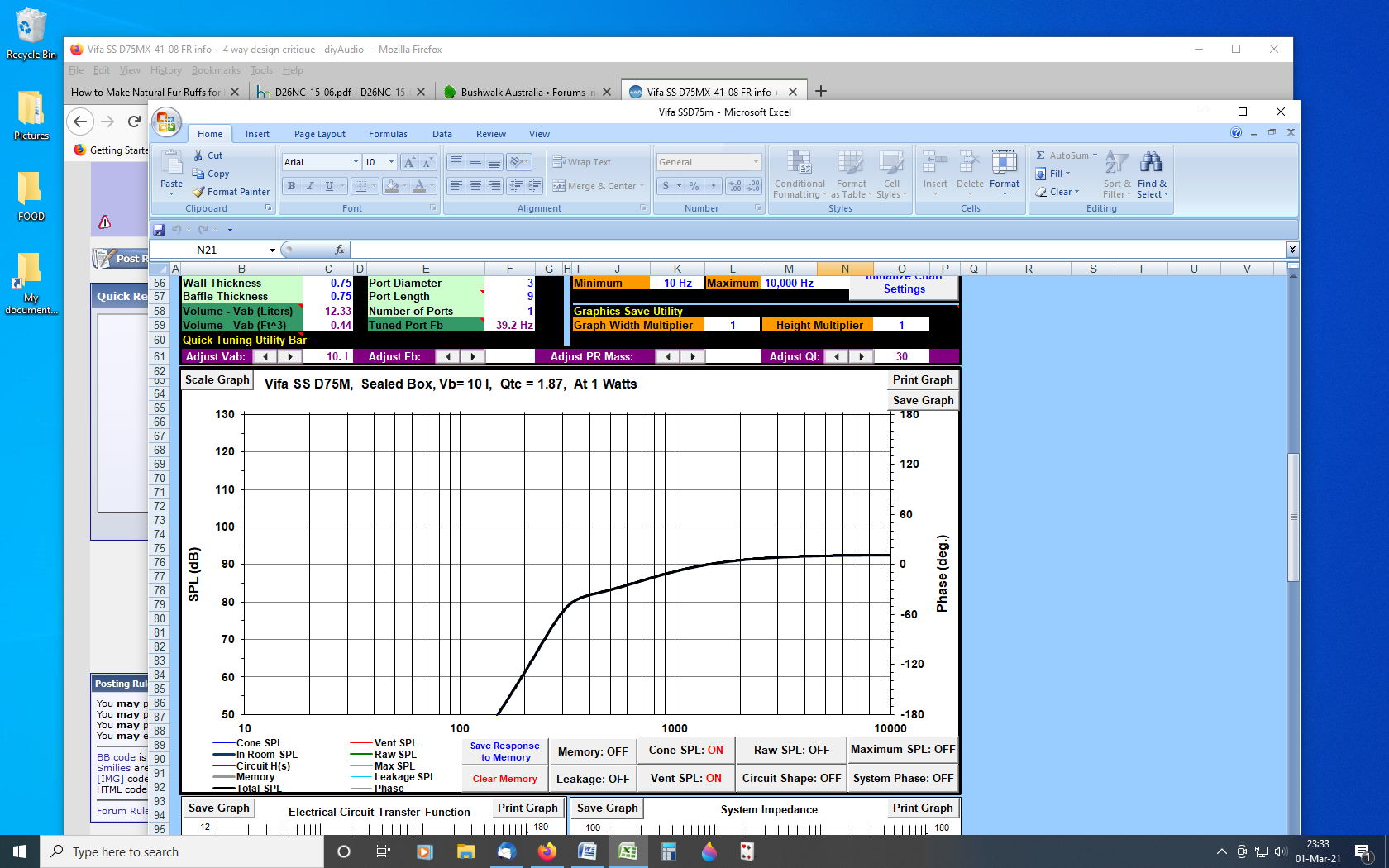

Does anyone have a FR plot of the 3" Vifa Scan Speak dome with an appropriately sized rear chamber on it? All of the published graphs are without a chamber and that doesn't show the full low end rolloff potential to incorporate into the xover design.
I'm planning a 4 way mid field monitor build with these drivers.

Should be easy enough to put the data into a program and experiment with different box sizes, with a Vas of only 0.36 litres but a Qts of 1.73 it needs a big enclosure, Even a 5 litre box seems to give a Qtc response with a big knee at around 350 Hz when put thru Jeff Bagbys program

Thanks for the info Moondog. I could have imported the TS data but I get conflicting results when I measure it in Clio and Larson Woofer tester. Qms tends to be all over the place, even after break in and tends to be very temp dependent. I also have a set of cat558 Morels which aren't too bad, however the THD under 1.3k tends to be a little high for my needs.
The D75 mid dome has a very open sound to my ears and comes across very musical in nature when pushed reasonably harder within it's xmax limits. PMC uses a version of this mid in their 3 way systems and I can attest they sound great in that arrangement. This mid can cope with alot of SPL but it doesn't do well under 1k, so it needs a steep filter in that area if you want to get the best from it.
I was planning on trying a critically damped chamber to bring down Qms a bit without hurting sensitivity just under 800-900 Hz. To aid the xover I want to apply an LCR to flatten the resonance so i can get away with a 2nd order LR HP around 1k. I don't want to use any DSP and plan on keeping the xover passive. A 2.5 way MTM with 2 pairs of mids may be the answer to my dilemma. I could push the 8ndl51 a bit higher, but it starts getting into cone breakup and that main surround resonance kink, both of which I'm trying to avoid. Its a delicate balance having the cone surface area to play loud but stay within the driver's linear operating range. The B&C 8" is a great midbass driver. It has a fiberglass former and copper VC, so it can deal with alot of power without compressing much and at very low THD. 110dB above 150 Hz is a walk in the park for this driver.
