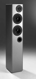

Hi Peter,
I don't if you have already checked out the Vifa Premium designs on http://www.audiocomponents.nl/speakers/vifa/premium/vifa-premium_ned.htm.
The Premium 22XT makes use of two PL14WJ09 speakers and one XT25 ringradiator. The drawings of the cabinet and the components used for the crossover can be found on de downloadable drawings.
Kind regards,
Emiel

LaMa, Emiel, Bill; thanks for your responses. I agree that the XT-25 tweeter will work well with this unit. Although I have used the SS D2905 in the past, it seems priced out of my range.
Emiel, thanks for the steer to the Vifa drawings, I have downloaded the plans and will take a closer look at them this weekend.
Bill, I guess after looking at many 5-5.5" midrangers I have reached the conclusion that they all (Including some which are 3X the price of the Vifa unit) reflect some sort of irregularity in the 1-2KZ area, if you have a specific driver in mind, I would welcome that info.
Again, my thanks for your input.
Pete::)
