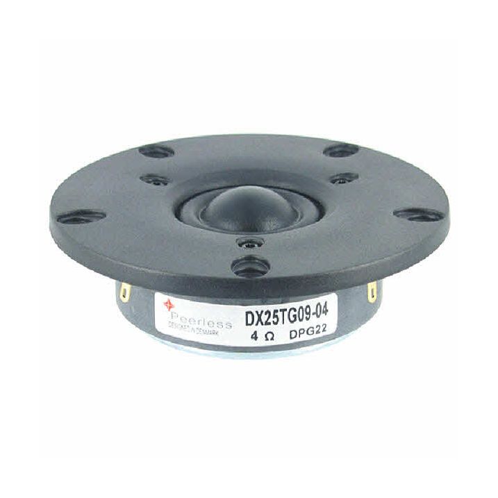

Peerless DX25TG09-04 (second successor):
https://loudspeakershop.eu/pobieranie/dx25tg-59-04.pdf
https://heissmann-acoustics.de/test-vifa-peerless-xd-270-f4-dx25bg60-04/

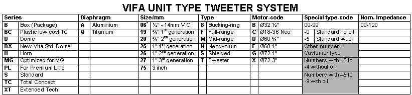

Thank you for your efforts - but this hints don't help - you have misunderstand my question in post #1 - I know all currently available NO-Ferro Versions - even the above mentioned.
I am looking for the type of Vifa's No-Ferro tweeter version in the outline of images from post #1 and not just any from the in post#1 mentioned brands.
this means with extended surround roll and without phase plug.
Because I know the sound character of this old Vifa model (that I had longer in use many years ago) I want to have the same again.
Therefore the question concerning type naming especially of the same.
Look for the one ending on any number between 0 and 4. I think you had some rebranded DX. ASE did that (essentially ordering 500+ units and reselling them). Removing the Ferrofluid yourself isn’t hard (as you likely know). Think the Scan 2604/83 is what you’re looking for, except for the ff.

This seems to be the right model - now obsolete:
https://audio-hi.fi/en/vifa_dx25tg05-04-pd-332.html
https://web.archive.org/web/2013032...avesen.dk/Peerless_HDS830860_files/DX25TG.pdf
https://audio-hi.fi/download/pdf/Vifa_DX25TG-05-04_tweeter.pdf
This was the model, which I had order many years ago - sometimes still available in used condition or NOS

I read in his reply to me this:
The model you are looking for (DX25 equivalent without ferrofluid) is called D2604/833000 (Scan Speak).
The type D2604/830000 uses ferrofluid with low stiffness (low viscosity).
This is the second datasheet in post #1 under the D2604 series.
