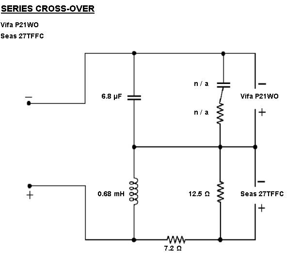

Until I built my line arrays, my favourite speaker was a P21WO-39 + Seas 27TFFC in a weird dual tapered quaterwave pipe.
1st order series x-o of course.
The main hints with the P21 are.... let it breath (use a largish port)...... and don't throttle it with too many x-o components.

Sorry, I don't have the measurements available for the pipe any more. They were on my old 'puter and have disappeared :-(
I remember that there are 2 tapered pipes inside with lengths just over 6' and just under 6'.
I found this x-o diagram, but it may not be exactly what I ended up with. Hope it helps.
