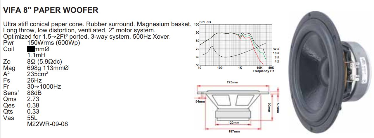

Vifa M22WO-05-08 t/s parameter request

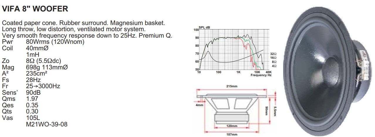

Can't really help but looks like a truncated M22WR (50mm voice coil) but with a M21WO 40mm voice coil and motor (see attached).
An OEM cobbled together of various Vifa parts.
