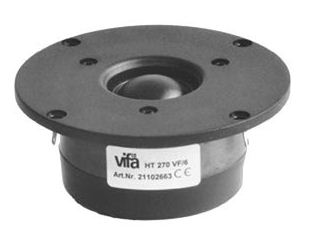

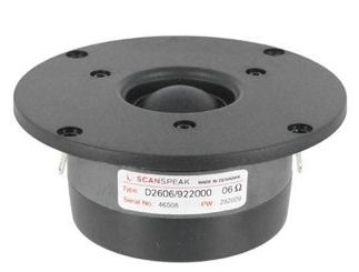

Hi!
Does anyone know the difference between those two, other than the slightly higher resonance frequency of the Scan Speak? I think these tweeters are nearly identical in every other aspect. I just wonder which one to buy as a replacement for an older pair of Vifa tweeters.
Thanks!
Martin

Martin, those tweeter are identical, so you are free to use both of them as replacements for the old Vifa type.
Scan Speak have recently updated there old datasheets, so it seems Fs is changed slightly over the years. No problem.
The Vifa Distributor in Germany, is having his own numbers on the drivers so D27TG-35-06 and HT 270VF/6 and also the Scan Speak 2606/922000 is exactly the same. The funny thing is that this distributer is also Scan Speak´s distributer in Germany. In reallity he could buy the vifa tweeter in both China and Denmark, because he is having his own label on the driver anyway.... It is some time ago now, that the danes were involved in Tymphany, it would be nice to know if the Tymphany China made drivers are still performing as well as they use to....
