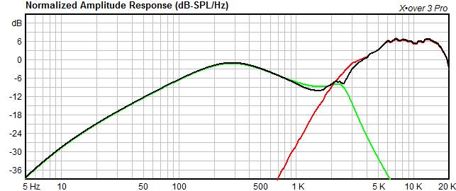

Vifa H25TG-35-06 and the Seas MP14RC/TV
Anyone got any ideas about how I should cross these two drivers?
the Vifa H25TG-35-06 and the Seas MP14RC/TV.
The Vifa is allmost identical to the H26TG-35-06, and the Seas MP14RC/TV should be crossed with a 1mH in series, and a 12uF in Parallel to the Seas.
I think it is a 12db/okt with the crossover at 2500Hz.
I want to use the Seas mp14rc/tv as a Transmission line tuned at about 45Hz.
Any ideas on a 2way crossover would be nice I've tried to cross it with a 1.8mH and a 8.2uF for the woofer. And for the tweeter a 0.22mH and a 6.8uF, but that has a "gap" in the range of 1000-2000Hz
Thanks, Henri

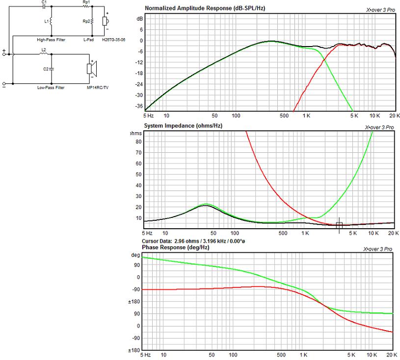

I use Crossover Pro to do crossover designs. One nice feature is that it has a lot of driver data preloaded into it, so you can whip up a crossover in about 2 minutes.
Let's see if I can paste the predicted graph for this:
This is with one driver polarity inverted, like you would expect for a LR crossover.
JJ
All things considered, this is not how I like the final crossovers to look. There is a bit of peaking on the woofer top end that is hard to get rid of without a zobel or other means.
I wouldn't consider this a finished crossover, just a good starting point. I usually build up a crossover on my prototype boards, listen to all my test discs, and then go back and make changes based on what I've heard. I did this over 40 times on one pair of speakers I built.
NOTE--both drivers are connected in positive polarity.
Another note-- this crossover has about 3 dB of baffle step compensation. You might need more, or less, depending on how you plan to use this speaker.
JJ
2-Way Crossover Network
Low-Pass (LP) Filter: 1 required
Type: 2nd-Order Linkwitz-Riley
Desired Corner Frequency: 1800 Hz
High-Pass (HP) Filter: 1 required
C1 = 12 µF, Polypropylene, 0.00521 ohms
C2 = 20 µF, Polypropylene, 0.00579 ohms
L1 = 0.28 mH, Air Core(#16), 0.344 ohms
L2 = 1.5 mH, Air Core(#16), 0.366 ohms
Tweeter
L-Pad: 6.00 dB
Rp1 = 3 ohms
Rp2 = 4 ohms
