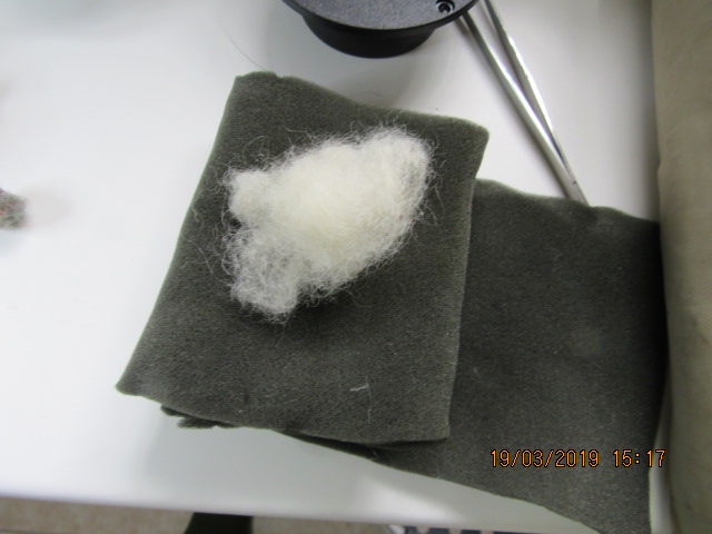

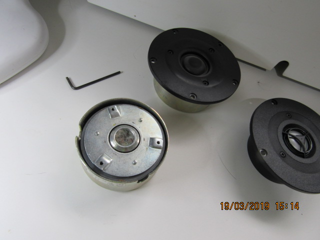

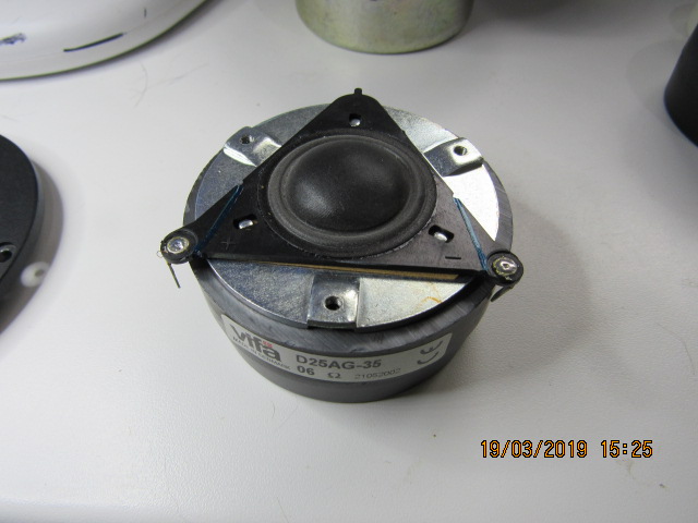

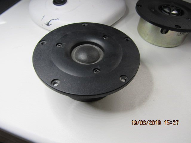

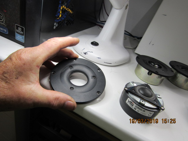

Vifa parts are interchangeable for the most part. So I just spent an hour or so taking apart a couple of pairs of tweeters and making a D27 45 clone.
I took apart a pair each of the old D26 with the aluminium dome and the pair of D27SG15 and swapped stuff around. The domed faceplate from the shielded tweeter was mated to the open backed magnet of the other and the hole was filled with a small amount of long fibre wool held in place with a scrap of UL foam. I also swapped voice coils around as I do prefer the silk dome to the aluminium .
Now all I need to do is see if they sound any better or smoother and if and when I can afford the other gear I'll measure them
