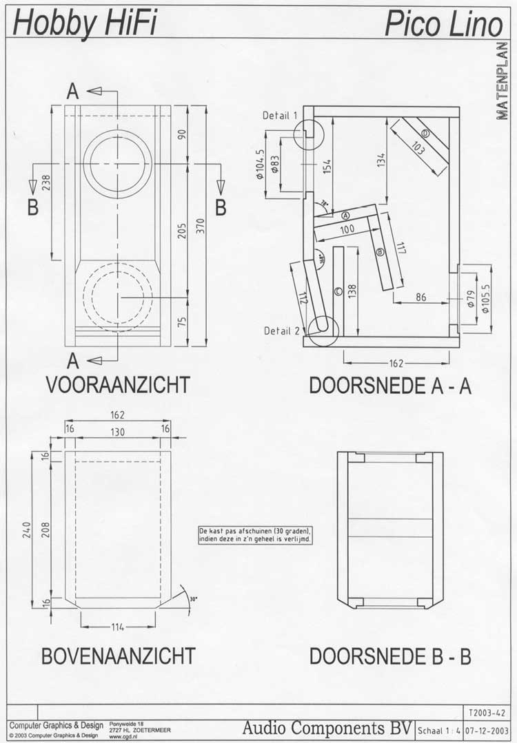

Do you have the construction dwg of the Picolino 2 with better resolution ? I have few TG9FD and would like to put them to use.

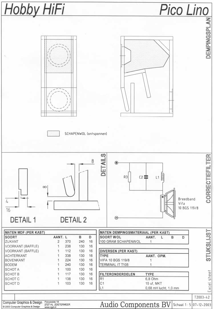

You have to squint to make out the dimensions but it is possible as I had enough info to model it for a sim. It is a nice design with surprising bass extension. Alternatively, print it out and use dial calipers to get dimensions that you can't see.
http://www.hifisound.de/oxid/out/oxbaseshop/html/0/dyn_images/TZ/HOB-3004009.gif
Some values are still very hard to read but with this good resolution dwgs of the Pico Lino (original) I'll be OK. Many measurements looks very similar or are off by 2-3mm, nothing to worry about.
