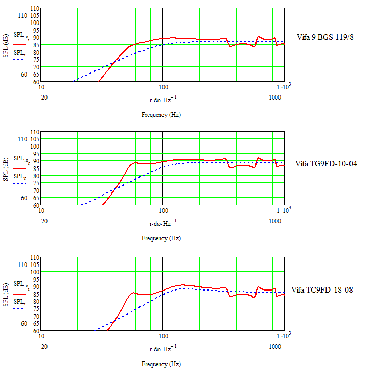

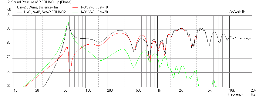

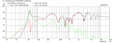

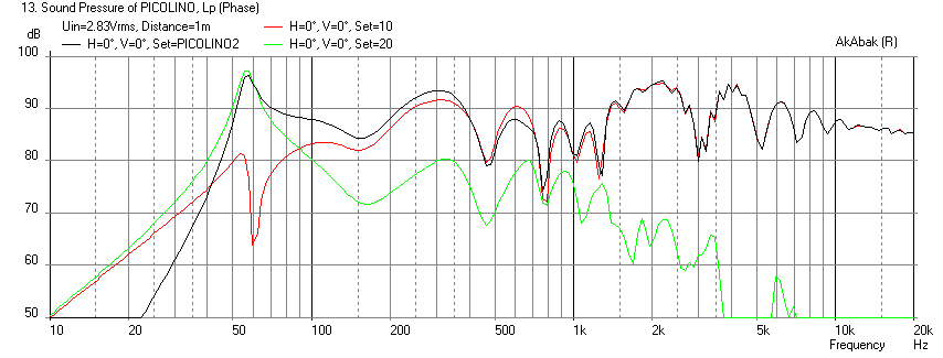

Here is a simulation of the Picolino2 with a 9BGS vs a TC9FD and TG9FD - the BGS is smoother and the TC9 and TG9 have higher Qts so there is a big bass spike - may be a little boomy but not too bad overall.
- 9BGS
- TC9FD
- TG9FD
all 16 in away from back wall.
- 9BGS
- TC9FD
- TG9FD
Update on alternative to Vifa 9BGS. It is a unique driver: I have tried many other similar drivers in the sim but nothing works as well - so obviously the Picolino2 is really optimized for this driver. You might try adding a lot of stuffing or use a thinner material for cabinet to help absorb that high Qts bass peak. I tried the following drivers and they all had a bass peak: Visaton FRS8, FR10, Tang Band W3-315e, W3-881si, Fostex FF85WK, Dayton ND-90, Peerless 830986. The TG9FD is probably the closest performer to the original.
It's a fairly straightforward ~20:1 TQWT.
Of the Vifa units, the TG9 is closest if you can't get the design driver. Damped out you'll get the attached (1/2 space). However, what the bald FR sweeps don't tell you & what is often ignored is the rocketing (read 'chronic') harmonic distortion. So beware with the volume knob.

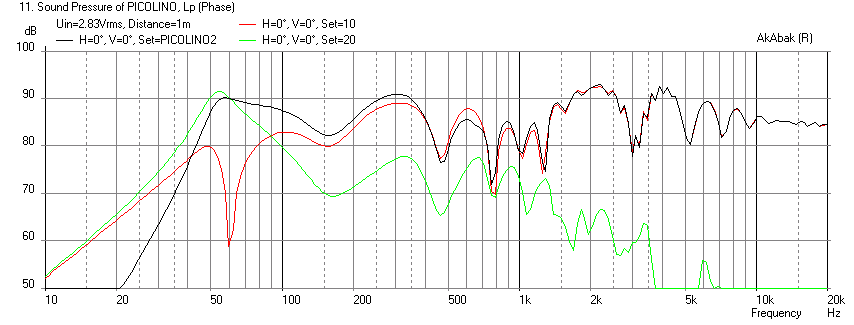

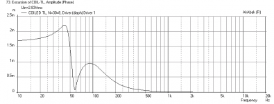

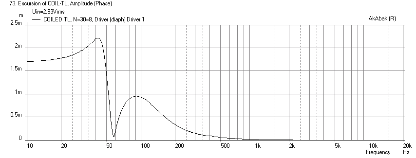

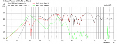

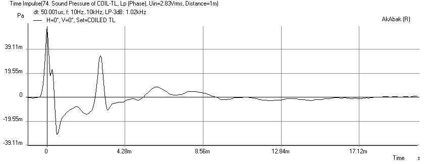

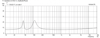

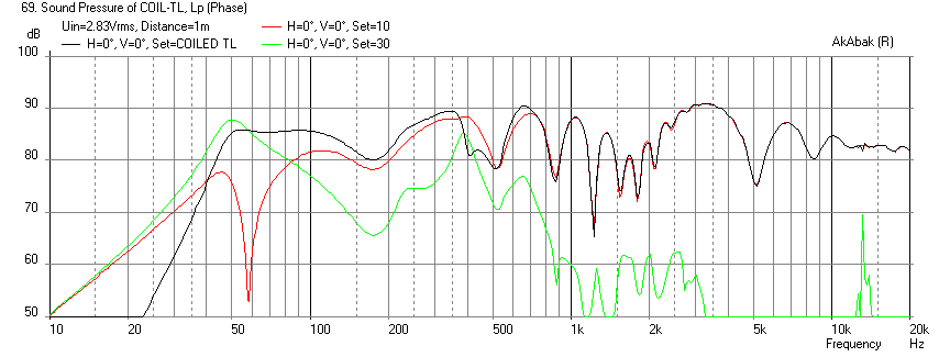

Here is the sim of the "Pile of Boards" or "coiled TL" as I call it. It actually looks pretty nice - and has good bass response down to 50 Hz for the very inexpensive FR10 driver. I put stuffing to damp HF up to the 3 turn (the turn from vertical downwards to the right after the driver).
The sim used the dimensions from this plan (with 100 mm width of TL channel):
Plots:
- Freq response for speaker placed 8 in away from back wall mic at 1 m
- Impedance
- Driver cone displacement
- Impulse response
Summary: a well-balanced enclosure with good bass, well controlled cone movement, decent impulse response for OK group delay.

The freq response curve is SPL vs frequency (the distance the mic is at is in the graph legend) and the black curve is the overall output, the red is the driver direct sound radiated, the green is typically the vent/horn output only.
The next plots typically are the electrical impedance of the driver, the driver cone displacement in mm vs freq, then sometimes I show the impulse response which gives you an idea of the group delay - you want to make sure that the main secondary pulse is < 8 ms otherwise there will be very noticeable time delay effects from say, a kick drum sound, happening way after the initial punch from the direct radiator.
Hope that helps. 🙂
