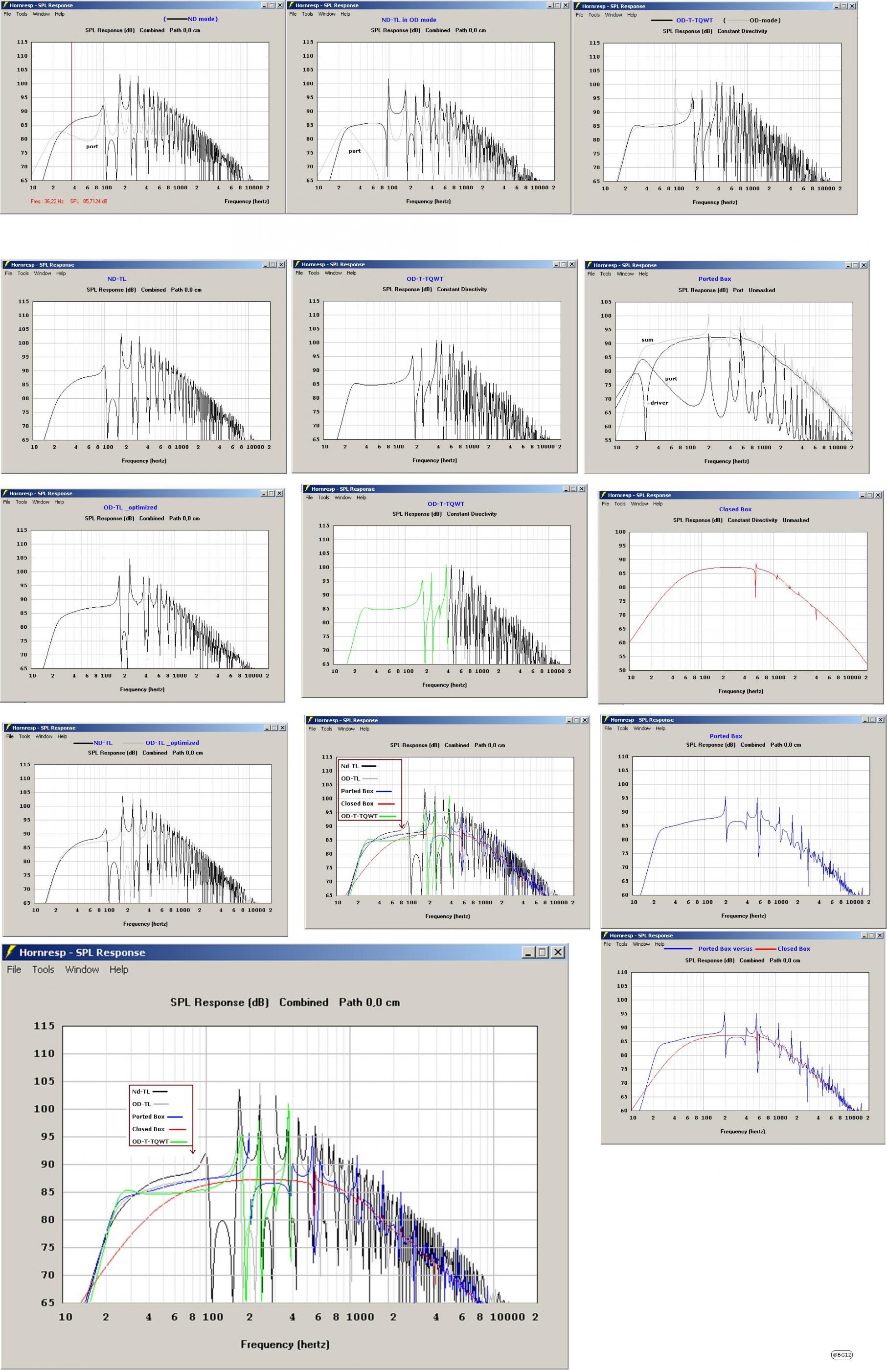

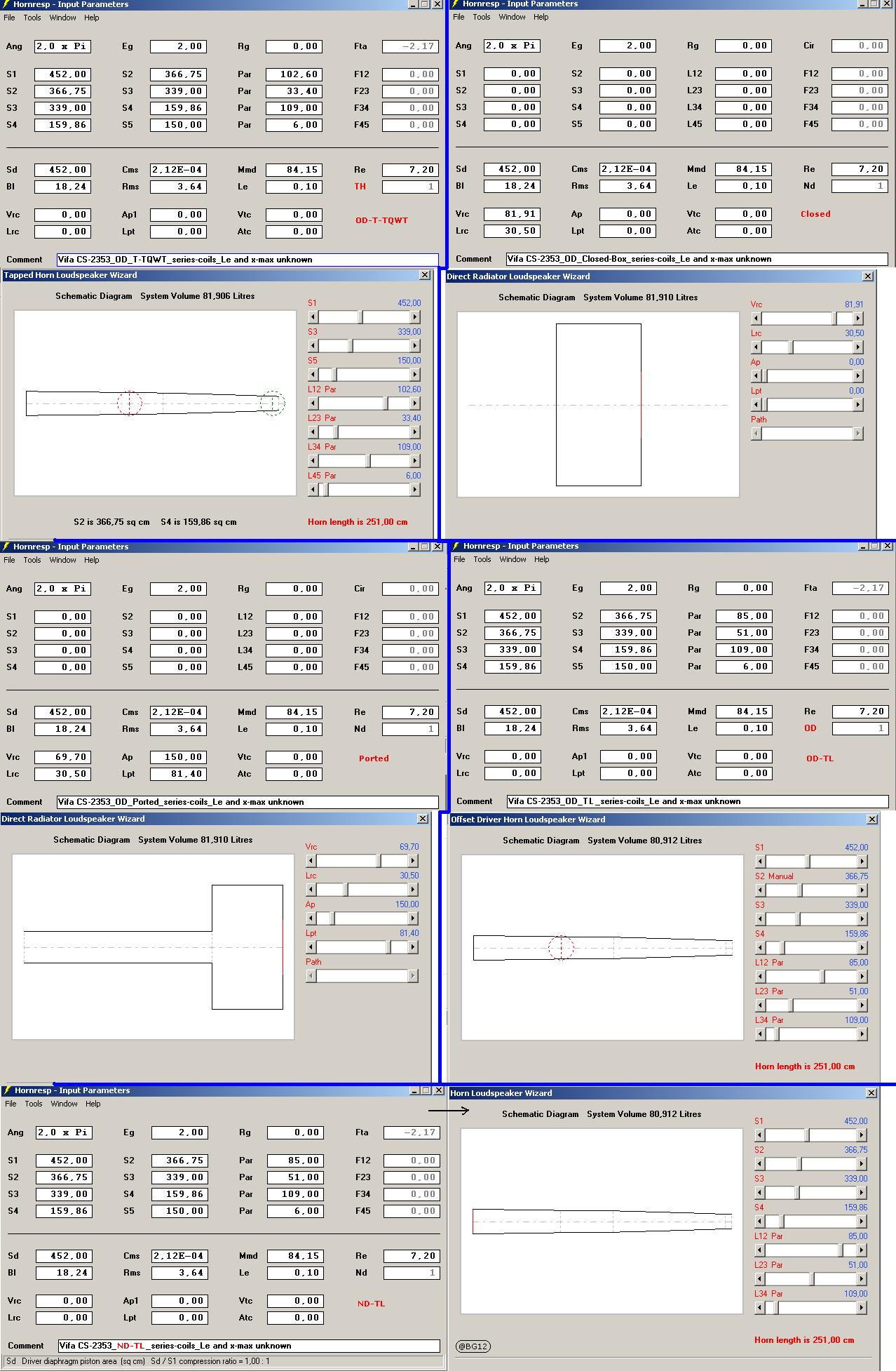

Bit confused by the design... from what I can see there is one small outlet in front of the drvier? a big gap behind the driver but no way for the sound to get out...
Assume this is to create some kind of base loading internally?
Yes, There are many ways to design a Sub... Performance-wise they are different though.
b🙂
Thanks bjorno... I had a bit more of a play with Hornresp last night (still struggling to work it out) but looking at the design again it looks like a regular TH with the S2 moved a fair distance???
