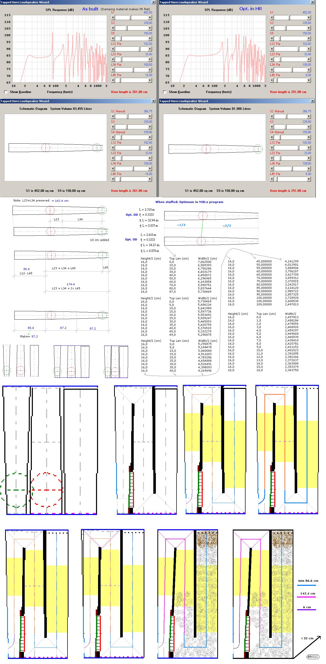

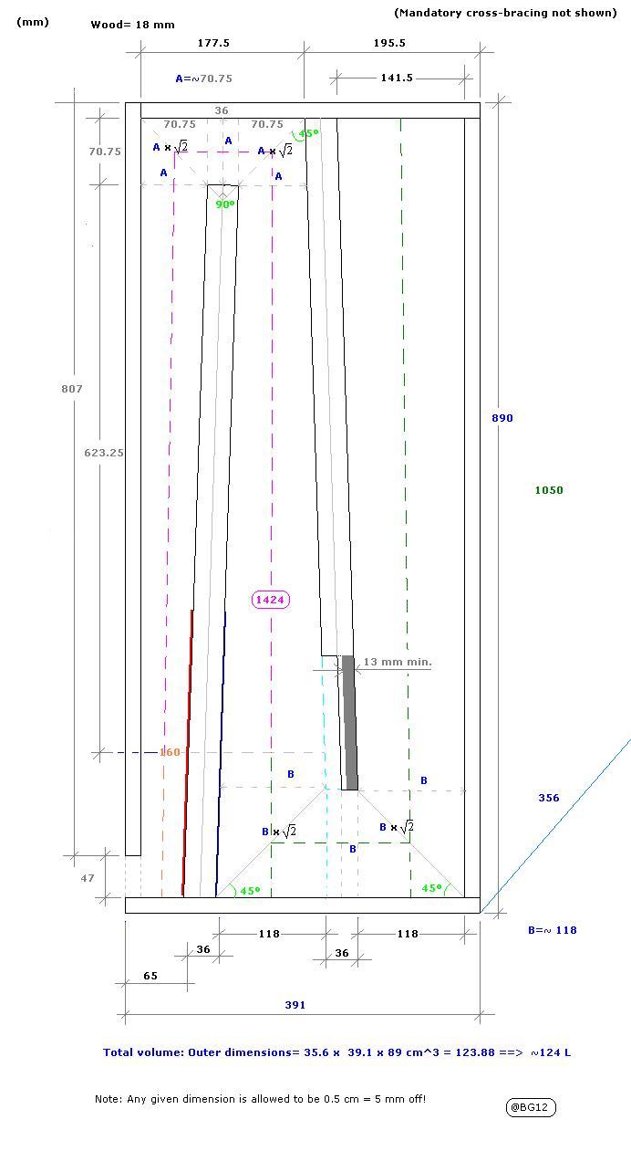

Hi shporsche,
FYI, See the first picture: A 'Wolksvagen' BR and compare with the 'Porsche' version: a T-TQWT in the next picture. 🙂

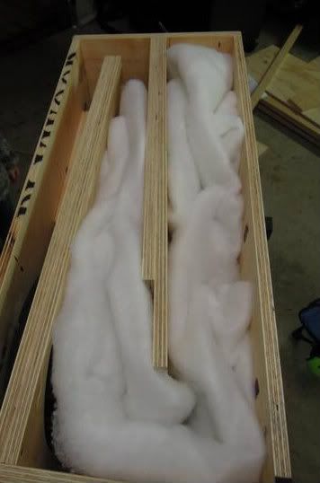

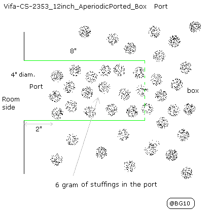

Hi shporsche,
Forgot to mention the need for stuffing’s in the port: See the picture.
It’s not much but some is needed to reflect the MJK simulation and IME best done by trial and error.
Sometimes a similar satisfactorily result is achieved by omitting the port stuffing and just pushing the box stuffing’s to slightly obstruct the inside of the port.

A bit of thread resurrection here...
I have just purchased a "VIFA" CS2353 driver and have been researching how best to use it and came across this thread.
I have a couple of questions that i hope can be answered.
a - What advantages would such a design have over a ported box that i am more familiar with.
b - It is not clear to me what the dimensions of the cabinet are, are all three images related to the same design?

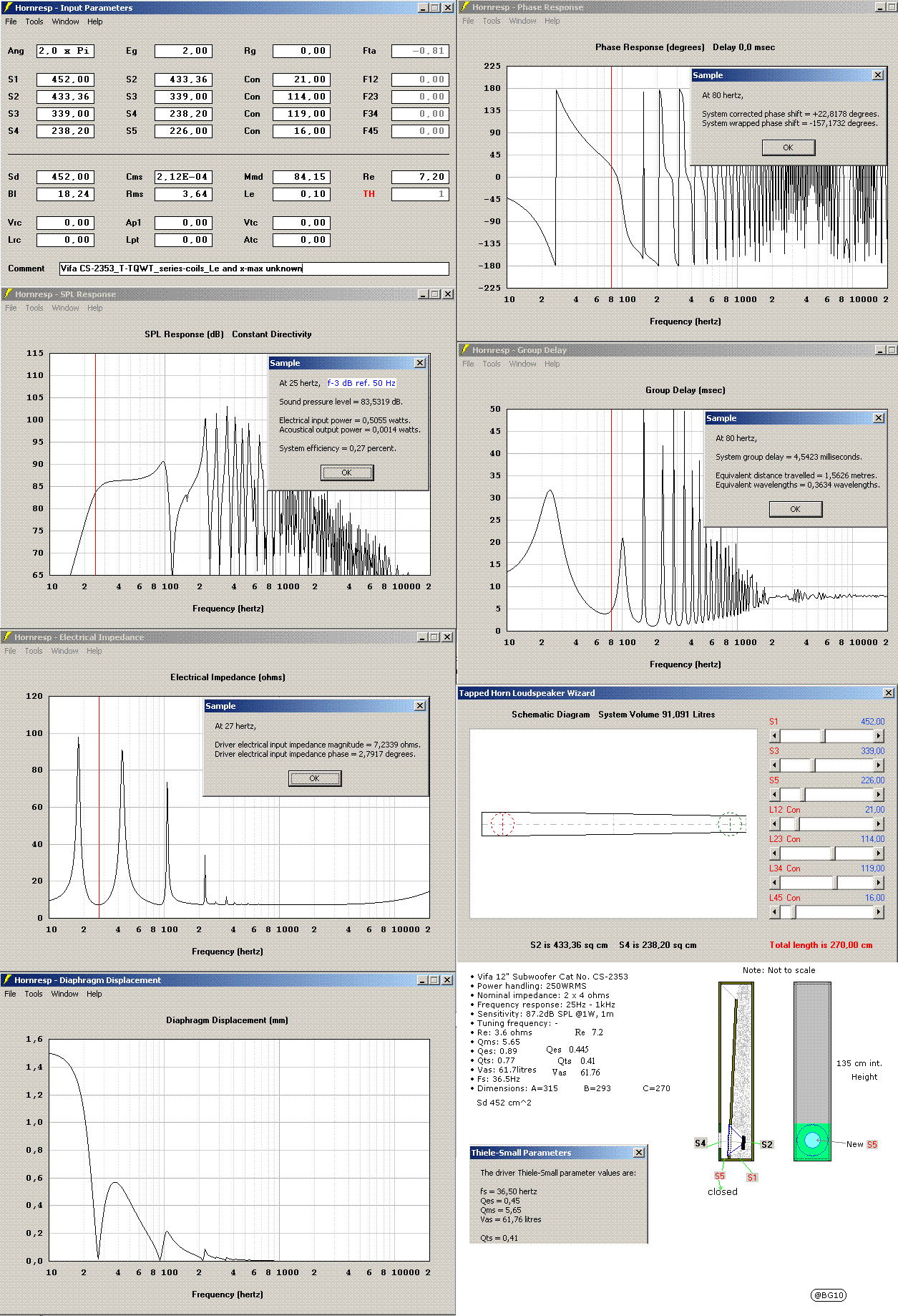

Ok so i have been doing some research online and now understand the T-TQWT approach, I am now more interested in the design, seems a more elegant design than a box and some pipe!
I have downloaded hornresp and with a view to replicate Bjorno's findings so that i can start to dimension the enclosure.
Build thread to follow hopefully
Ok - so i have downloaded Hornresp and have inputted the data and can see how Bjorno got the outcome he has, alothough i do not understand the theory ebhind it, but can replicate the numbers he arroved at...

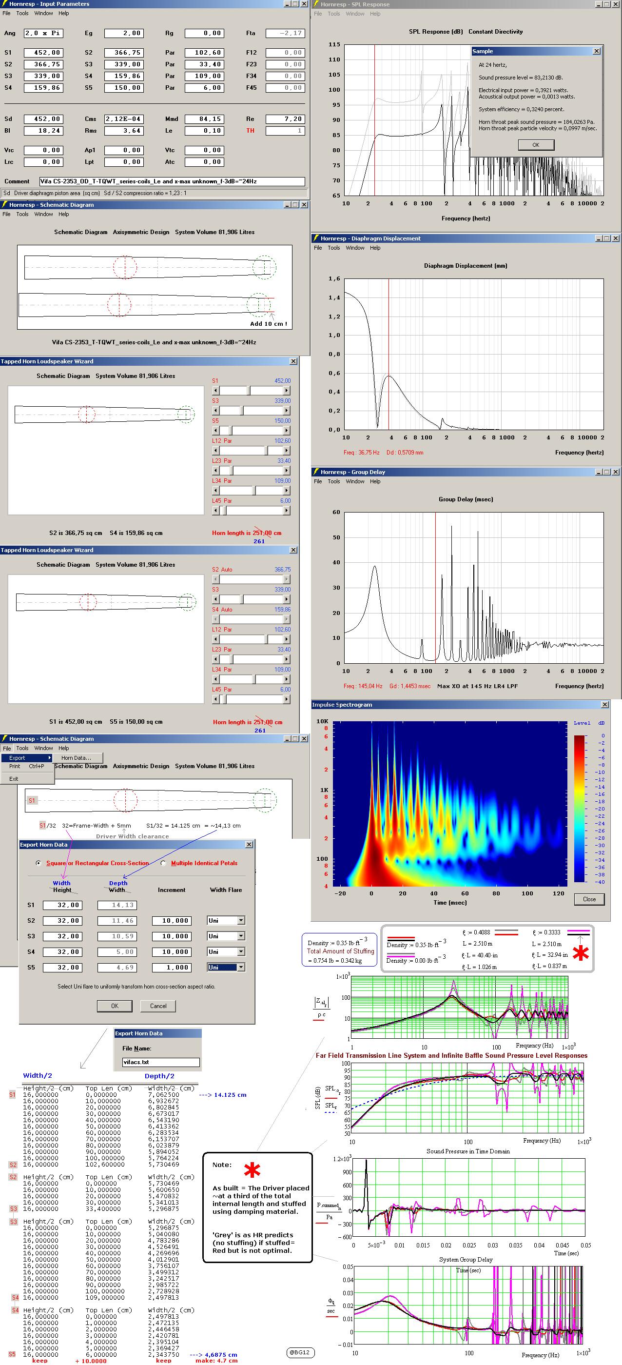

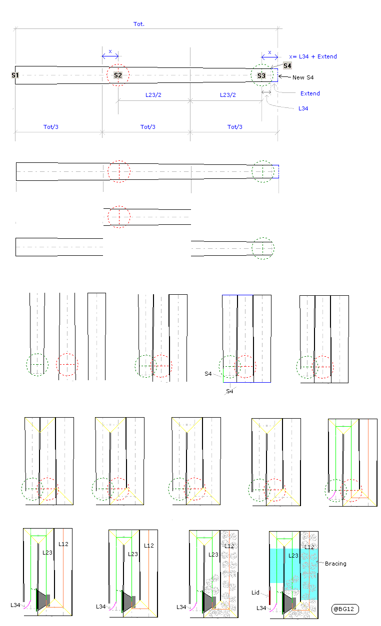

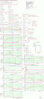

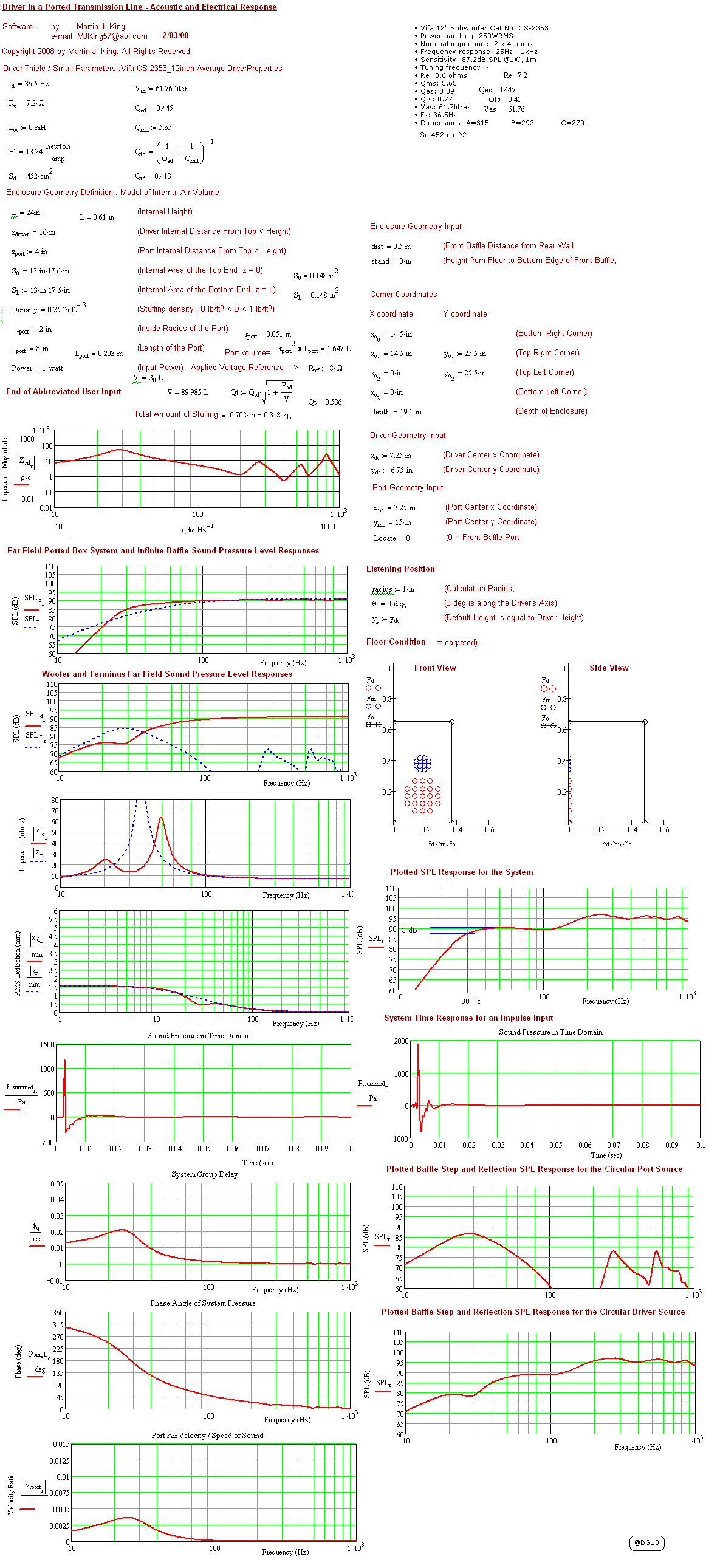

Hi MG,
We are using HR to simulate T-TQWT's but as this sub should be stuffed with damping material from the closed end half-ways down the line:
You need in the real world to adjust the offset predicted by HR.
This is done using MJK:s program.(The first of pictures).
The second picture is showing a step by step approach on how to do a double fold. Note only 4 sections is used, HR can use up to 5: So re-labeling is necessary if to be used for a 4 section simulation.
b🙂

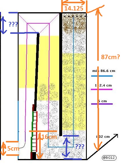

Bjorno - thanks for your comprehensive response. I have spent some time to understand how to construct the enclosure and am getting stuck.
i have gone down two paths...the first;-
in trying to work out the height of the enclosure the L23 length seems very short 30.4mm - perhaps i am reading it incorrectly but my understanding at the moment is that to get the enclosure height for one fold i need to calulate as fllows X = 10cm + L34 - - 100mm + 109mm = 209mm or 21cm This seems very short to me.
I then try to use L12 which is 102cm - closer to the the 'width depth' table.
The second:-
is that the 'width depth' table has all the information i need to build the cabinet - except that the overall lengths for each of the folds seems to be different - 102.6cm - 109 cm and 16cm...
Either way i am lost...
The bit i do get however is that the enclosure will be 32cm wide (plus watever thickness my wall material is)
Finally (for now ;-) ) - Would a good quality 18mm ply be a suitable enclosure material?
Thnaks for your patience..

Hi Mark,
My answer: Yes and Yes.
Before I start answering your other questions: I've submitted a new picture that might bring a better clarification on how to fold:
b🙂

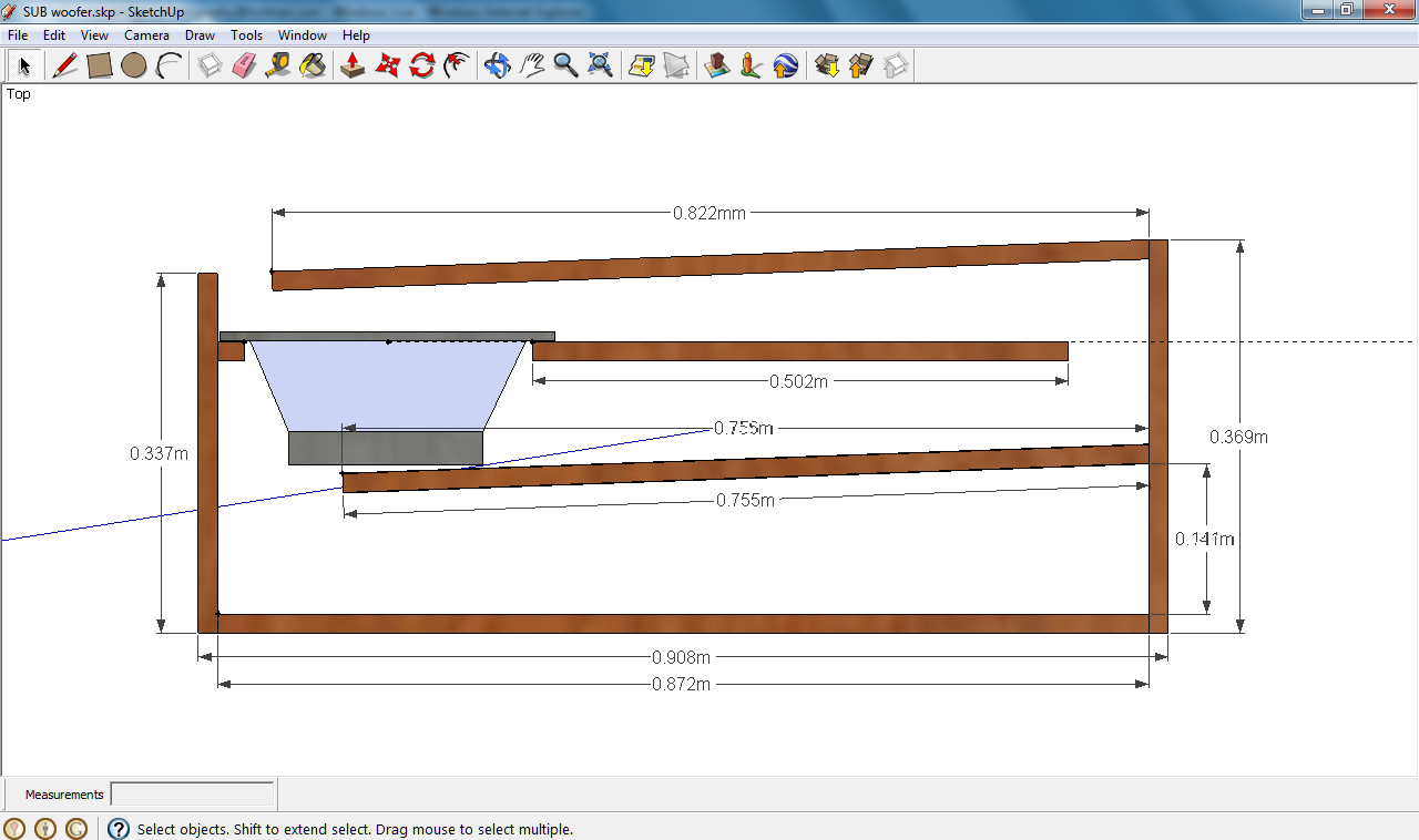

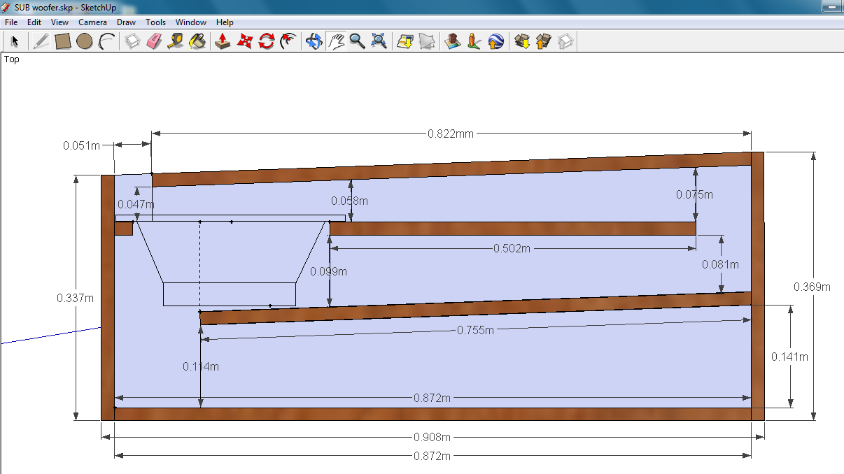

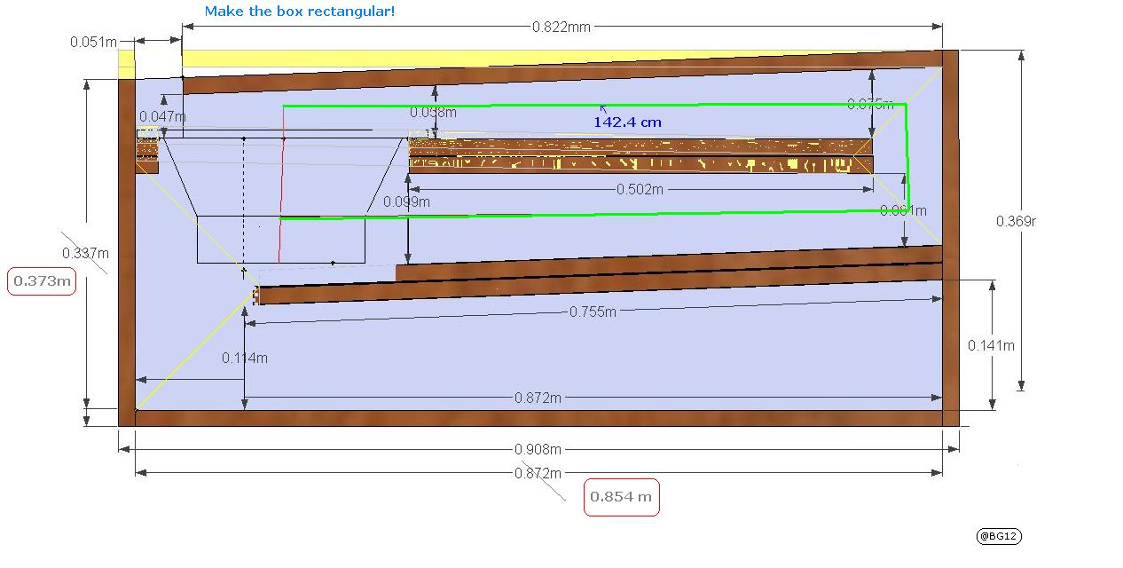

I have been away on business for a week or so, in the time i had spare i have come up with the following - I think i may need a little more 'direction'
what i have got to date -
The centre point of the driver is mounted 'L45' from the bottom - 16cm - giving just enough clearance for the driver.
The start of the taper is the 'top right' 14.125 cm's narrowing to 11.461 @ the bottom of the right taper.
the port slot is s4 - 164 sqsm 32x5.125 = 164sqcms...
Attached below is a graphical representation of the above, along with a couple of unknowns.
OK, i have learnt how to use Sketchup to devlop the box design from a tutorial on another site, I hope i have it correct.
The problem i now face is that there does not seem to be sufficient clearance for the driver to fit.....
Can someone check i have translated the information in to the cabinet design correctly, any thoughts on how to get the drive to fit would also be appreciated.
The driver is 314mm wide - requires a 270mm cutout the magnet is 145mm wide and 17cm from the top face of the driver
updated with more dimensions
Hi, Here is an quick attempt to solve the driver clearance:
b🙂
b🙂
Hi, Here is IMO a better picture:
b 🙂

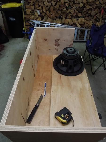

which vifa model subwoofer you buy?
The model Number is cs-2353 brought through a large national retailer in NZ called Jaycar.
After some research it transpires that it is a chinese copy of the 'vifa' branding and not from the european brand Vifa - although it looks very convincing...

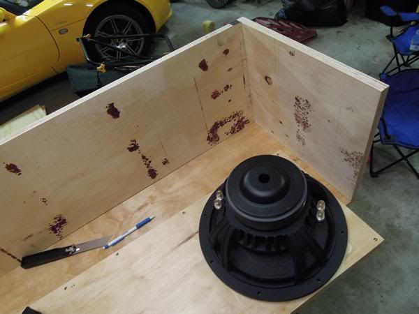

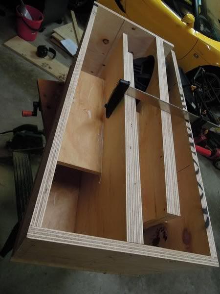

That said, I built the cabinets over the weekend and conducted some preliinary listening and break in - initial impressions are good.

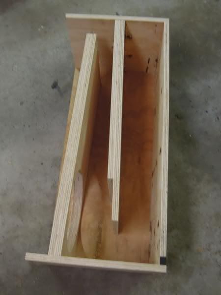

Images of the constrution to follow.
