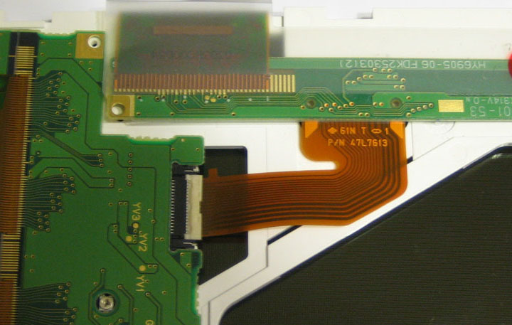

Hi, I've got a LCD which is almost exactly the same setup as Billeb's posted picture. Here is the lcd on my laptop, which suffered an inverter failure. The problem with this panel though is the circuitry boards behind the LCD glass, which will not swing up and clear due to the attached cable. This is the FFC cable, is it not? I have been wondering whether it's possible to extend this if I could determine the actual pinout and come up with a replacement; my question is twofold.
Is the white connector meant to be able to easily separate from the circuit board? That would be extremely helpful, and possibly then http://www.diybuildergroup.com/store/lcd/index.htm these might do?
The second question is: By my count of the dark bands, this is a 15 pin cable. The problem is most of the extenders are of even multiples. The metallic pins number 18 on the white connector. Is this a so-called ZIF socket, zero insertion force? And can I extend this damn cable without cutting it up and soldering, though I must say I would have no clue where to start, since this doesn't seem to have conventional cables?

Yes! Figured one problem..
I'm silly, I just figured out how to detach the FFC cable from the side circuit board to the main board. The white connector actually flips up like a hinge, which was TOTALLY inobvious (ok, to me I was wondering how the hell to simply pull it out, not up..) and I tried just for fun. Now that I am able to swing the circuit boards up and away, I have an 18 pin cable which begs to be extended. http://www.mouser.com/catalog/620/901.pdf
Which type of connector extension would best be able to *solderlessly* attach to the now bare FFC cable? The white connector and the black connector apparently are just the upper and lower half of a hinge, and I can't seem to see any likely matches which would connect the bare cable to the hinge. I'll attach a photo to explain later.. now I should earnestly start watching Ebay for projectors..

I finally realized what he was talking about in terms of solderlessly connecting FFC cables. The socket C of FFC connectors technically should be soldered onto a circuit board somewhere, but it can be used as a makeshift extension to FFC cables by simply inserting them in the same way, contacts facing each other, and mashing down on the "actuator" leaving no solder anywhere. This solves one of the last remaining problems I've had with this laptop-lcd-projector business, and I can now think about choosing either to refurb the laptop with an Ebay'd lcd panel, or turning into a projector.. The price seems about the same... except somehow I suspect the projector project would cost me some money here and there in the constant upgrade path...
Of course, all these revelations occur to me and no moderator has seen fit to allow my posts.. I hope what I've said is right, and this clarifies some other people's fears of using previously shunned FFC shackled monitors. Because really, it's like a 10 dollar fix if the connections are standard sized ish. http://www.mouser.com/catalog/620/901.pdf
Connector C is where you'd jury-rig the solderless connection, simply by placing two ffc's when there should be one, and making sure the contacts are made...

there is place enought for two FFC into one ZIF?

FFC extensions
It worked fine for my FFC cable. Maybe it won't fit two very thick cables. I recommend the vertical SMT connector, because it has a plunge closure. The horizontal connectors use a hinge which may not be so secure with two cables.
I also have an FFC extender from diybuildergroup. It has one male end and one female end, so you can just add it like an extension cord. I don't know if the other DIY projector stores have these.

"it has one male end and one female end"
Could you exlain it?
it is a female--female conector + male--male cable the kit from DBG?
this female---female conector should have 2 inputs, one for the new ffc and one for the old ffc on each side. Is this correct?

FFC extender
yes, it is exactly that: A female-to-female connector and a standard male-to-male cable either 3 or 6 inches long. You use it by plugging your LCD's existing male cable end into the F-to-F connector. Then you plug the male end of the cable into your LCD's socket.
This is more universal than just getting a longer male-to-male cable because some LCDs have only one end of their cable socketed. The other end is glued.

yes i understand now. but just wonder, there a 2 kinds of FFC (most important difference), A type and D type. A type has the conectors on the same side, while D type has the conections on the opposite sides. what type is DBG's?

DBG FFC extender
Then it is a type A. The cable looks just like a standard Molex single-sided 0.5 mm pitch FFC with conductors on one side and a small bit of blue plastic on the other side, an each end of the cable. The female-to-female connector consists of two horizontal mount SMT ZIF sockets, with their pins soldered together, mounted on a small piece of clear plastic.
If JCB made it himself, then he could work as a professional electronics assembly tech. If I had to guess, I would say it was done by a contract assembly shop.
Here is a scan of the 16 pin version I have. The ZIF closure parts are not pushed in, so you can see how they work. The entire assembly you see here is 15 mm across.

well, its cofussing yet.
someone told me he bouth from DBG the extension kit, but was not this dual female conector adapter included, just there was 2 zif where you could clamp two ffc facing the contacts as lumenlab kits do.
but guy grotke says he bought from DBG recently as well, and that dual female conector "factory made?" was included.
now, who is wrong? is it that different pins (16 ,18, 20...) has different items? guys pic is for 16 pin extension...

who is wrong?
Nobody is wrong! JCB used to sell the single ZIF socket and male-to-male cable. But some time ago he had the double ZIF socket female-to-female adapters made. Now he sells those in his FFC extender kits. You get one female-to-female adapter (as in my picture) and one standard male-to-male FFC cable.
JCB had someone else running the product shipping for him up until a few months ago. (He does have a full-time job!) Then the problems became too much, so he fired the shipper and started doing it himself. I think it may be working better now. I ordered a first surface mirror from him about 3 weeks ago, and I had it within one week. I think the only complaints remaining are from people who are waiting for JCB to send them free stuff as compensation for past shipping problems.
