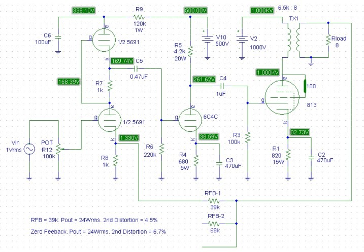

I like this 813 mono block Ampli because I'd like to do it by FU13 tube. Could you please give me the schematics of this?
Thank you very much
Best regards,
thomas-Ngu
Hi Mr. Thomas,
Attachment is 813 SE schematic, designed by Mr. Dztronic, I never built it before but you can try it. Good luck !!!

Dear Mr. Macao,
Thank you very much for your full support, I did download your schematics. This is my big project!
Can I replace the 813 (USA) by FU 13 (China) tubes, 6C4C by 6Pi3C? And is the 5691 same 6H8C tube?

soundbrigade said:
6C4C is a 6B4G and 6H8C is a 6SN7.
Hi Thomas,
As soundbrigade comment, you can replace 6C4C by 6B4G or 6A3 but 6C4C is cheapest in all of them, 5691 must be replace by 6SL7 - 6H9C tube type. If you have any idea to change tube in preamplifier or driver stage, please direct contact to Mr. Dztronic.
Best regard.
