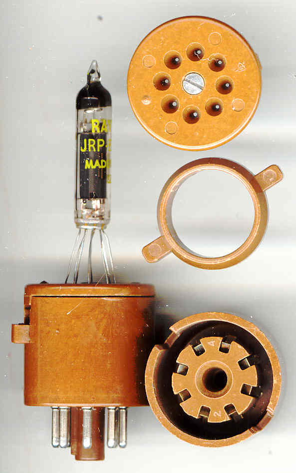

Sylvania made some ZIF tube socket adapters (to Octal) for these 8 wire sub-mini tubes. (pic below with a Raytheon 5902)

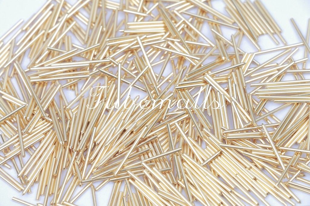

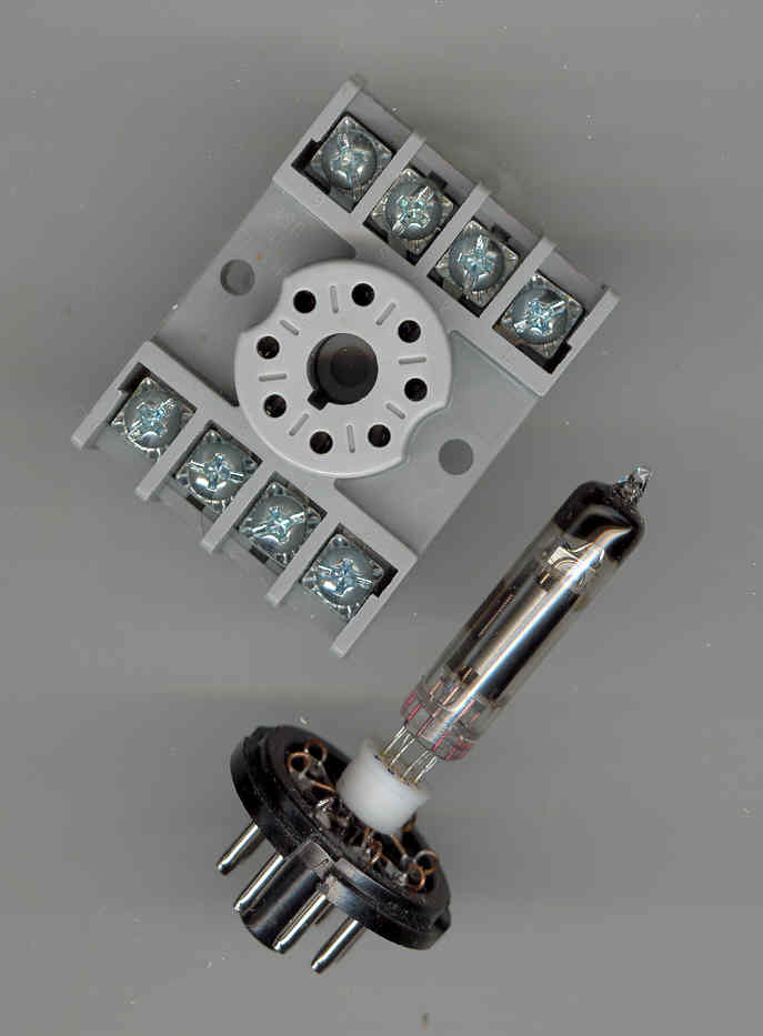

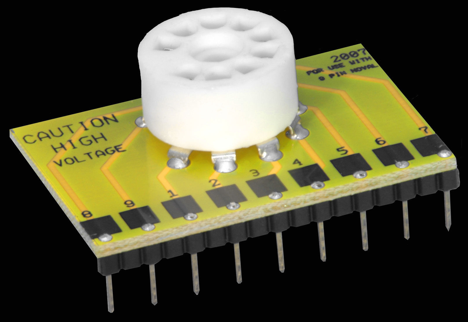

The other type of socket I have used for these (for curve tracing) are the 8 pin Augat Teflon IC sockets. (pic below on Octal wafer)

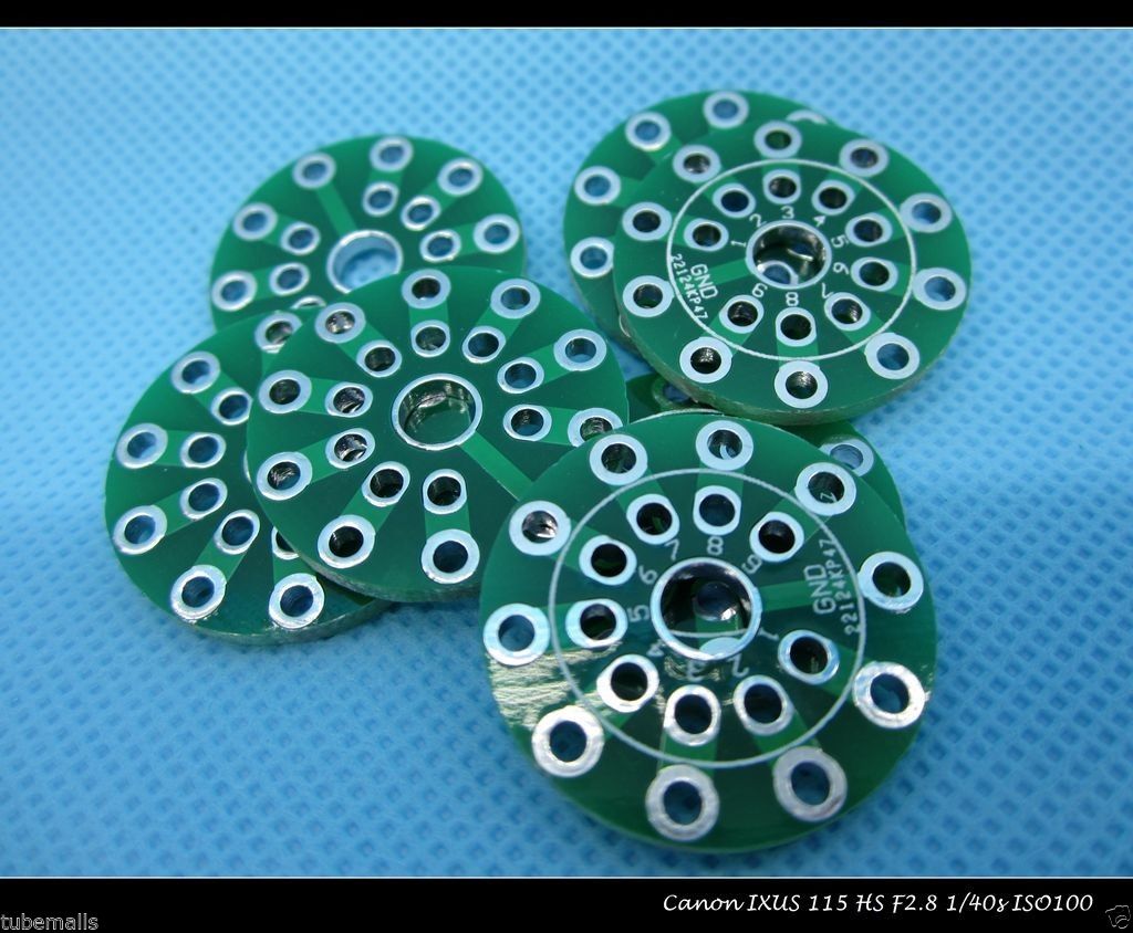

And there are some adapter wafers and pins on Ebay that would allow converting the sub-mini tubes to 7 or 9 pin miniature tube sockets. (pics)

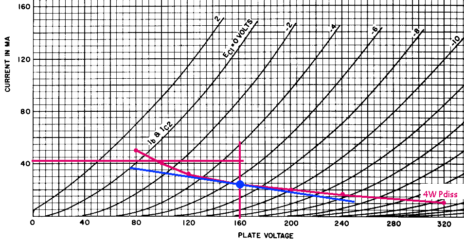

...I saw plate dissipation and figured maybe an output of a watt, in push pull,...
I get 0.6W triode SE, 160V 25mA 6.4K load. There's no huge peak current available so push-pull may be 1.2W.
OTOH as pentode there's near 1.4W in SE, perhaps a monster 3W in P-P. And if you are thinking guitar amp, pentodes ARE rock-n-roll.
