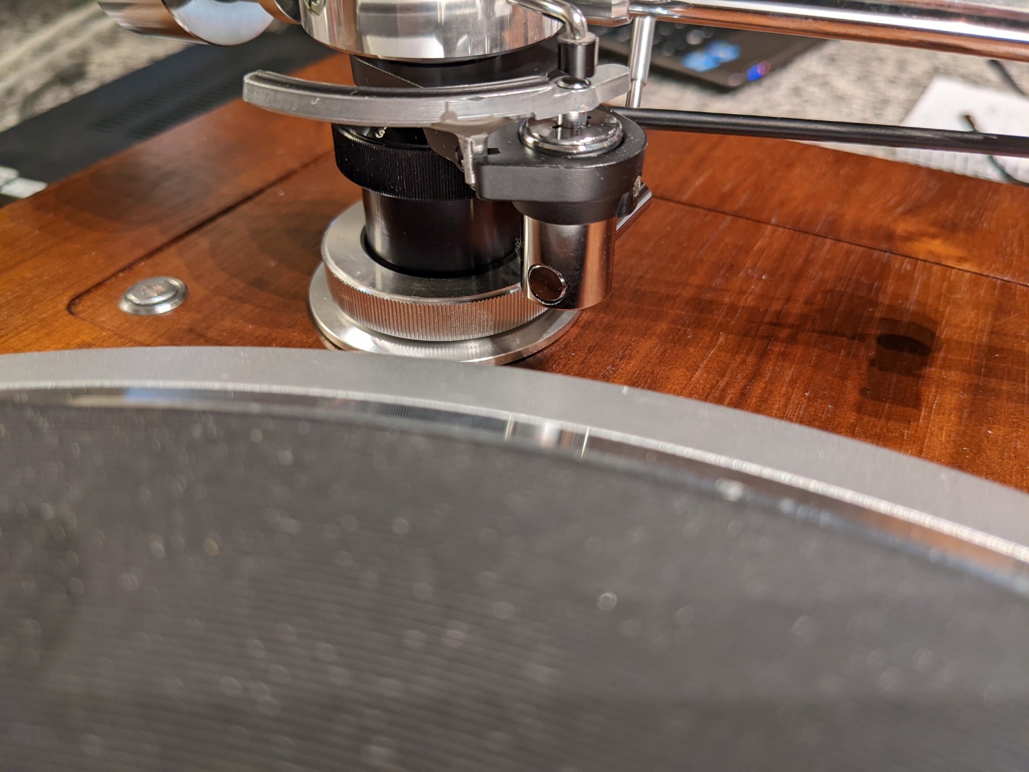

My Victor tonearm lift bar thing as a crack in it like the one pictured, not as bad fortunately. If anyone has one to spare please let me know! I think the 5045 works as well.
I had one fail in almost the same spot. I used JB Weld and it worked well.
Once cured I had to file the glue blob just a bit to make it fit into that notch on the black metal below when cue is lowered. No big deal and I have full travel range.
In any case good luck with your fix.
