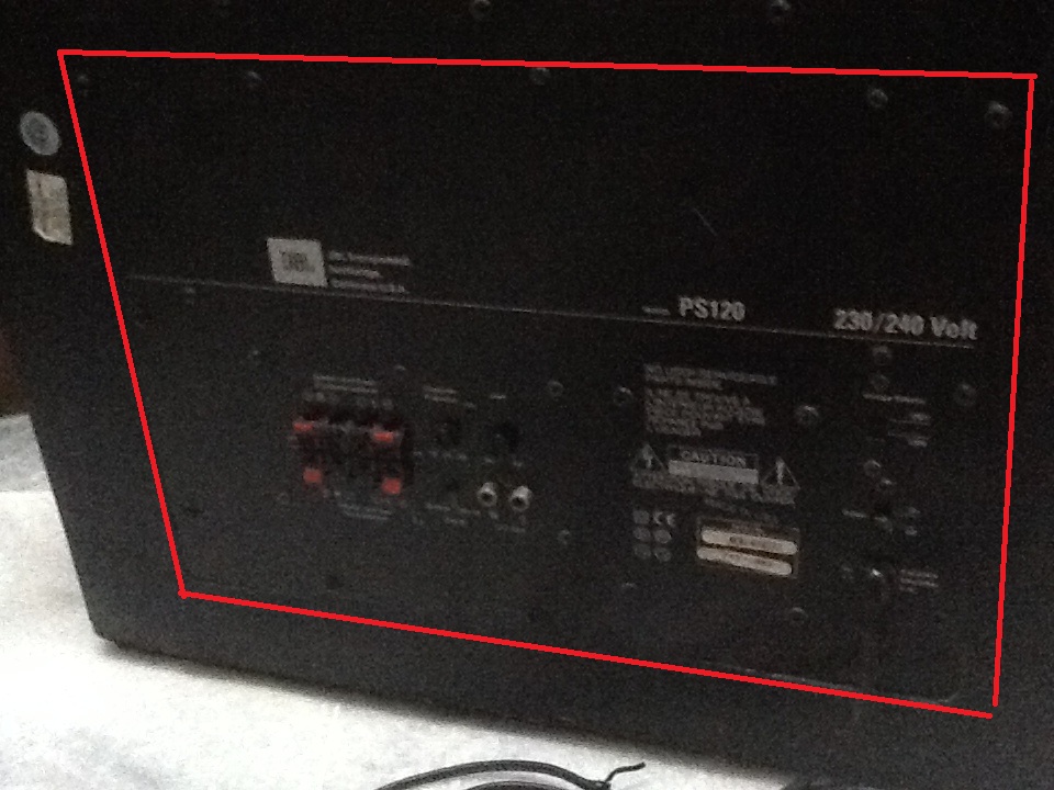

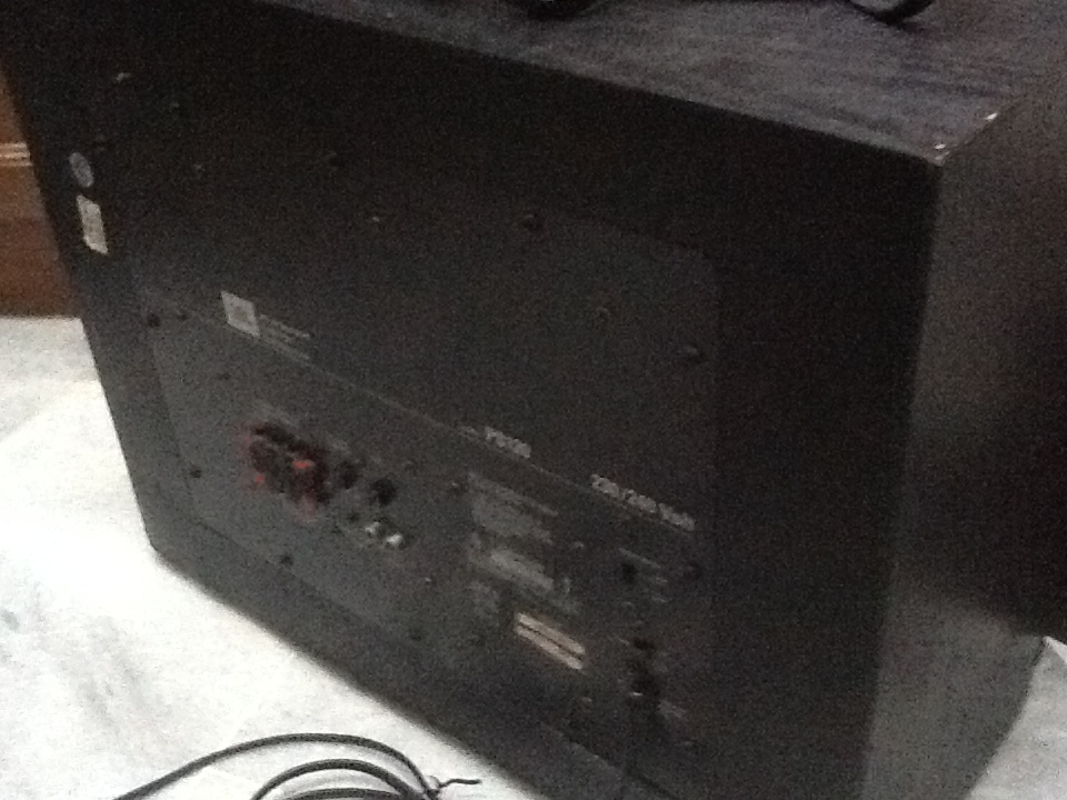

I got a very old woofer unit, JBL's PS-120 😀
This speaker only produce low frequency, range 200hz and below. But it has a fatal problem now ( didn't really notice when it started):

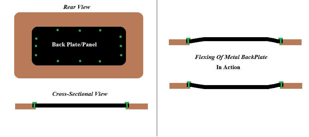

When the bass is very strong, the back panel (removeable steel portion, mark with red frame in picture) which has all the circuit attached except driver, it refuse to stay as a flat piece of metal, STARTED to flex back and forth with the speaker cone :c_flag: This make a loud noise that annoys me. :redhot:
The noise can be reduce to very low level with my hand press strongly against the back panel, but then I wouldn't able to sit down and enjoy my music/video. 🙁
Beside, I couldn't supress it with the strength of hands only 😱 I need to use my body weight with my hand to reduce roughly 80-95% of the vibration noise.
So I'm seeking helps from forumers which have knowledge, experience and wisdom to solve this problem.
Just as extra, I open the back panel before. Maybe due to its old age, it ceiling's soft material aren't stick to it (half fallen) would it be much effect on the sound ?
Or should I say repair/replace it will brings me any benefit of SQ ?

Sounds like this is a sealed and not ported sub. Sounds like the rear panel (with amp) is flexing as the air is shifted. I would have thought that if the seal around the amp plate is broken, that this would have made the pressure escape and not flex the panel. Is the panel made of cardboard?
Yeah, it is a sealed woofer, so the amp plate easily move with the cone.
Anyway, it doesn't have any seal around it, just screw directly and side mates with woof/MDF material directly. The panel is made of metal. (normally plated steel I think)
I don't think the steel plate will be flexing, more likely the screws will be loose.
I had rescrew it, make sure it doesn't cause the problem, but still persist. But the thingy I'm sure is that it doesn't have any rubber seal/ring that make it vibration-proof. There is even no washer or that sort of thing. Just directly screw into wood.

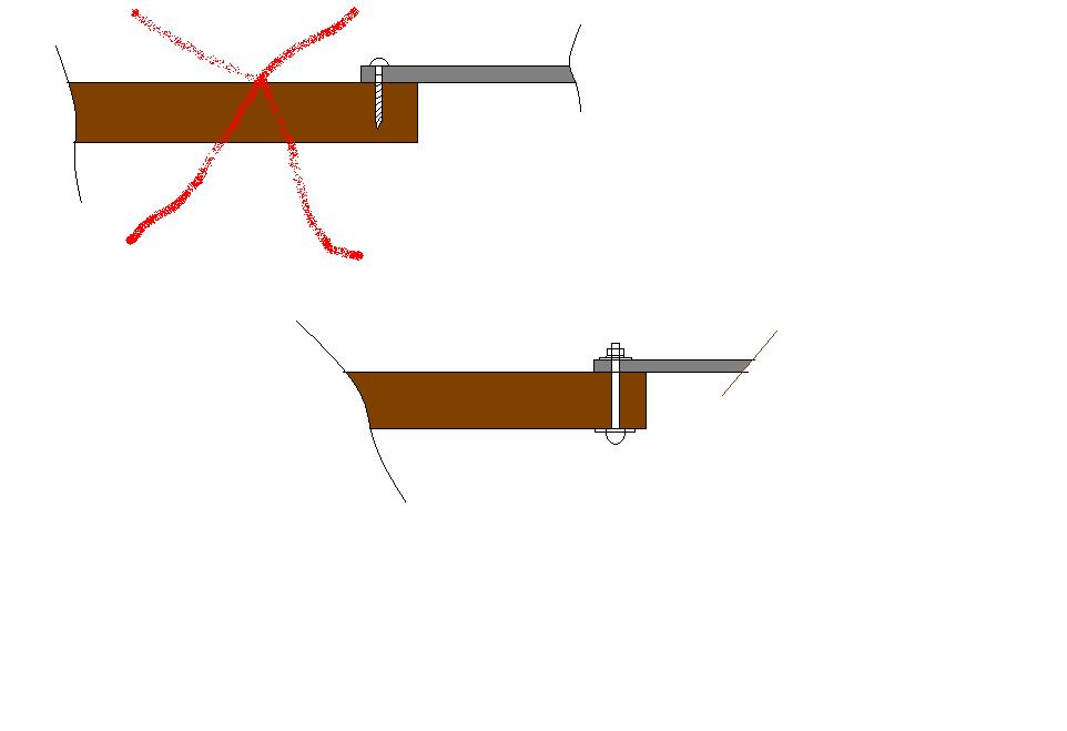

Yes, it needs to be resealed but the attachment mechanism isn't working for you (stripping out)..'long term'........
Depending on the stiffness of the electronics " plate" the silly woodscrews have to go. Use thru-bolts with washers & lockwashers. The overlap of the plate should be enough to use a 1/2 " flat washer (Check how much)...have the flat washer, lockwasher, nut on the outside (Duh!)....drill all the way thru...probably 5/8" MDF wood.
When this is all considered........you might consider doubling the amount of screws (Now thru-bolts). Of course it would require you to drill out new holes in the Plate assy.
_______________________________________________________Rick.......

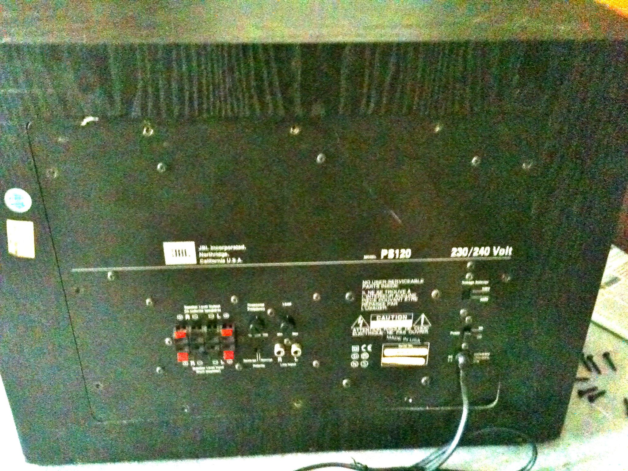

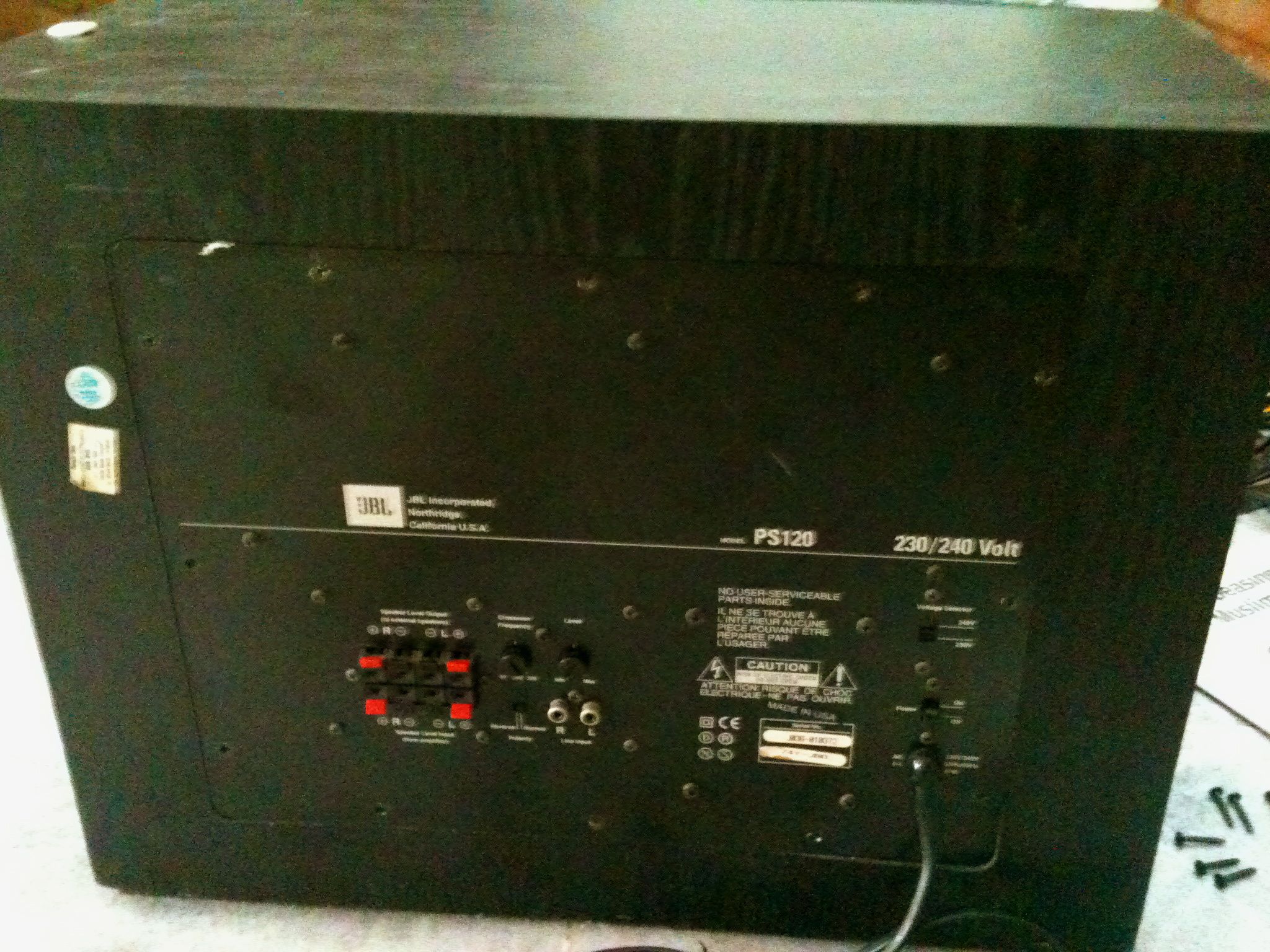

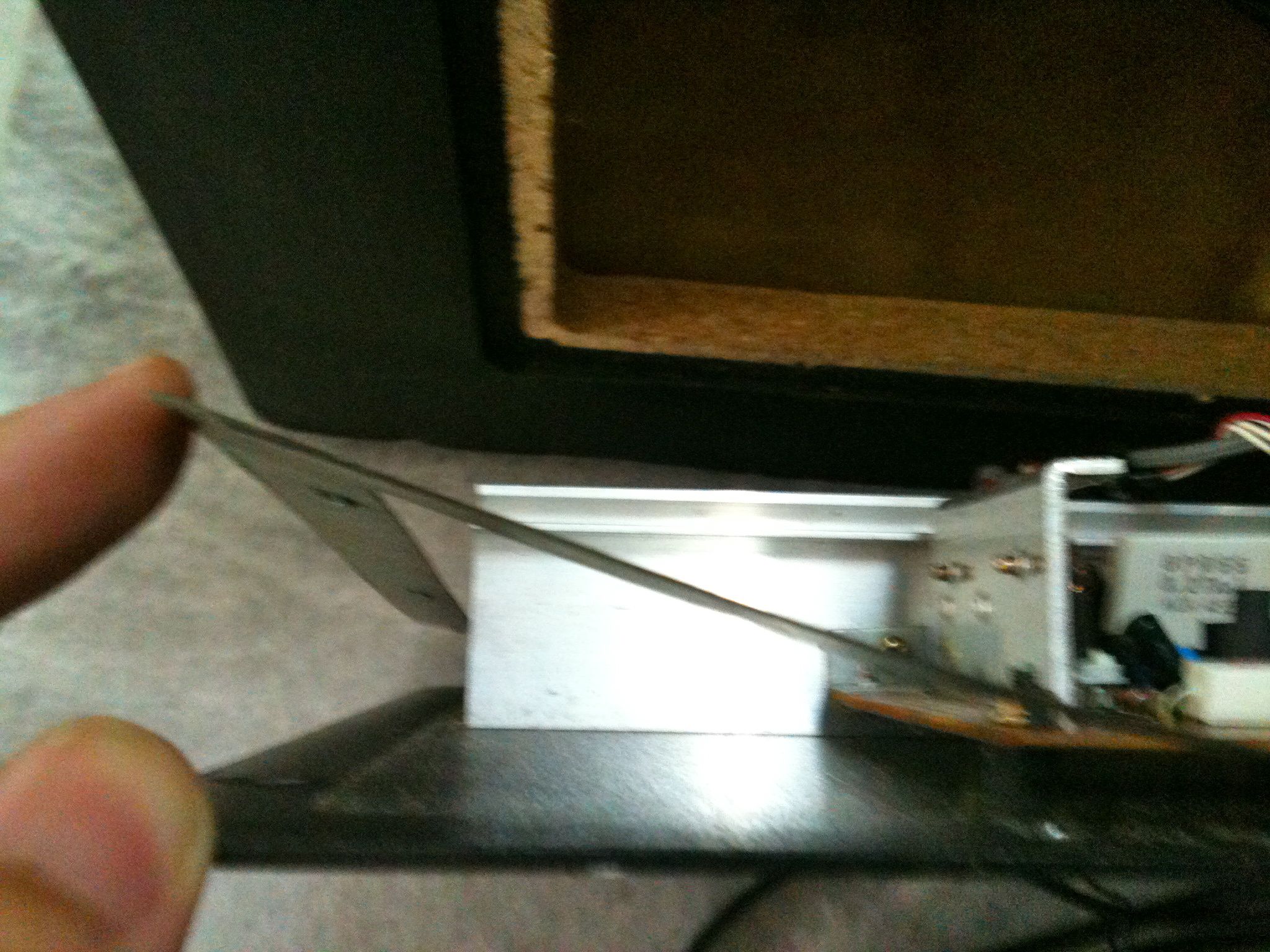

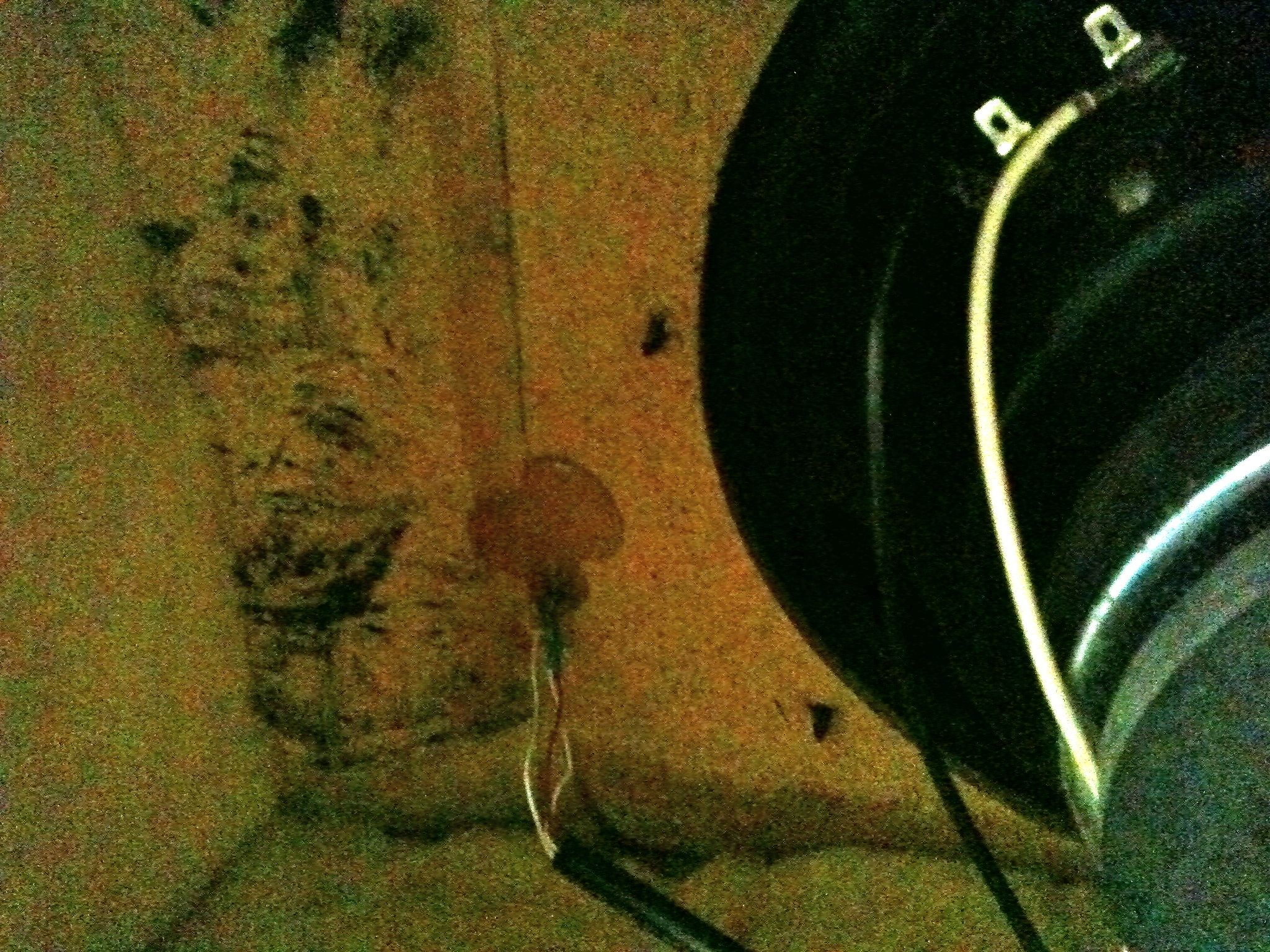

Srry for the above post, my memory just blurring up. The MDF wood is just slightly over than 5/8" ^^ but the screw are originally pass through the MDF wood. (metal 2mm thick, screw longer than 1")
I attached some picture. 1st and 2nd picture is the woofer with back panel attached (mounting screw removed)
3rd picture is the internal near the driver. (taken without any intention though) don't know why there is black paint within the box.
4th is backpanel removed, and there is a thin paper-like material sandwiched between wood and metal.

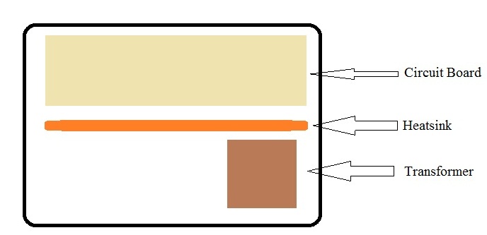

Hm.... I'm had confirmed that this is not cause by flexing alone. But came from parts attached to the backpanel. When I'm going to suppress the vibration using my hand press against the back panel, first its sound increase in pitch ( some pressing force). If apply alot of force, the the vibration is reduce to inaudible state.
However, this also apply to only some area only (not all area at backpanel can be pressed to reduce the noise. I looked inside, it was somewhere around the transformer ^^ I check all (I really mean all & every) securing mechanism (bolts, buts, etc) and they are firm and secure.
The inside layout is as per attached, the effective press-suppressing area is around the transformer and slightly toward the heatsink. The heatsink is attached to the back panel for better heat dissipation using white colour adhesive.
Any idea how and why it producing noises ? most importantly how to suppress ^^
