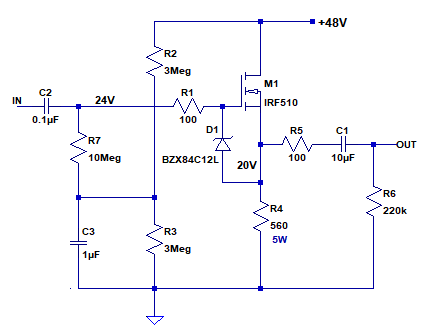

Viable Circuit? (Simple Source Follower using IRF510)

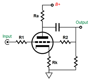

I could make a 'solid state anode follower' out of a DN2535... No sweat. Just like working with a super-tube -- but no heater supply needed (sweet). Use 2:1 ratio for the two feedback resistors (series R input to gate and shunt R drain to gate).
What do you think? I'm sure somebody's tried that. What would be the downsides? Primitive, wasteful and poor performance compared to a good opamp? Or actually won't work in practice?
Well, I hadn't thought of the problem of bandwidth. A DN2540 at low (for it) voltages has too high input capacitance too keep it from having a drooping high frequency response, even with all that NFB around it. LTspice seems to think it will be -3dB at 20kHz if used like an 'anode follower'. So there goes that idea.

Would this be a rational idea?
IRF510 source follower with 'quiet bias', 10mA Ids, LM317 as CCS, 24VDC B+.
