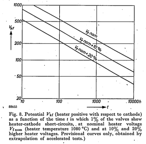

Try finding Rodenhuis, Santing and Van Tol, "The life and reliability of valves", Philips Technical Review, vol. 18 (1956-1957), number 7, pages 181...216, December 1956. It is freely accessible somewhere on the Internet.
On page 188 it is explained that when the heater is positive with respect to the cathode, at spots where the alumina touches the cathode tube, too high voltages lead to electrolysis of the alumina insulation, which releases oxygen, which oxidizes the tungsten, which leads to a path of conductive tungsten oxide through the alumina insulation. When the heater is negative with respect to the cathode, you get a similar reaction, but with the nickel of the cathode tube oxidizing. This latter reaction is slower, which is why valves often have a lower voltage rating with the heater positive than with the heater negative with respect to the cathode.

When you look at post #7, you will see it's a lifetime issue rather than an immediate breakdown issue. The example in the graph can stand 100 V for 10 000 hours at nominal heater temperature or 1000 V for 20 hours at nominal heater temperature, both for 1 % probability of failure.

The post #7 graph is 'for guidance only' (and of the probability trend of a large population - rather than viewing it on a single example basis), as it is based on extrapolation from accelerated testing, and is related to the oxidation and electrolysis mechanism that ends up as a h-k short circuit.
The Philips paper unfortunately does not have data on what happens prior to a particular valve suddenly exhibiting a h-k short circuit, as the test setup only had a sense circuit to indicate when a 'short circuit' occurred. I would anticipate that Rh-k would have reduced over time, but it is uncertain how that would characterise itself given that alumina impurities is the other well known mechanism for Rh-k degradation.
