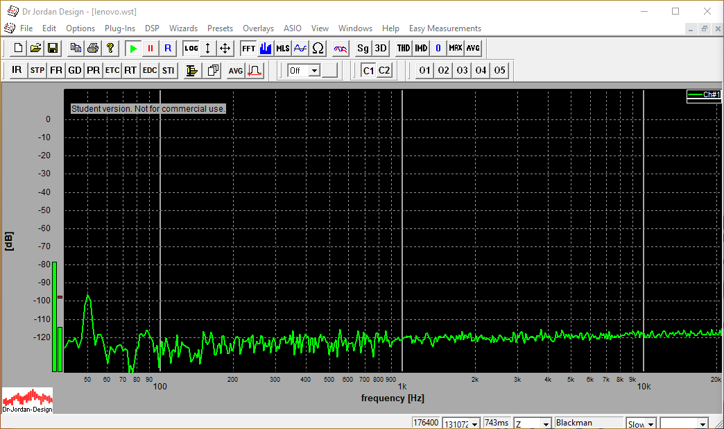

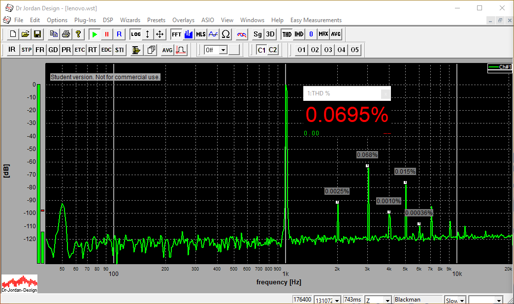

OK, tomorrow I'll try to arrange a filter and measure at 2.83Vrms (that's 1W @ 8 ohm), dividing by "no signal" Vrms measurement.
SNR
OK, guys... it appeared to be not that easy with the gear I have in hand.
My True RMS voltmeter has got the resolution of 100uV and it shows 000.0 mV with no signal at the output.
I switched to the oscilloscope - minimum value it can measure is 80uV, however, it also shows zero. OK, let's take the worst value that would be rounded down to zero - that would be 39uV of the noise signal.
That gives us:
SNR (2.83V) = 97db (1W @ 8 ohm)
SNR (28.3V) = 117db (100W @ 8 ohm)
Then I have connected my audio analyzer and tried to see the spectrums.
The first picture shows the spectrum with the amplifier off.
We see a 50Hz artifact - some kind of a ground loop caused by the way the analyzer is connected to the amplifier.
The second picture is 28.3V RMS output (same measurement scale, I didn't touch any settings) - we see the same artifact a little bit grown up, all the rest is very close to the "off" situation.
That's the best I can do at the moment. Need some uV RMS meter for more precise measurements.

I have no idea about the soundcard performance, plus a high-sensitivity microphone input adds a lot of noise, but we can still see the harmonics profile and the way ODNS suppresses high-order harmonics. This is 25W output @ 8ohm resistive load.
H2 is reduced by 6db; H3, H5 and H7 - by around 15db - resulting in excellent profile with H2 dominance and rather low higher order components.
