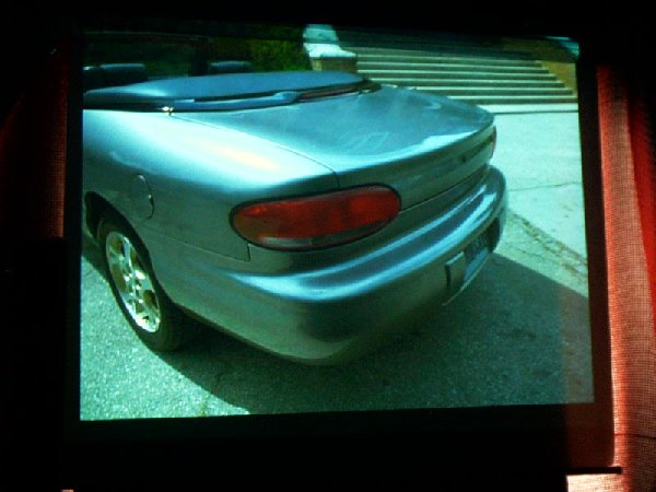

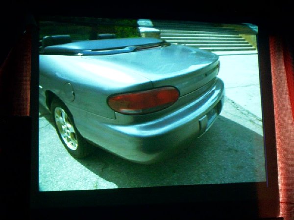

Hmmm well i got it.... The tv quality is definatly better, WAY less fuzzy, but I think the way they did this is jenktastic. It appears that the box just blurs the picture, I will admit for tv this helps a good amount, but for dvd it actually makes it worse. The fuzzyness is gone but the resolution actually appears lower and thats definatly not the results i was going for. I have result pics but i dont think they are acurate, its really only noticable in person. Oh yeah and some of the colors make jaggies on the edges of This wasnt to huge of a problem and went mostly away when i turned the color option of the box down.
ok here is the composite..

so pooh.. are you saying you are dissapointed with the results?.. is it worth the 80 bucks for this thing? Were you using composite from vcr to tvbox then using VGA cable to lcd panel? You cant really judge by the pictures because in my opinion the first pic actually looks better,lol. Im just looking to get a brighter, crisper image, more detailed image(isnt everyone..lol).. mainly brighter, even with all the lights off in my room at night there is significantly a dim picture, especially with movies. And I have a decent setup,.... i think

No, its not worth it. The picture was definatly not crisper. I had it hooked up through composite from vcr. I also tried hooking the cable directy through it but it didnt tune in hbo or showtime so thats a no go.. I will post more results later.. in a few mins...
Ok well im not gonna post more results because im lazy... but i have come to a conclusion. It does infact do a good job at making tv and vhs look better (through composite). I did a direct from composite to my projector and spliced the same line through the external box then to my vcr, and switched back and forth for a couple hours while watching tv. The downside is that some defenition is taken away, but it makes up for it by smoothing the crap out of it and taking practically all of the fuzzyness out. The disney channel in my area is complete fuzzy crap... but this box did help alot while lloyd in space was on.. SOOOO in conclusion (term paper style), If you want a cheap way to make your tv and vhs look a lil better get it, but i dont know if its really 70$ better. But to use it on dvds would be stupid. I think my next step will be making a cheap stand alone pc with a dvd rom drive dedicated to being a kinda htpc.

Yes i am running composite to it then out via vga to the projector. I also tried running the cable cord to it then out through vga. It definatly doesnt double the lines, or i would have noticed better resolution. It just smooths the crap out of it, i especially noticed it with my ps2. Like i said it does help tv but not 70$s worth. Im not sure if im gonna keep it or resell it.
