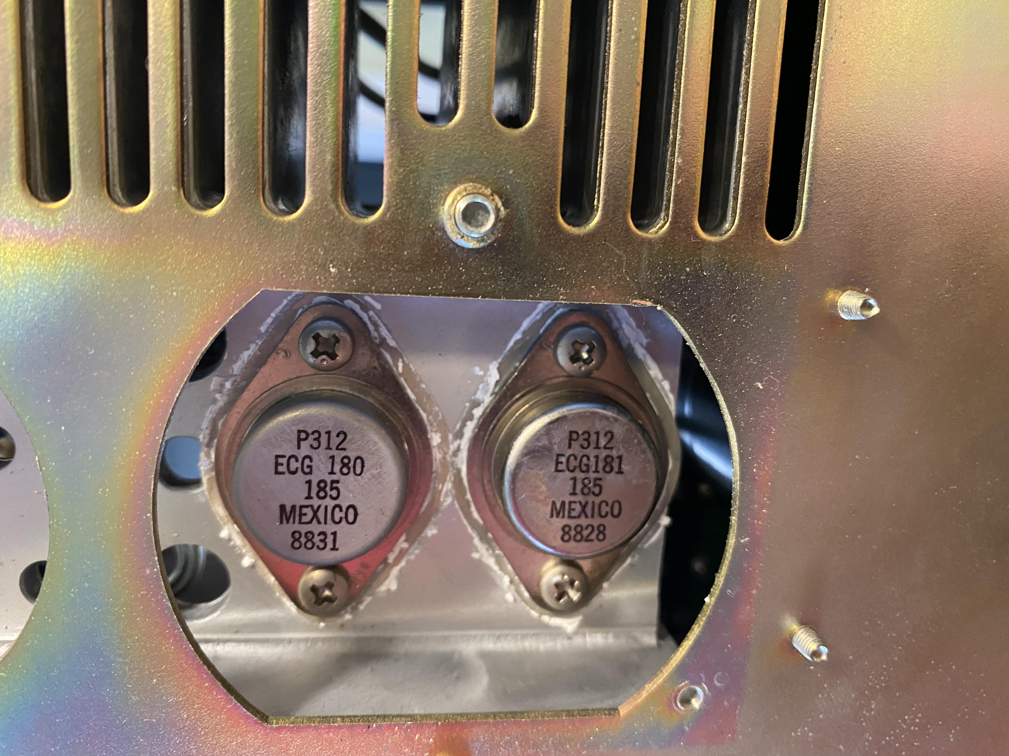

vFET the TA-4650
2 options really,
Return for full refund and travel expenses.
Request hefty discount to compensate for its reduced value.
If you go route 2 then you need to assess if the PA board it functional. Then apply the Dutch service manual updated and suicide diodes replacements. Re cap as needed/desired and replace the vFets ( I believe you have been offered matched replacements, but them in any case for spares if you find another amp).
I have a stock 4650 PA board but the vfet sockets and thermistor are missing. Would be willing to sell at reasonable price if needed.
Good luck with the seller, I think you have him cornered and you are in the right.
Jon
He’s now gone cold on me he won’t even respond to my emails. I’m not sure if I will still take it a massive discount I’m thinking $100 maybe so. I’d rather get my money back or possibly get the small claims court judge to agree that whatever it cost to repair third-party he pays for it.
No I do believe he knows it was altered and modified I think he was hoping to just unload it to an unsuspecting person even pre-sales he said it was OK and are all original I have it in writing from him.
For him to say that my warranty is voided for me opening the hood of my vintage hot rod with matching serial numbers to check the number by opening the hood will voiding the warranty and me finding out that they’re not matching numbers it’s just ludicrous. I’m the fool for not forcing him to show me before I paid and I should’ve never said a thing about them being fake chips and let him just try to fix it which he cannot.
