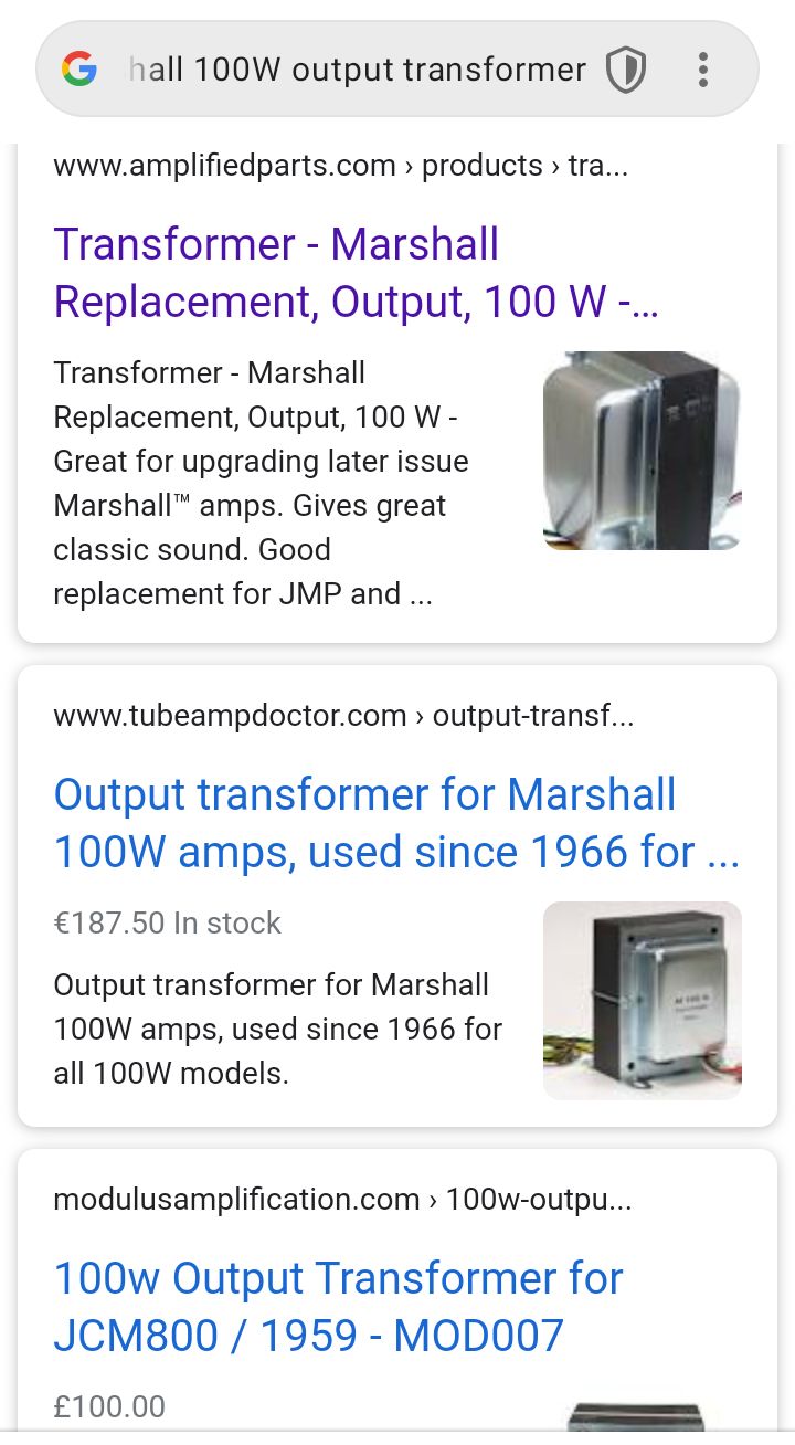

100V supply means 90V peak swing .
200 mA peak current means 180 mA peak swing , in both cases discounting 10V for saturation and losses, and 20mA idle current.
So we have 90V * 0.18= 16.2W peak so meager 8.1 W RMS
You will need an 1800 ohm plate to plate OT, such as:
https://www.amplifiedparts.com/products/transformer-marshall-replacement-output-100-w
1700 ohm P/P , 8 lb weight, U$144 + shipping.
Not sure about others but I'd rather have a custom 8W transformer wound (what KMG did) instead of repurposing a standard Tube OT.
