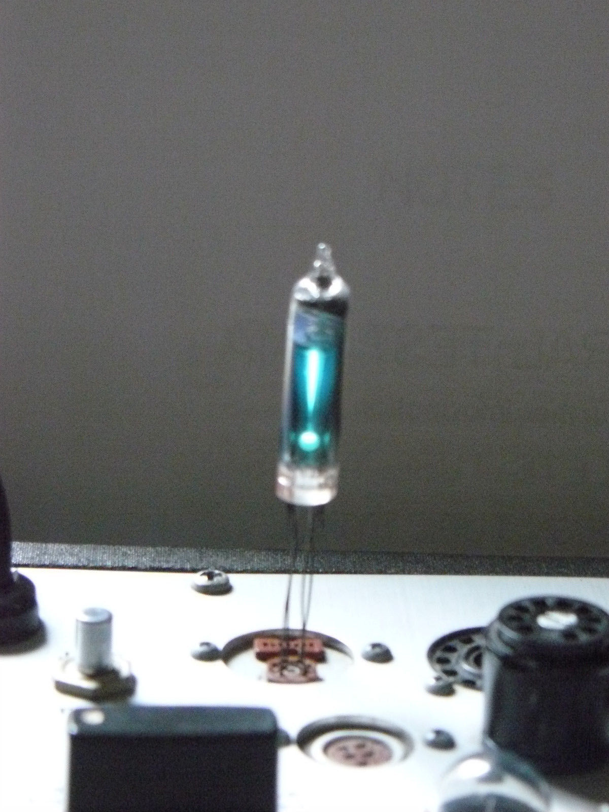

surprisingly a 6922 will amplify with 9v plate voltage
B+ of 40v raised to 140v only increases gain slightly, in this case 16 to 18 times

The Korg Nutube is a redesigned VFD made by Noritake who also makes VFD's.
Ordinary VFD's do work as triode vacuum tubes. They are designed to be off or on, so linearity was never a design criteria.
There are also special purpose vacuum tubes that operate from 12 volts or less, some with thin filaments that run on 1.2 volts at 10 ma. You can't see the glow in these either. Look up the 6418 tube, also the 6088 and 5678.

"To put some numbers into it" here you have a basic triode gain stage built around a Nutube, old style graphic design using the datasheet curves , the way I learnt since 1969 and which was used earlier (no computers or simulation way back then).
trying to maximize gain, peak to peak signal out, use reasonable voltages which can be found inside an SS guitar preamp (no sense plugging this into an amp which already has *real* tubes), I chose:
* idle plate voltage: 11.3V
* bias: +3V (yes, positive grid bias, it´s hard to pull electrons from a filament at such low voltages)
FWIW both B K Butler´s "Real Tube", Mini Boogee and doubtless others also use positive grid bias, to get *some* current at such abysmal low voltages.
"You can´t beat Physics" 🙄
* idle current: 68uA
With the load line I chose, if I apply 1Vpp (swinging from +2V to +4V) signal to grid, I can swing with reasonably good results and a "somewhat" symmetrical signal (sort of) between 84uA/5V and 40uA/20V .
* so stage gain is 15Vpp/2Vpp=7.5X
As a practical comparison: 2 of these stages cascaded can provide same raw gain as a single 12AX7 stage ... which of course will need >160V supply, 6.3V@300mA filament, a socket, etc. so in some very limited situations it might be useful.
* something interesting is that gain is not symmetrical, notice that for a symmetrical +/-1V input swing, output swings +8.7v and -6.3V , an important difference.

Almost forgot 😱 :
* 15V swing with 48uA swing means: 312k plate resistor
* so following load should not be less than 1M, so as not to load it down and lose both gain and output swing.
* since grids are positive biased, they must be pulling *some* current so input impedance can´t be high, so when cascading Nutubes, intermediate buffers are advisable.
* you need at least +32.5V supply (when plate reaches +20V peak, you still have 40uA through that 312k resistor, so you need extra 12.5V)
Ok, so now you have some numbers to decide whether Nutubes are worth it or not.
* almost forgot the last NUMBER: U$50 each 😱
