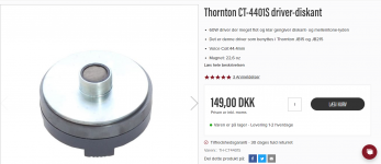

This one is threaded. 1,3/8" i think. 44mm Diaphragm. No usefull datasheet. 150 danish is 20Eu, but the same range of drivers goes down to 11Eu with similar build-style.
Does all threaded drivers count as "long" and require a long horn.
Kind regards TroelsM
