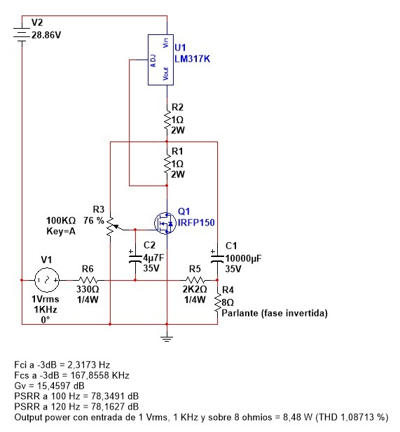

If you consider two separate PSU for low and high voltage is that parts count. What if you drive the first stage from a voltage doubler instead, then the bootstrap does not even needed or the second PSU.
Second thing I will do is replace bottom FET with LM317 in constant current mode, only one resistor and LM317, lower parts count even more.
One more resistor and one TO-92. Problem with the LM317 is the dropout voltage. It needs that to stay in constant current, too. With a 15 volt supply you can ill afford to lose another two volts. Losing one vbe plus Rds(on)*Idq is a little more palatable. And if the FETs are already on hand and the 317 isn’t, it a no brainer which to use,
Okay did not realize that you did not have a LM317 on hand. Why would the same drop over the LM317 than across the FET be troublesome, it is what you need. Why not run the whole thing off 30V you have it available.
May I suggest a circuit like:
Source: https://www.diyaudio.com/community/threads/hybrid-zen-amplifier-lm317-efficient-and-simple.402477/

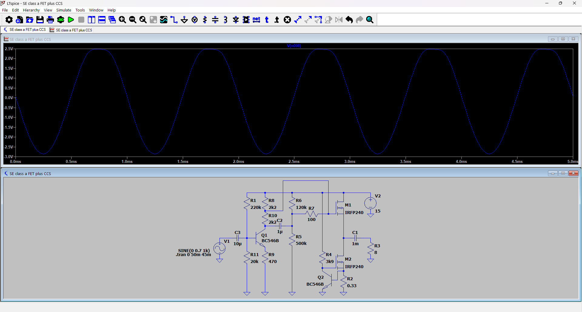

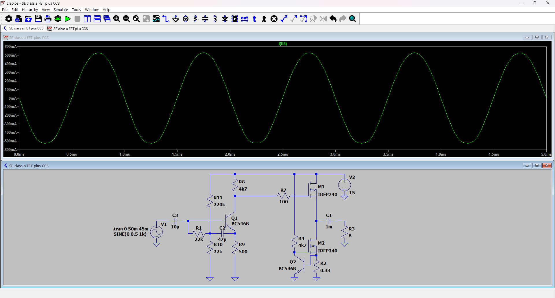

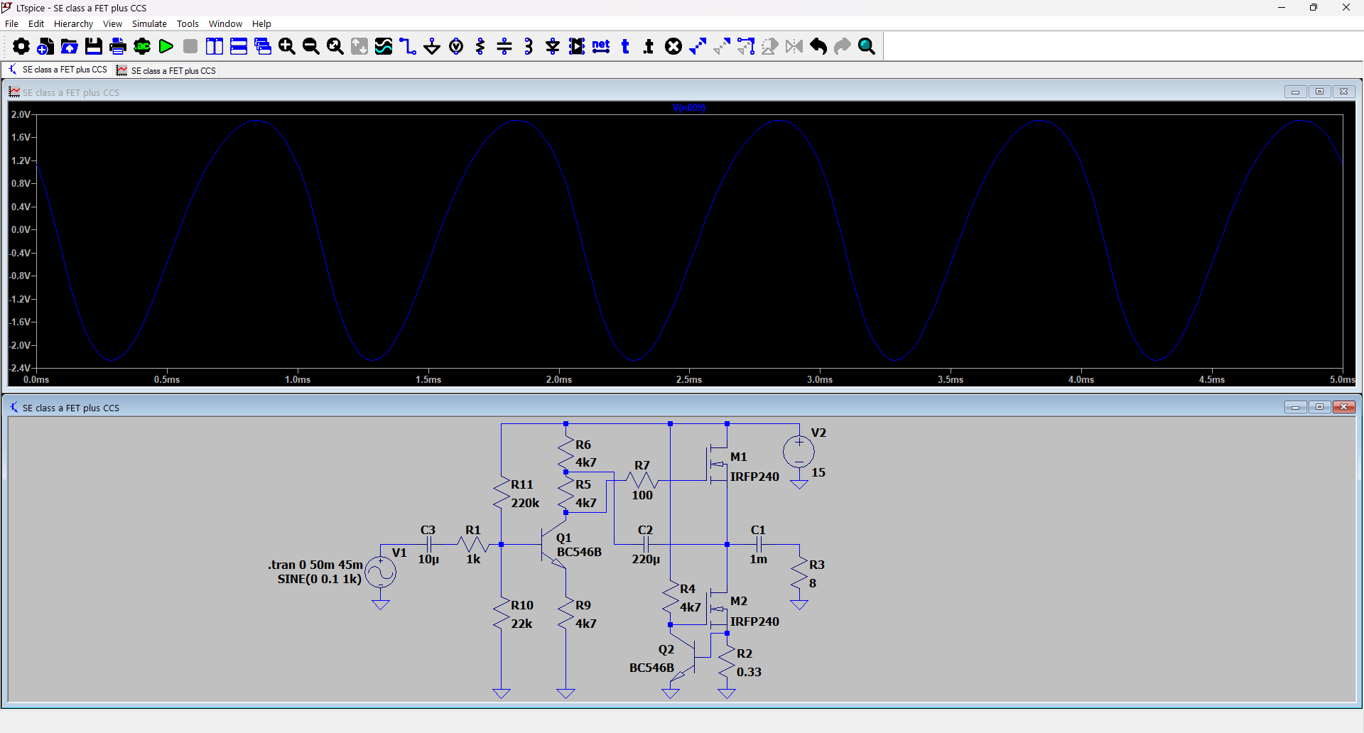

That’s not it. You’ve added a mild amount of negative feedback, that’s all. Boot strap goes to the collector load of Q1, and you need to direct couple into the gate. Once you do that, adding NFB from output to the base of Q1 might be a good idea, to bring the gain back down and linearize it.
is that what you meant by "direct couple into the gate"? it seems to have the reverse efect
i made something that makes tolerable results and if my result is tolerable that means someone smarter than me could make it into good.
the whole point of this modification is getting rid of the capacitor that connected the two stages togheter.
i first one to simulate a thing that works the best and then make it in real life.

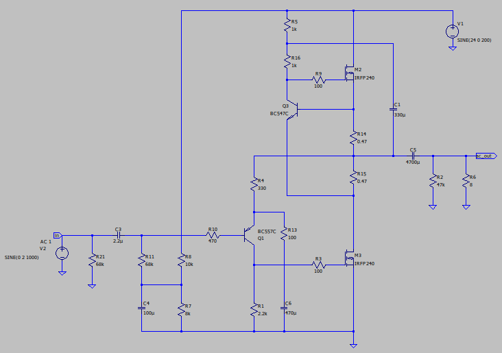

It's a trap. How do these different types of distortion compare in real life?:
1) A 'raw' BC546 gain stage with no constant current source, with high voltage swings so it has lots of modulation, connected to a MOSFET follower.
2) With the BC546 connected to the lower MOSFET (common source), so its collector voltage modulation is 20-30x less, but/and the MOSFET is now a gain stage. Feedback could be used to reduce the total gain, or
3) connect the BC546 as a follower. Something also has to be done with the upper MOSFET. It could be reconfigured as a CCS and it's probably easier to use a P-channel for that.
More ideas:
Could a PTC thermistor be used in a resistor divider network controlling the gate voltage of the MOSFET CCS? So if the MOSFET gets hot, reduced gate voltage compensates the reduced on-resistance of the IRF.
almost you can see some cutting on the bottom. i also realised i have way too much of these "40321" transistors laying around.
so here comes my millionth amplifier project
No, what I meant was what you did in #34. Then split R8, and boot strap back to the output. That will give you the largest possible output of anything you’ve tried so far, and all off a single 15 volt supply. To get the most gate drive possible, make the upper half a diode (1N4148). That could however, add audible artifacts that two resistors won’t, and a maximum drain current of say 4A (2X IdQ) you only need about 3 or 4 volts above the source to fully turn the FET on. At higher currents you might want more, but not here.is that what you meant by "direct couple into the gate"? it seems to have the reverse efect
i could also increase the voltage to 18V or 17V and make r2 biggger, the transformer i have will output a voltage slightly above 15V after rectification.
sorry for being mean/gen but it almost worksNo, what I meant was what you did in #34. Then split R8, and boot strap back to the output. That will give you the largest possible output of anything you’ve tried so far, and all off a single 15 volt supply. To get the most gate drive possible, make the upper half a diode (1N4148). That could however, add audible artifacts that two resistors won’t, and a maximum drain current of say 4A (2X IdQ) you only need about 3 or 4 volts above the source to fully turn the FET on. At higher currents you might want more, but not here.
