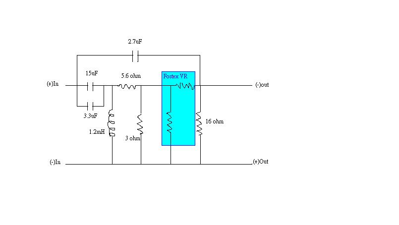

Very strange HP Passive network for TAD 4001
The following High-Pass passive network for TAD 4001 use a 2.7uF capacitor. Any one know the effects of this capacitor? Thanks in advance.
