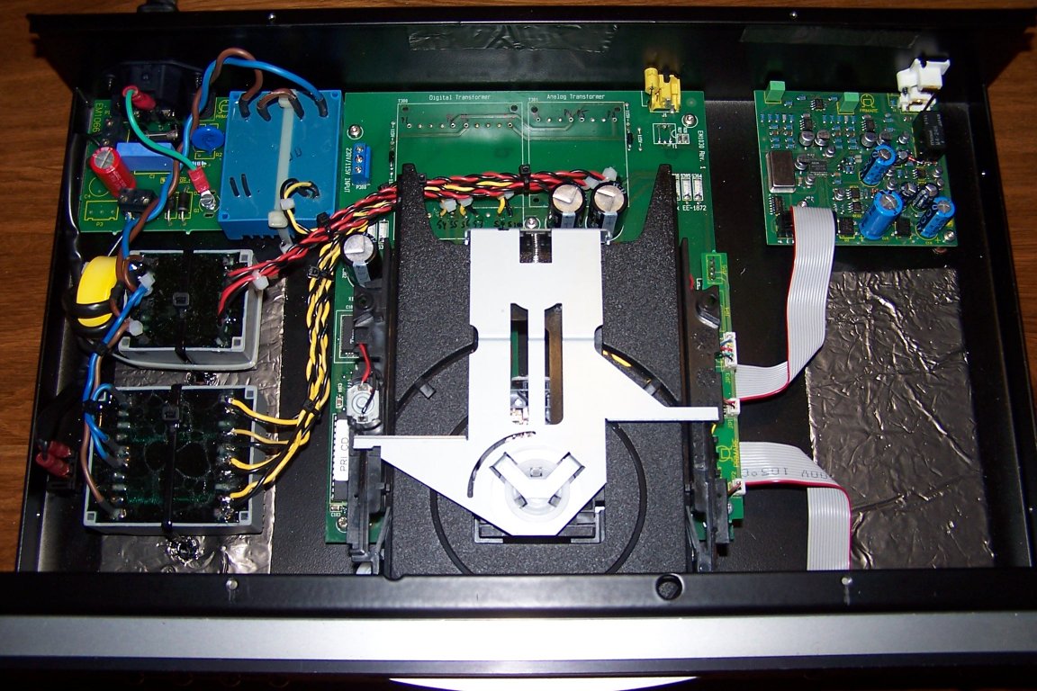

It seems that one of the pins of the pcb-transformer for the analogue circuits isn't making contact with the windings properly. It's a 4x 7.5 V transformer of which 1x 7.5 V is used seperately for the DAC and the remaining three in series for the analogue power supply. Repair of the transformer itself is impossible, it is a pcb-type which is sealed with resin.
It's the winding that feeds both VRs for the DAC that seems to make intermittent contact. I found out by chance when I touched the wires (transformers were originally pcb-mounted, see earlier in this thread). Then I measured the several windings and found that one of them varied with pressure applied to the pins. This most likely also happened when in normal use as a result of expanding/shrinking due to heating/cooling. When that voltage dropped below the threshold of the VRs min Vin, that would have led to no regulation and as a result a DAC that would start spit out white noise until a reset.

I finally fixed the D20 by adding a transformer from a scrapped pcb I took home from work.
After a night on the lab PSU it kept working flawlessly, so I decided to finalize the repair. Going through the scrapped pcbs I was lucky to find one with suitable voltage. The somewhat higher voltage of this transfo meant upgrading one elco on the analogue pcb to a higher voltage (was 10 V). Luckily I had one of the same capacity and lead spacing of 35 V lying around.
I quoted Mooly's first reply as the combination of logic lockup caused by a faulty power supply was indeed the case (albeit caused by a somewhat less common fault). Finally fixed...
