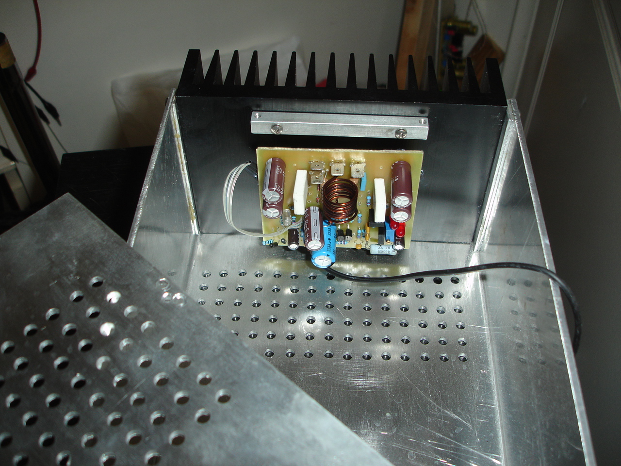

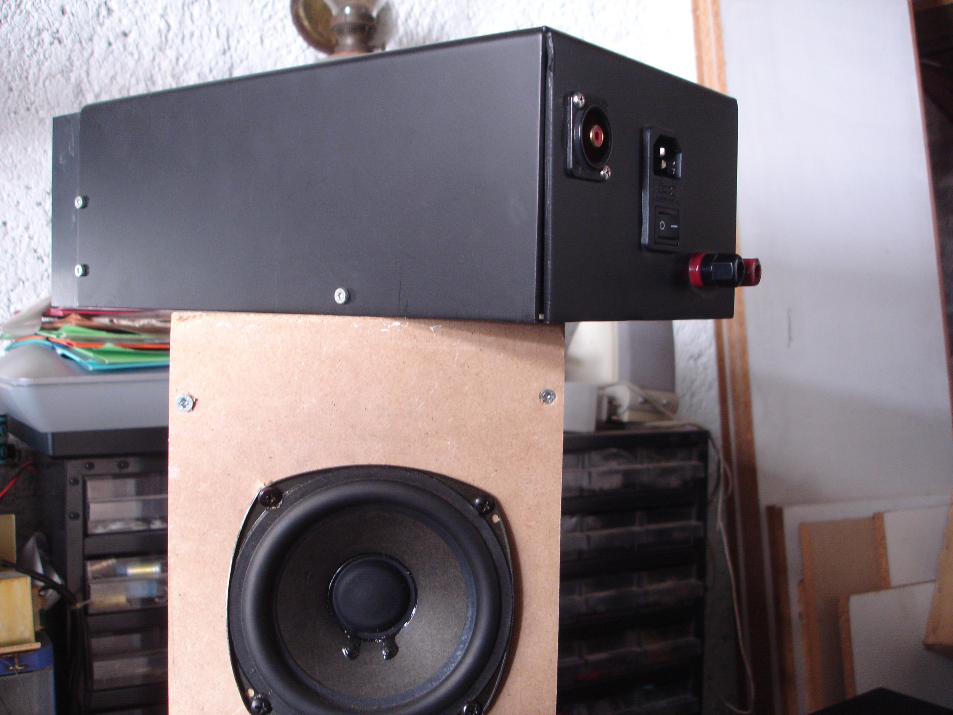

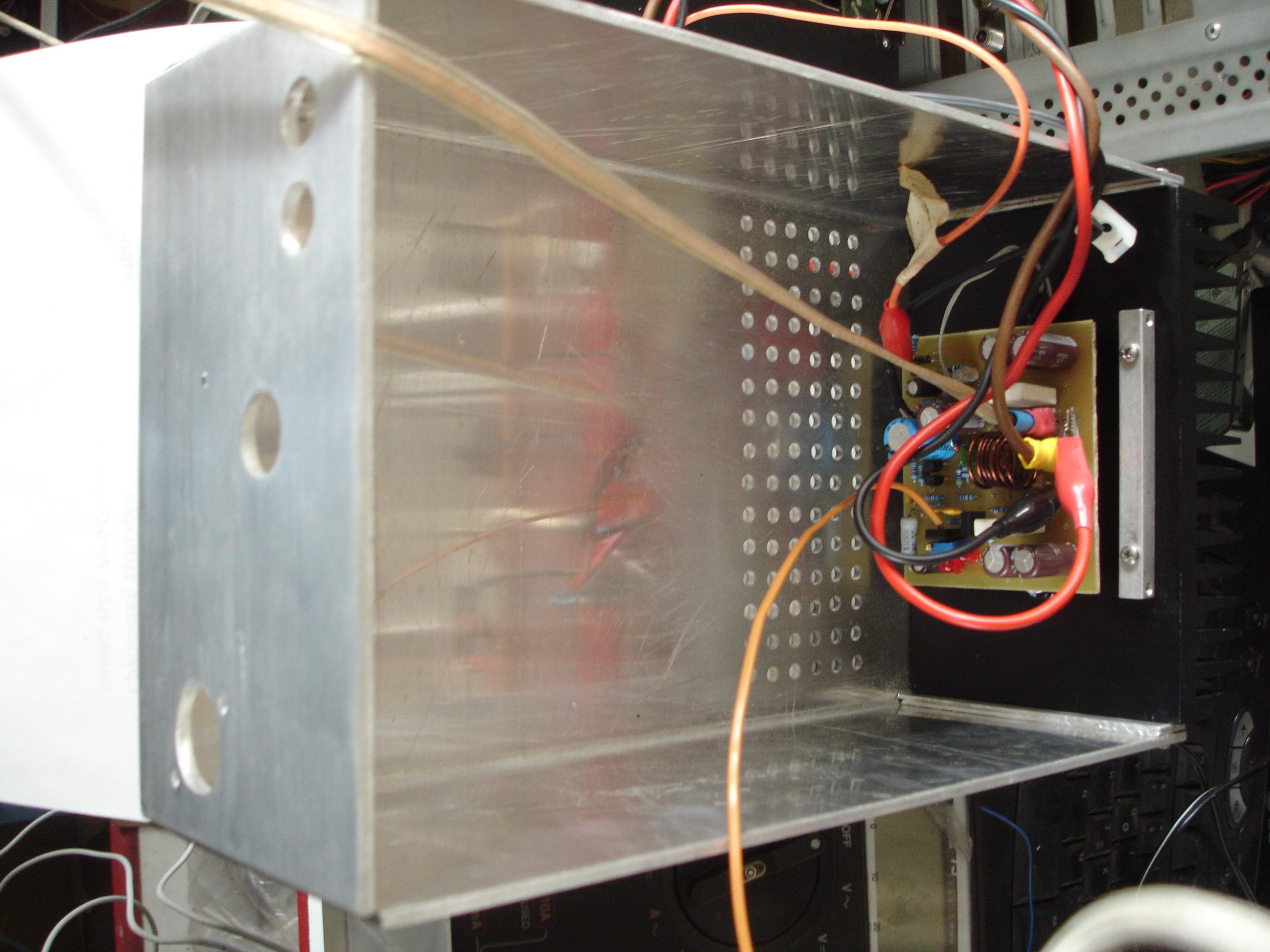

Preparing two cheap monoblocks.
Wow!, so you are gonna put them in cabinet, you must be really impressed with this amp then. You may say cheap monoblocks, but looks really impressive🙂.

Thanks Prasi,i will try to finish this.

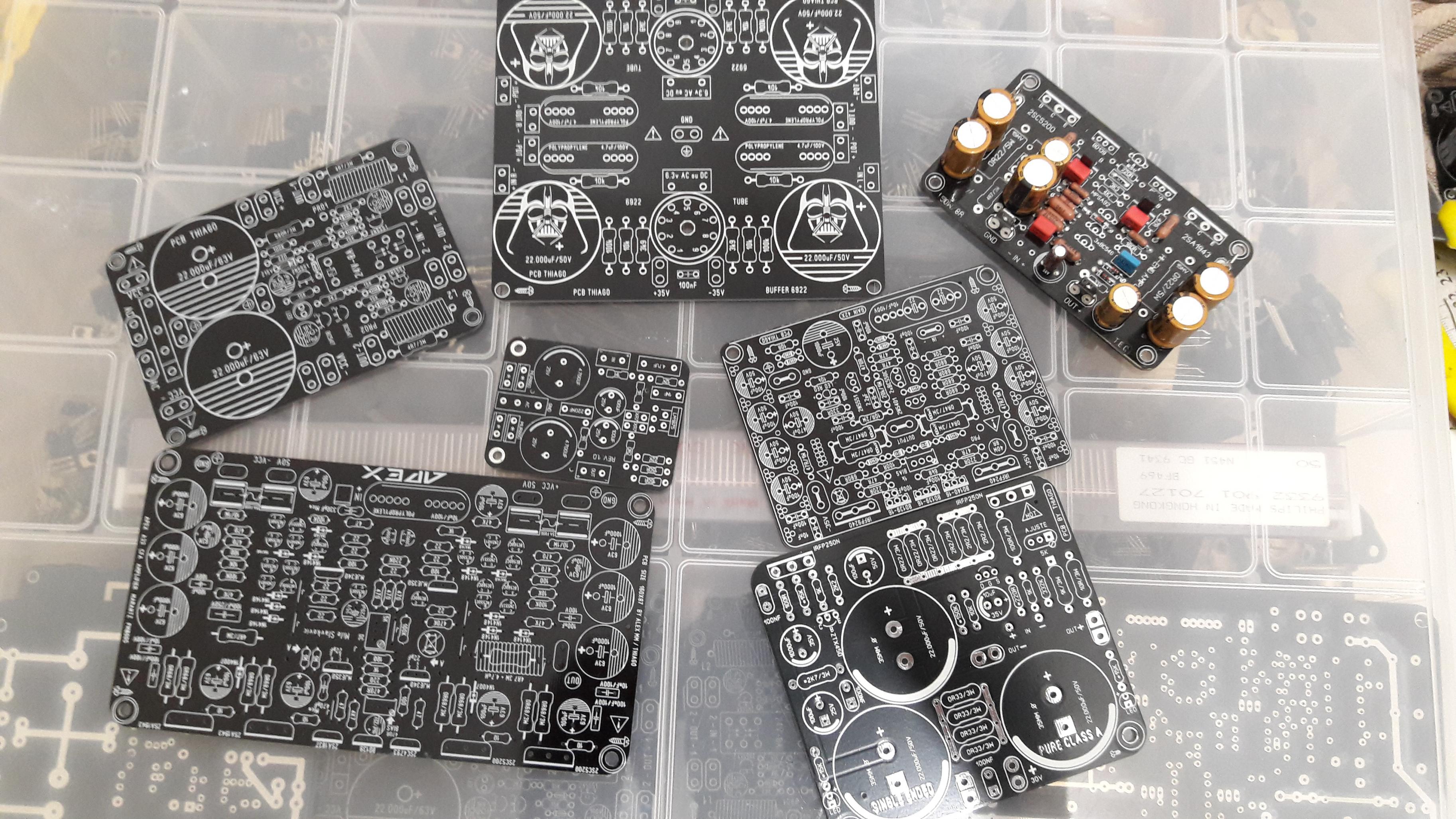

Hi Thiago,i see your layout.Very good Thimios
Regards
Nice work!
If this is your first try ,i can't believe
what you can do in the future.
Regards
Nice work!
If this is your first try ,i can't belive
what you will do in the future.
Nice work!
thank you. one of the first , most already designed some PCB .
