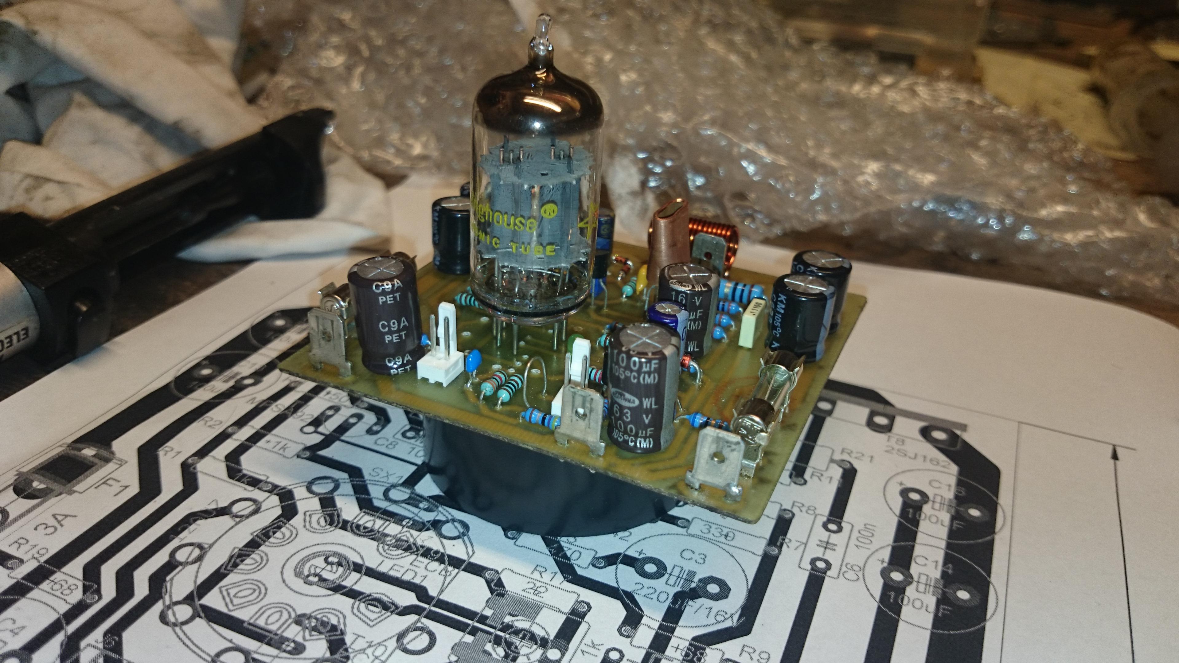

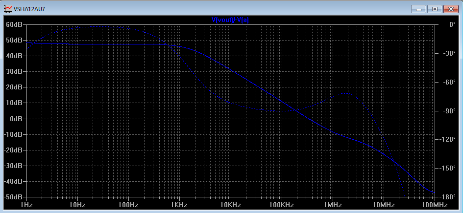

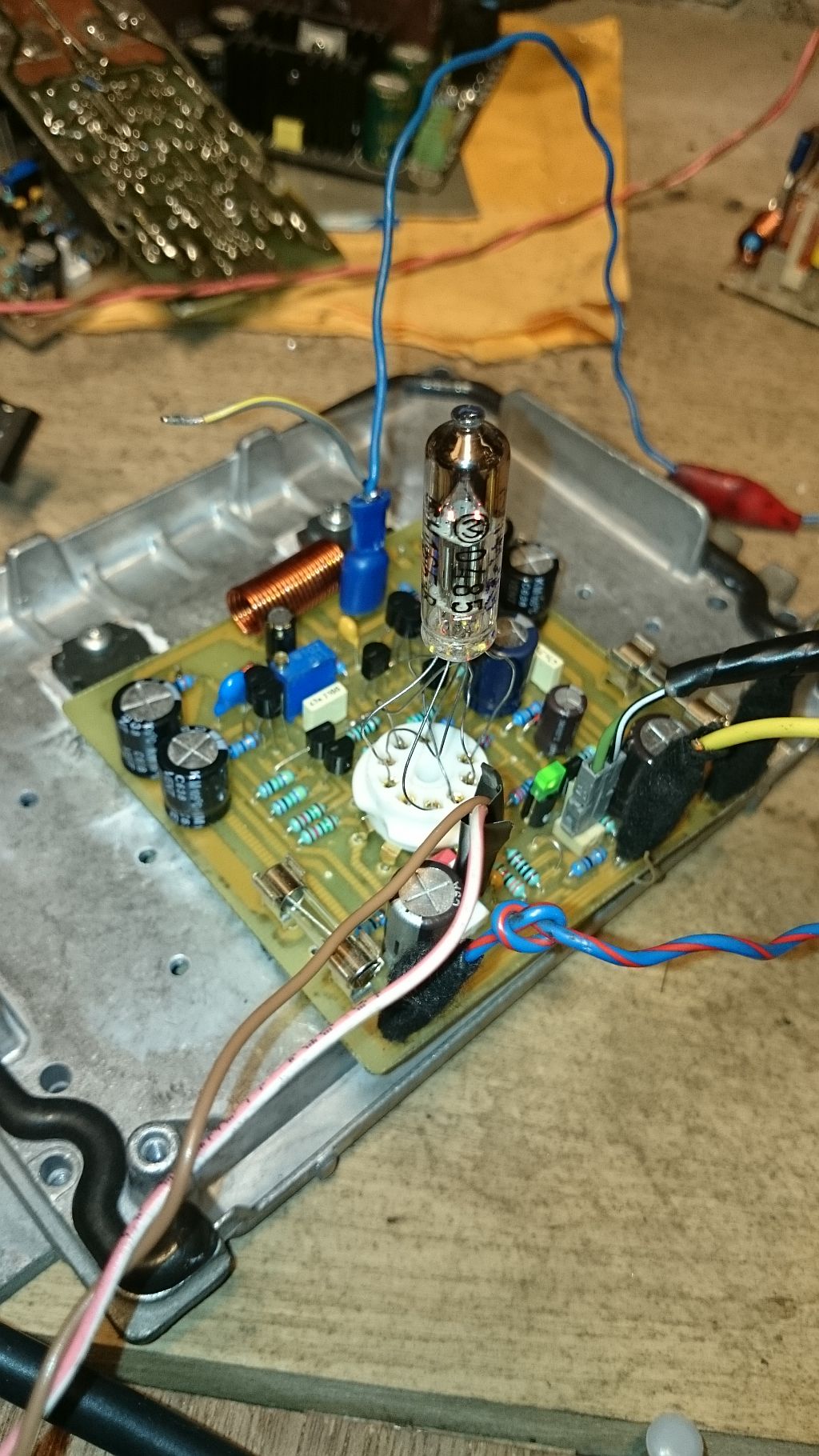

Inspired by few recent projects I have decided to try a very simple/basic hybrid to stard with.
I like the Hitachi VAS sound so why not to stick a triode input in front of it ?
I have never worked on the vacuum tubes before so I would be very gratefull if someone can guide me to the right dirrection and give me some advice.
I have supplied the amp from 2x30Vac transformer PSU unit, the heater is supplied temporrary from the lab psu. The thd figures arent great but the amp sound suprisingly good, I was really blown away at the first time I hooked it up to the speakers (or maybe I was too excited).
I am going to build another version with another LTP stage, so I would be able to set the triode ''working point'' in more correct way.
The animal:
-input 12AU7 --> biased at 1.7mA total (two triodes), the cathodes are at +1,8V, the anode load resistors are only 3.3k (prapobly it is wrong but with the simple/education version it must be at that point)
-VAS --> Hitachi biased at 9-10mA total, looks that 5mA is enough to drive correctly the pair of renesas mosfets.
-output --> lateral mosfets from Renesas

How do you plan to solve the startup issue? I guess heater supply first, then delayed supply rails + muting for the output?
You may find better results referencing the heater to the positive rail. Also since the VAS is balanced you may be able to side step start delays etc. by simply placing a large value resistor from plate to cathode of each tube.
jerluwoo
Thanks for advice !!
After I have referenced the DC12.6v heater to ground, the amp is dead quied with no signal. Tell me please around 220k around cathode and plate would be ok ?
Automatic amplifier turn on --> I was going to use triode ccs resistor 3.3k, when vacuum tubes start to consume the bias current the voltage drop across it will reach approx 5.5V and then the speaker relay will turn on, but first I must finish the amp.

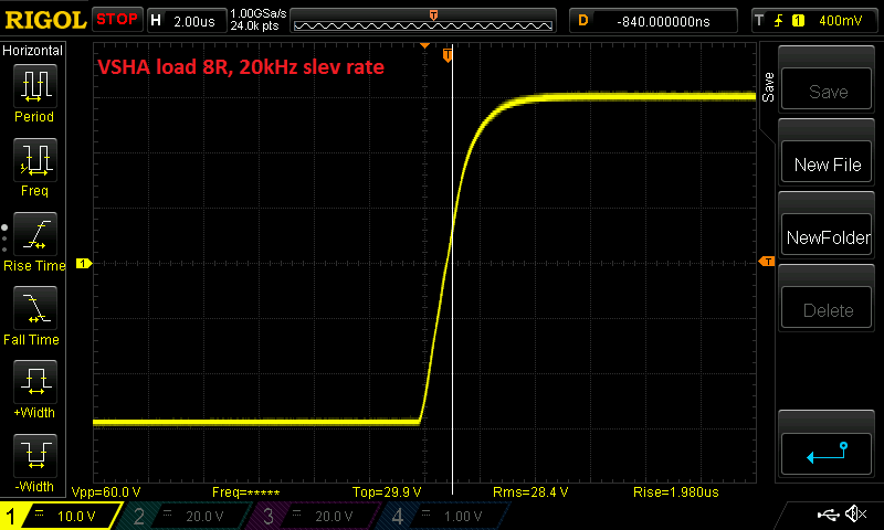

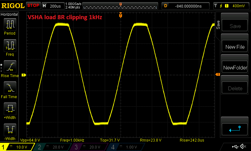

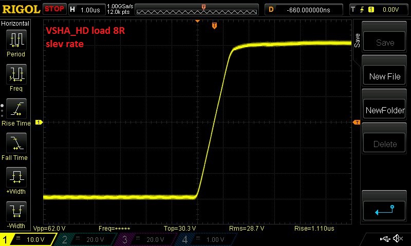

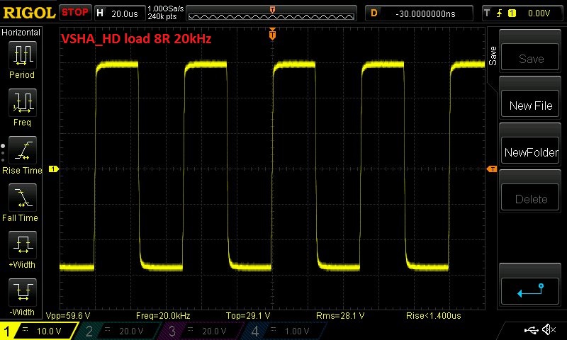

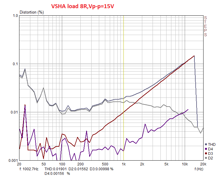

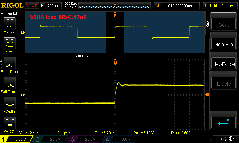

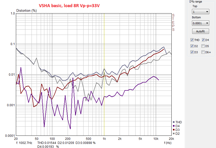

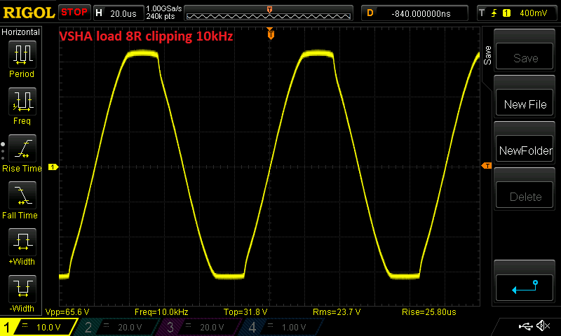

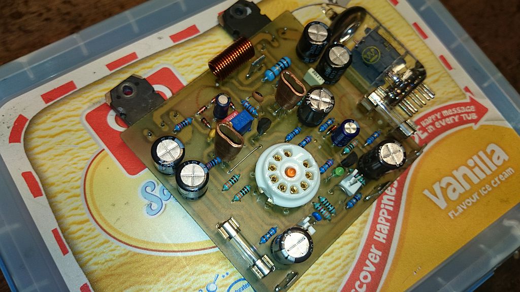

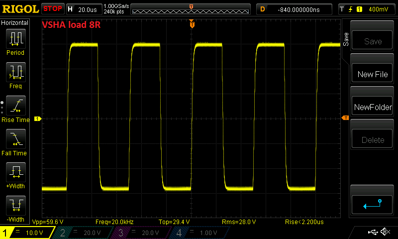

The HD version is working now. There is hidden diode in the tube socket to make them look nicer 😛

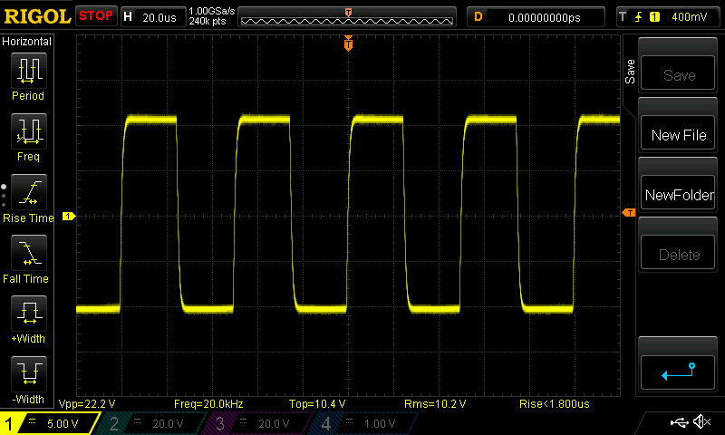

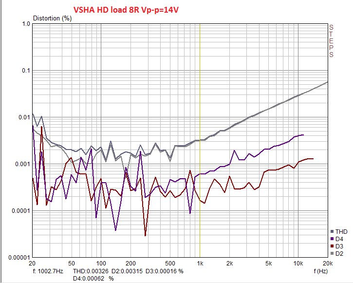

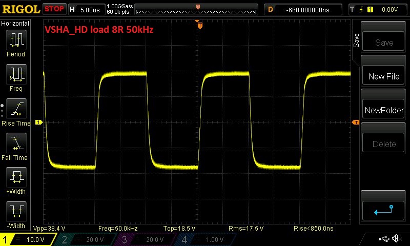

The quick home made measurements bellow, the amp is stable, there is no oscillations present when the tube heater and main psu are powered at the same time, only DC is going bit up/down until the NFB is starting to work (heater takes around 5-8s to heat up the tube).
Unfortunatly I have pulse regulated psu for the heater so there are small artefacts present at the output (with good filtered supply all is OK).
Now there is some time for the listening tests of both versions.
Suprisingly the different tube gives a bit different sound signature.

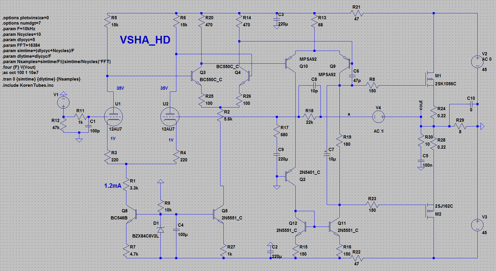

I'm curious, what is the difference between the HD version and initial one on terms of schematic?

Bellow both schematics. On the HD version I have added another LTP so I can set the tube working point in any way I need, there is quite a lot of gaian availible.

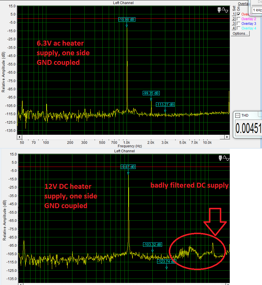

I have decided to use 6.3V ac heater instead DC. There is absolutley no hum at the output. With poor DC filtered heater supply (in my case pulse regulated) I had some visible artefacts at FFT. Sound is really nice.
I am going to test few more improvements.
I am surprised that 12ua7a tube is doing so good job at so low anode voltage, it will be hard to beat it by other tubes.
