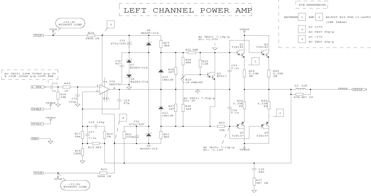

Very simple class B amplifier

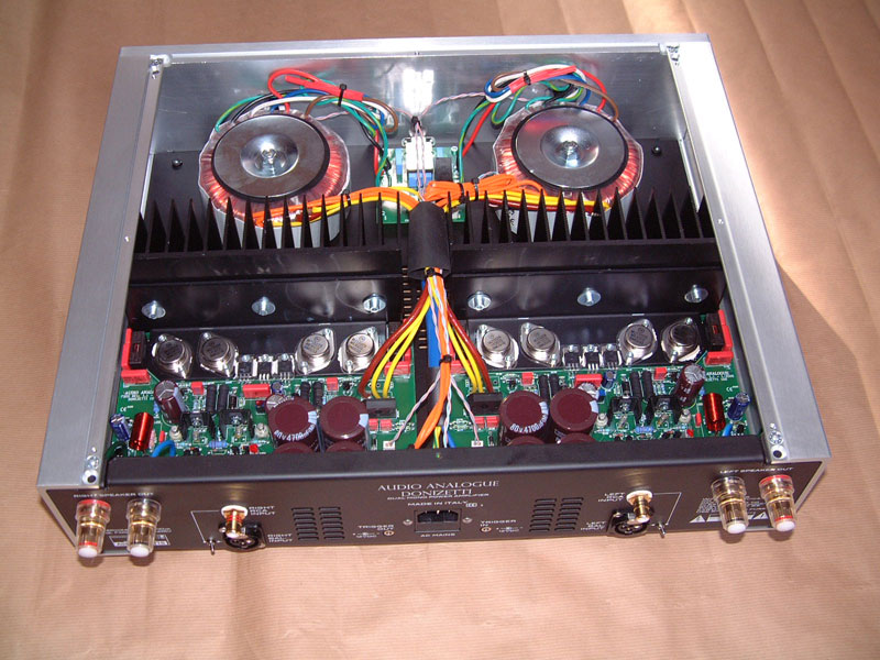

If you really want an opamp in there, but more voltage swing, try bootstrapping it. See the Audio Analogue Puccini/Donizetti power amp design for a good example
Where have you discocer the schematic?

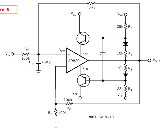

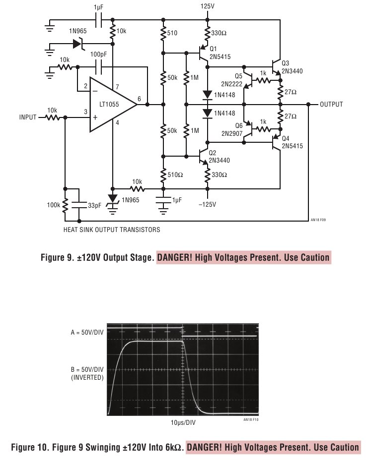

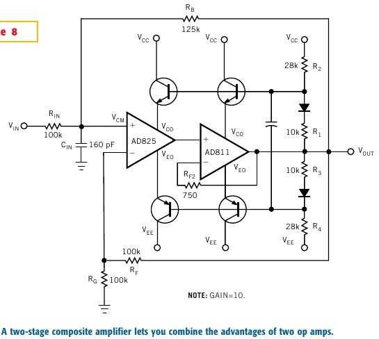

Thanks for the input. A bit of search engine surfing turned up the original article that served as inspiration for the Audio Analogue guys.
This document explains the technique in a very detailed way.
http://www.pi.infn.it/~federico/Immagini/bootstrap.pdf[SIZE=+1]
[/SIZE]For those too impatient to read the article, here is what they came up with:[SIZE=+1]
[/SIZE]
Thanks Ing,
I have seen the "design idea" used in many opamp driven power amps and have seen comment on why it is needed for the higher voltage rails.
That is the first time I have seen an explanation of why the circuit is necessary and a detailed what the circuit does and how to ensure you get out of it what is needed.
Thanks again for searching.

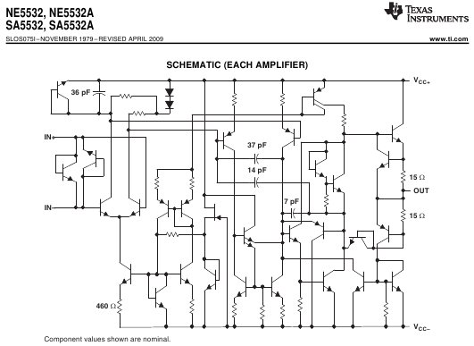

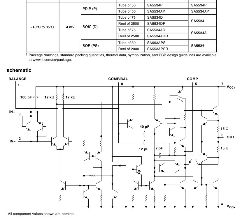

An external capacitor gives you a lot more scope. Just for that freedom of choice that I would vote for the NE5534.
If you look at the internal circuits, they are very similar but there are a few small differences between them.
Would be more accurate to compare them within a single manufacturer.
The first sch is from TI and the second one from Phillips and it s likely
that they use these schematics even for the other variant.
