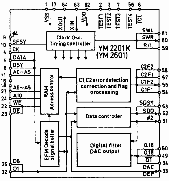

The converter is a single BB PCM53 JP-V (I figure out it is the converter…PCM….).

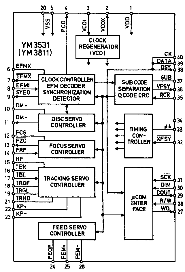

There are also two Yamaha Chips, YM3531 and YM2201F, which, I guess, could have to do with data stream.
Unfortunately, despite searching the web, I couldn't find any datasheet or similar of the above mentioned chips. Also, I was not able to get a service manual for the NEC CD-Player.
Following questions:
- Does anyone know these chips and could give me some more information about?
- Does anyone have more information abour this CD-Player? Perhaps the original player was another one, it was only badged NEC?
- Are there other possibilities to figure out the data stream from drive to the converter, even without any documentation?

PCM53: 16 bit single channel with parallel inputs. So if there is only one they use it for both channels with a left/right switch after it. It needs three supplies (+5,+15,-15).
According to one list i have it is an current output dac, according to another list the output range is only specified in voltage (10V)
So you need drastic measures to get it to work with other dacs, therefore you need the datasheets of the yam chips

Got interested and googled. Two hits (no whack..)
Clicked and no problem viewing/downloading (?)
Anyway, page 16 shows oversampling technique using yam lsi.
ym2201 to pcm53 including the switching (2201 takes care of that). No pin numbers with the 2201, but with some re-engineering it must be possible to figure them out.
But it wont help much, one dac and swithing l/r is
Maybe you can start promoting the magnificant sound of this setup 😱 Then we'll all be modding our dacs again to go to mono and switching 😀 😀 😀 😀

James, and all others, thanks for the support! I am amazed how far one can get with the help of this forum.
Yes, Guido, this may be the mod of the year, mono and switching 😀 😀
From the block diagram, it seems that the YM3531 is the controller for the drive. Maybe the data it sends to the YM2201 has sort of a standard format 😕
Analyzing the data streams would be helpful, what do you think?Unfortunately I dont have a logic analyzer
I will not touch the 3531, but the way to go is to get rid of 2201, PCM53 and output stage, from that what I learned now.
