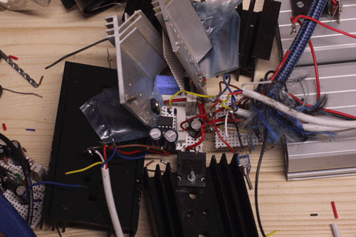

I have just rebuilt one of these with some modifications:
I have changed the LM4562 for a LM49860 and cranked up the voltage to 21V.
The free-running amp of the LME49860 has been wired as a 10x gain amp with its input tied to ground to be sure it does not interfere with the working one.
The power transistor has been changed from a MJL4281A to a FJL4315 which is cheaper and faster, with lower gate capacitance. The amp uses three output transistors biased at a total current of 3.5A, choosen so to give 30W on 6Ohms monitor audio loudspeakers, these have 90 dB/W sensitivity and go much louder than i listen to so i've made one of the current sinks swichable.
The driver has been changed from a faster MJE15034 to 2SC3503. I know it's having a hard time.
The opamp is now powered from a different power supply.
Parts are of the highest quality one can buy in a conventional online store (Digikey), no rare parts from audio-specific boutique vendors. The increase in parts cost is completely masked by the outrageous price of transformers, capacitors and heatsinks.
The amp uses a zobel network. An output inductor also helps getting cleaner scope images (I belive my scope injects garbage into the circuits because they suddenly become noisy when i touch them with the probes, even at 10x magnification.
The amp is plain beautiful. Noiseless, oscillationless. It's not a tube amp but it's not as cruel to bad records as other opamp-based amps are. For these occasions it's never bad to have a tube preamp, but i prefer to switch it off when i listen to good records.
I attach a picture of it.
